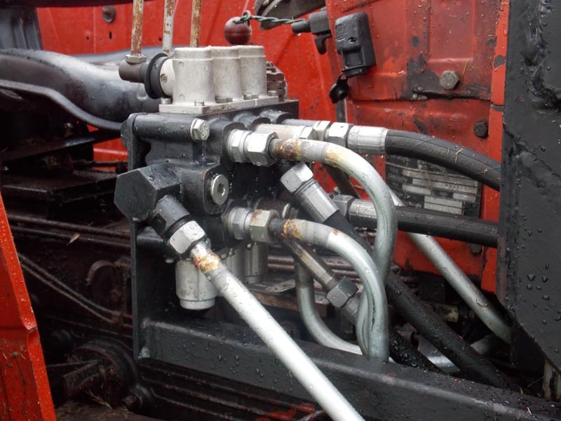

I don't know how your tractor is set up; I have an older (1985) Italian tractor with a modest hydraulic system that I upgraded a lot.
To run the front loader and more, I added a 3-circuit valve block by diverting the flow pipe between the pump and the factory auxiliary block behind the seat.
This works really well.
The drain-to-tank port just runs from the new valve block to the pressure inlet of the old one, and from there it goes to the 3-point lift.
I also replaced the pump with a larger flow one, and added a priority flow valve to reduce back pressure through the restrictive factory valves (which weren't even adequate for the stock pump).
All this didn't cost a lot; a few hundred bucks for the parts. I made some adaptors and fittings myself.
