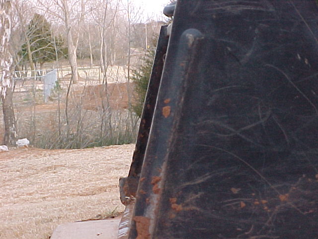

In case my "sighting" description is confusing, here is a picture of what I mean. The sighting is across the front edge of the bucket sides. The bucket looks pretty good right now. The edges are close to parallel. As I move my head to bring the edges closer together, it is easy to tell that the bucket still has 1/4" or so of twist. It was much worse.
OkieG

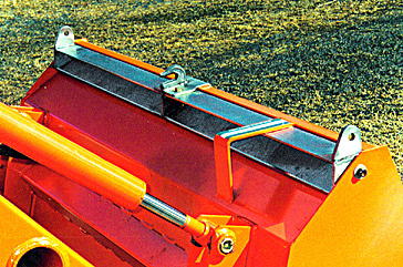

scottwfixit:
Any stiffening you can give your bucket will payoff in longevity. You can get as crazy as you want, just remember the more weight you add to the FEL, the less you can lift. /forums/images/graemlins/smile.gif ....RayBee
