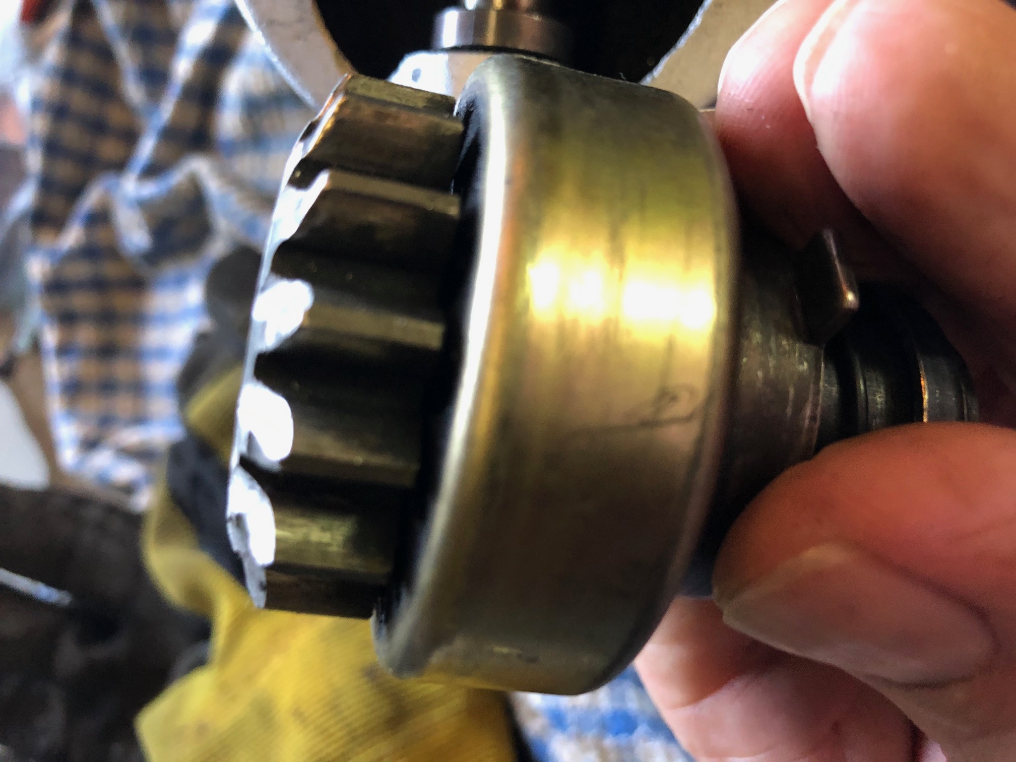

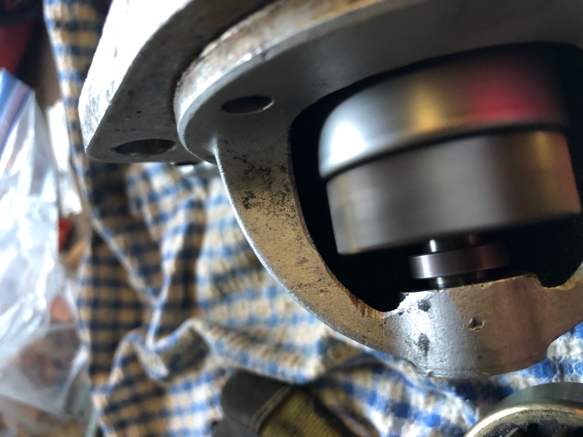

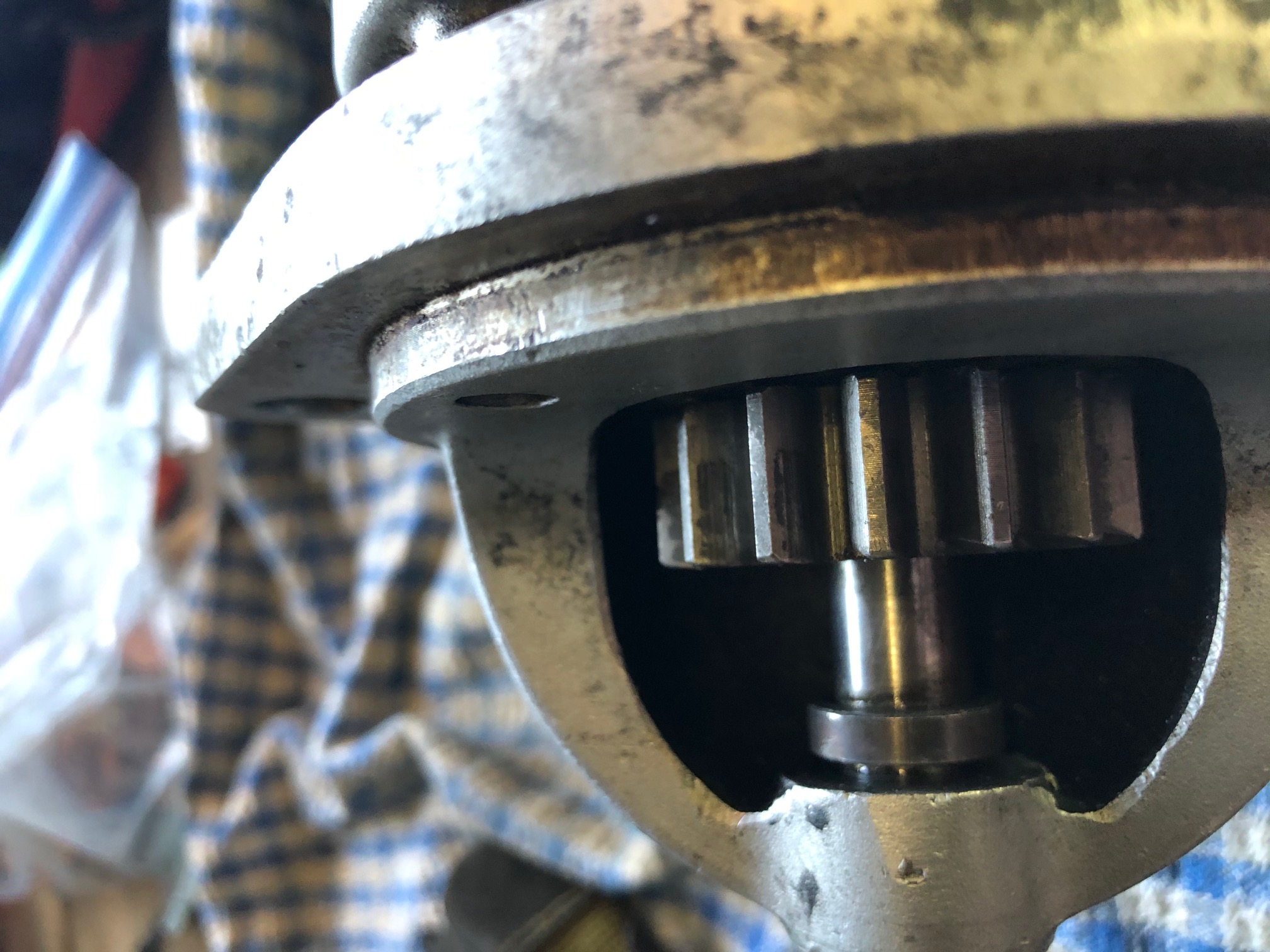

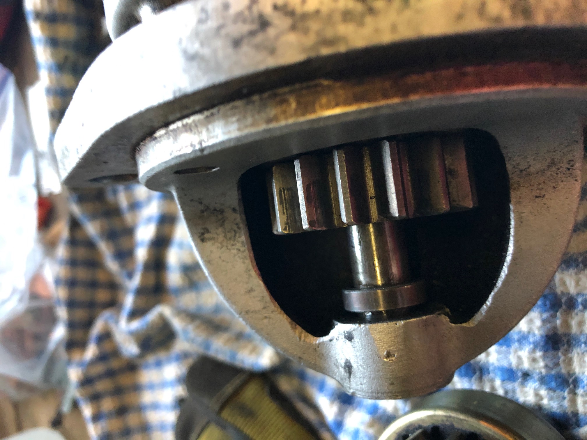

Thanks for all the observations and advice; really, really appreciate it and hope I can reciprocate . Here's where I'm at with this problem; its kind of under my skin now so I have to solve it!
Load tested the battery-It is in low end of the range on the chart that came with the tester but still within it. Note-Even though there are warning labels on the tester about how hot it gets when testing I wasn't prepared for it. They weren't kidding!
Removed Starter from tractor- counted the teeth, there are 15 as spec'd
Bench ran the Starter- Using booster cables and a short jumper for the solenoid. The gear went to the end most of the time but not always. One of the pictures shows it in motion not reaching the stopper on the shaft. I'm thinking this is the problem, at least in part. Did it about 50 times, it going to the end was random but I'd say 1 in 5 or 6 times it didn't.

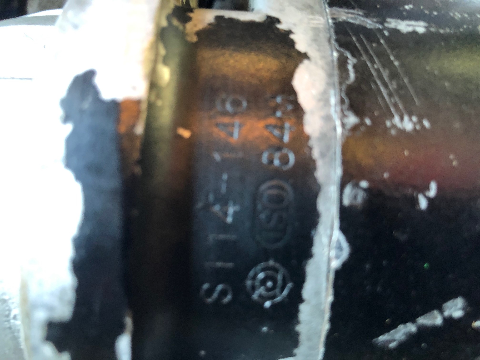

It is the correct starter-Checked by Yanmar and Hitachi part numbers.
Found the old gear-I tend to toss old parts on a shelf (not sure why) Really bad wear on first 20% of gear. Looks like it wasn't going all the way up and engaging the entire tooth. Didn't notice when I changed the unit as I had in my mind it was spring tension issue.
Have attached pictures. Taking the one with starter engaged was a little weird but got it.
My thinking is there is a distortion, albeit a minor one in the shaft causing the gear not to go right to the end where the stopper is and causing limited engagment with the ring gear. When you do it by hand you don't feel it and it goes to the end.
Opinions? I think next step is to change the starter unit.
Again, appreciate the advice and interest. Am happy to be part of this group.

If the battery test in the low end of good under a load, make sure you keep a good full charge on the battery or replace it.
If the gear is not going to the end of the shaft, there is an issue. Personally, I doubt it is a shaft issue, but like an internal electrical issue.
rScotty may be able to walk you through rebuilding it, but as we are in the midst of tractor project season for most of us, bite the preverbal bullet and order a starter.
Put it on the shelf to rebuild as a winter project if the place you order from does not want a core returned.

But first lets back up a minute.
Yes, I can guide you through a rebuild of the starter. On your end you are going to have to have a known good battery and a multimeter for me to be able to do that.
But what worries me the most is acting right now to save what is left of your poor old ring gear. You don't have enough left to experiment with.
And the best way to do that is to get a rebuilt starter that you absolutely know is standard for your tractor. No aftermarket crap. Go to one of the old Yanmar guys like Hoye or Leonard Shaeffer. Guys who know those old 240Ds.... from half a century ago!!
I haven't followed along like I should have. Did you rebuild the solenoid? Thinking back, I believe that originally this starter was originally the kind whose solenoid had a lever that the solenoid electromagnet used to push the starter gear to the end of the shaft rather than being the type where the starter revolutions moved the starter gear into engagement.
I'd have to check some old literature tonight and see what starter that was called for. It has part numbers on the starter? What are they? I was going to ask if that starter had any clues or ID on it.... that's good.

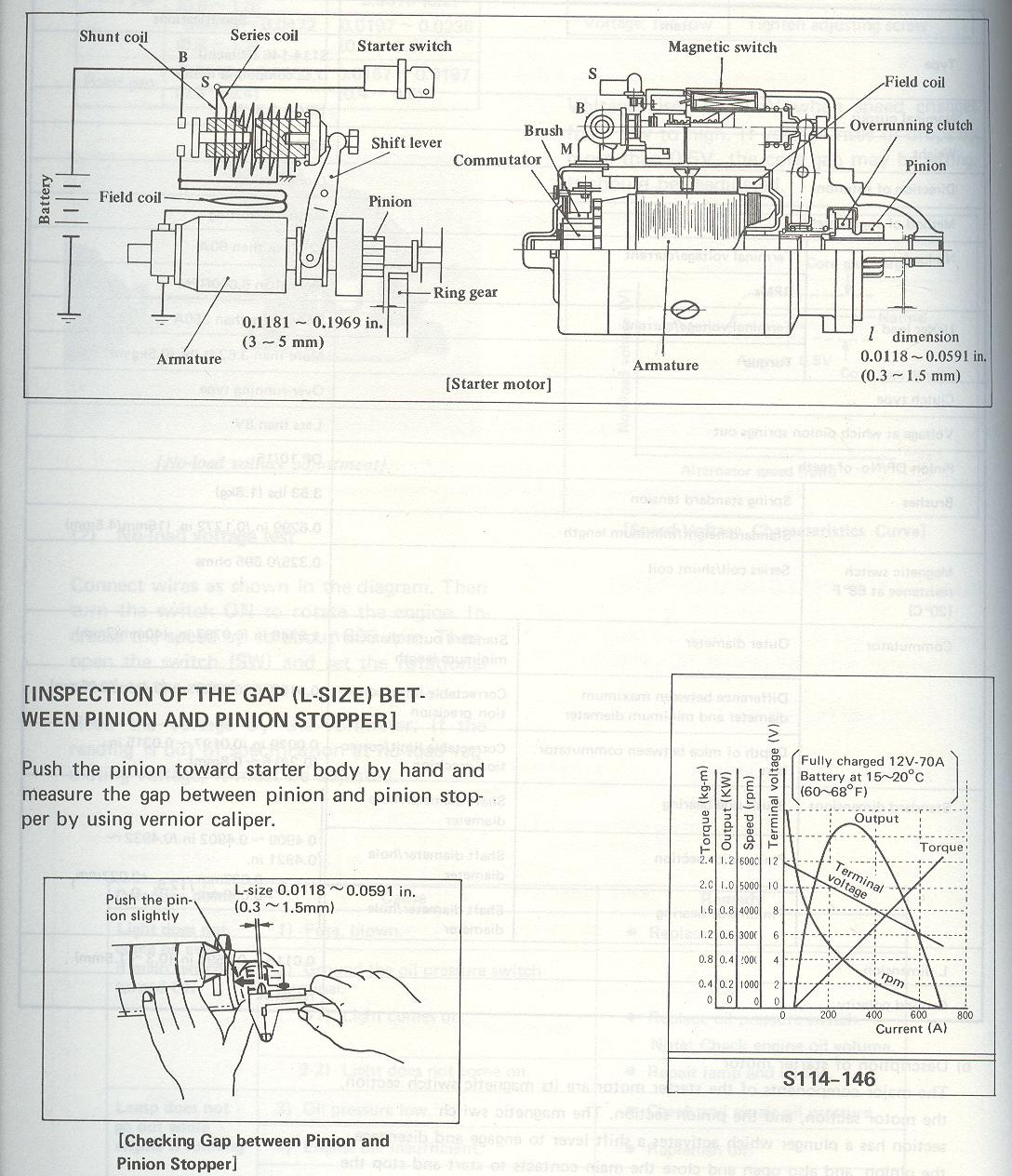

OK. I found some more specs. These old manuals I have often seem to contradict each other.
One CORRECTION. After looking at some other old exploded drawings of the YM195 starter - which should be the same, I now believe that I was wrong to say that there is a compression spring located within the solenoid. And therefore also wrong to say that the movement of the solenoid compressed that spring. It would make sense, but I don't think that spring exists.....I think I was fooled by their attempt to draw a schematic of the solenoid coil. If that is correct, then the only return spring in the system is that weird looking torsional one you mentioned.
Yes, that 3 to 5 would be difficult to measure. There is another measurement that might make sense. In the pictures below, there is what seems to be a measurement of how much clearance there is between the pinion and the stop....although if that is true then some of the text saying how to measure it seems backwards. Anyway, see copies below
