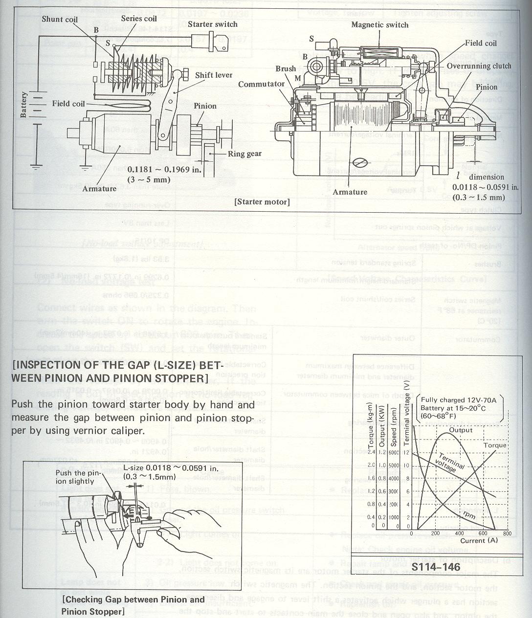

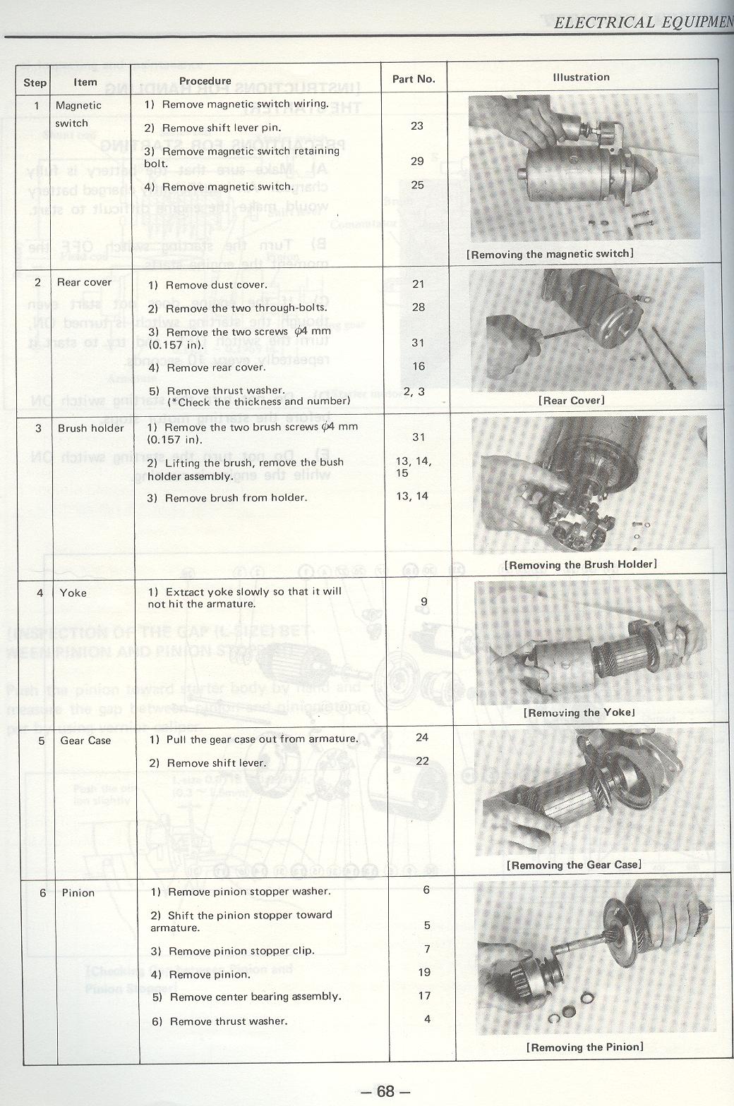

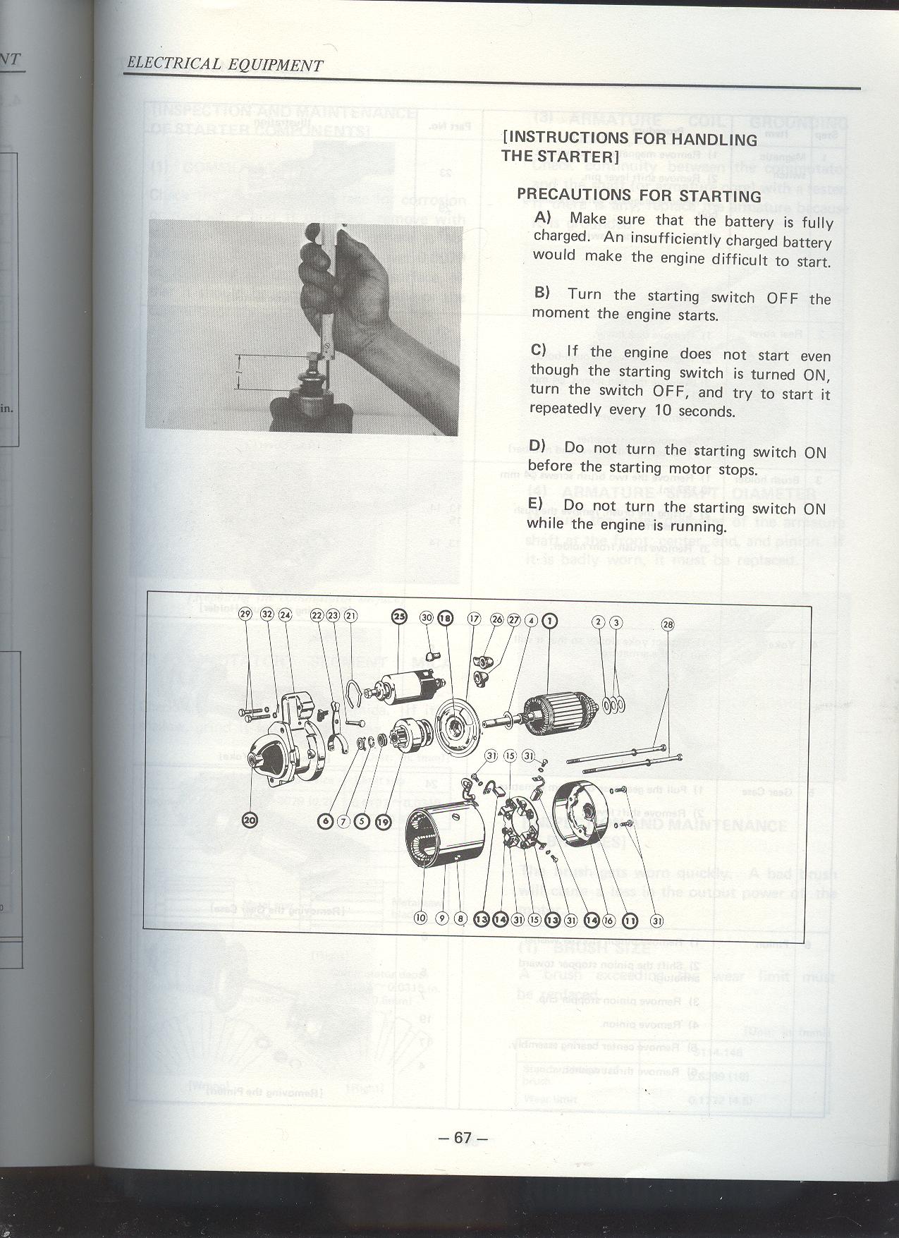

OK. I found some more specs. These old manuals I have often seem to contradict each other.
One CORRECTION. After looking at some other old exploded drawings of the YM195 starter - which should be the same, I now believe that I was wrong to say that there is a compression spring located within the solenoid. And therefore also wrong to say that the movement of the solenoid compressed that spring. It would make sense, but I don't think that spring exists.....I think I was fooled by their attempt to draw a schematic of the solenoid coil. If that is correct, then the only return spring in the system is that weird looking torsional one you mentioned.
Yes, that 3 to 5 would be difficult to measure. There is another measurement that might make sense. In the pictures below, there is what seems to be a measurement of how much clearance there is between the pinion and the stop....although if that is true then some of the text saying how to measure it seems backwards. Anyway, see copies below
rScotty
