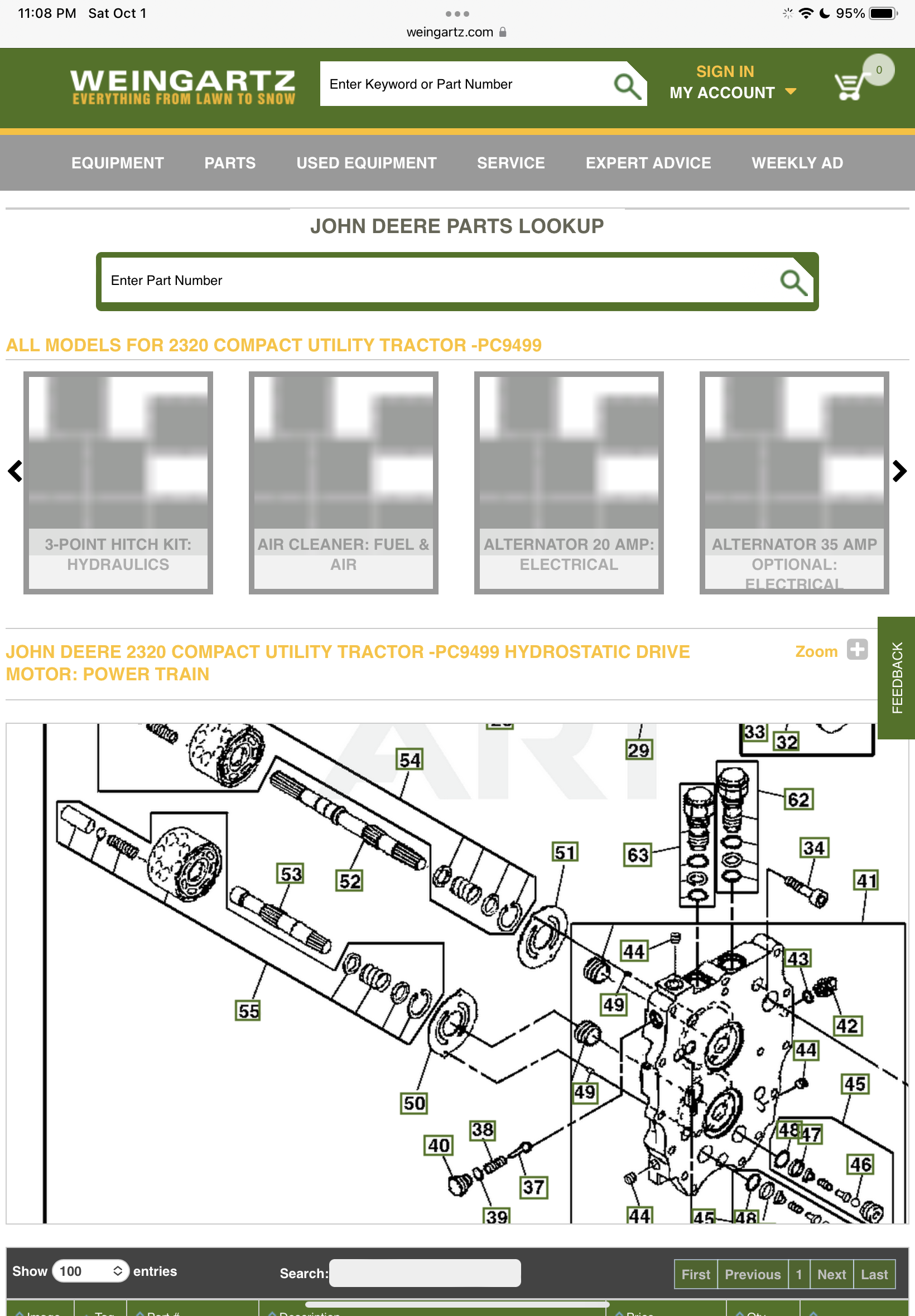

I will post another update once i get more detail. I did get advice from dealer…..ran tests. Got a better uderstanding of how this charge pump work. Took off transaxle again…removed hydrostat. Broke down completey and cleaned. Reassembled and same issue.
To clarify function…..
the hydrostatic has 2 spinning piston pumps inside. One for drive and one to drive charge pump. Both dive and suck directly into thick plate with channels. I found port for that pump pressure test ….and the one for the pto Right next to selenoid. Charge should be 100 and pto 300. Mine is 30 and 100. So engages but weak. All of the flow occurs within channels in that one inch thick plate and only one small hole at top That seems to vent oil Into a channel which I assume goes to pto. The return is a line into top of case (not the plate). So i’m lost as to where the pressure is going. Everything works on drive, and separate pump Powers theimplements and steering. Other than weak charge pressure (that keeps oil flowing and driving pto clutch). I can only think the charge pump pressure release is weak, and venting? there is a small valve on side. Removed. Spring is fine. Dealer says that type of issue would be very rare.
So…..I have taken to dealer to see if they can diagnose. He thinks he can In hour or two. But not sure how without full tear own and random parts replacement.?

Your PTO and charge oil circuits do not go through the hydrostat itself. The charge pump supplies oil to the hydrostat, but PTO pressure is separate from hydrostat although it may go through separate passages in the hydrostat housing. Your test shows low charge pressure. Fix that and you will solve the problem. There could be a leak in a suction line, dirt in the charge pressure relief valve, or maybe the wrong gasket not sealing a charge oil pressure passage. Your dealer should pick up the problem pretty quickly. The gear driving the charge pressure pump is driven by a pin through the input shaft it rides on or a key in a keyway on that shaft.. There may be a problem with that. If the pin is broken or worn the gear may be slipping on the shaft. The charge pump is on the outside of the transmission and can be removed without splitting case. Hopefully the repair can be done without splitting the case.
Let us know what you find out.

Thanks for the added info. I do have the official manual. There is a charge pressure port location and proceedure. There is no pto port anywhere in manual. Dealer confirmed it’s not there. He said it would be near pto senenoid and it was. Clearly charge pump pressure low I agree and that issue will solve the other. I also agree seems likely I did something?. there is also no charge pump on outside of hydro. The hydraulic pump is….but only drives implements and steering. I will attach diagram but dual function hydrostat pump. Earlier post with there of op talks about a variable output motor drive pump and the lower fixed output pump inside hydro. Agreed also that high pressure ports and relief valves are for drive. Low pressure circuit is for charge. I did do what I thought was full tear down clean / flashlight etc. including the 3 valves ( 2 high pressure and one I assume is low pressure). Passages were not that tiny and could see through them. the orifice is supposed to be after the charge pump so likely not affect charge pressure. The plug on top of schematic is the charge port test. I remain baffled. I still blame myself…just not sure exactly where it went wrong. Or….given havent used bug cutter this year ….was it just getting weak over time ? Was valve leaking a little ? Prob not i suppose.
I have removed my post which referred to the wrong transmission for your tractor. The two hydro "pumps" are actually just parts of the hydro. The hydro does not supply oil pressure to anything else. The hydraulic pump in one of your parts pics which is on the outside of the case is the charge pump, it supplies oil to all other services and it supplies 100 psi charge pressure to the hydro trans. Its pressure is controlled by the charge pressure relief valve. It does supply the PTO circuit per your schematic and that is why the PTO solenoid is close to that pump. The reason for low charge pump pressure is either an air leak in an intake line, a bit of dirt in the charge pressure relief valve, a problem with a gasket or wrong fit in the hydro which causes a leak of some of the charge oil coming in, or some problem in the gear on the input shaft from engine which drives a gear on the charge pump.(Not Likely.) The most likely cause is a small leak in an intake line due to your service with Oring or gasket not quite sealing. Pressure relief problem is second.(Did you find and check the charge pressure relief valve.?) Third some error in hydro assembly causing a small leak of charge pressure. Finally, did you see the gear train which drove that oil pump from the input shaft when you took hydro off or did that remain untouched? Could you have problems with how the gear is secured to input shaft or how gear is secured to the pump input shaft? Did you have to take the charge pump off or apart to work on the hydro? Most likely, a gear problem would give no pump output at all from charge pump. Partial pressure is likely to be sealing problem of relief valve or a small leak somewhere.
I don't believe this is a problem which existed before your work. The clutch will work OK after charge pressure is fixed unless it was run for a long with reduced apply pressure.
