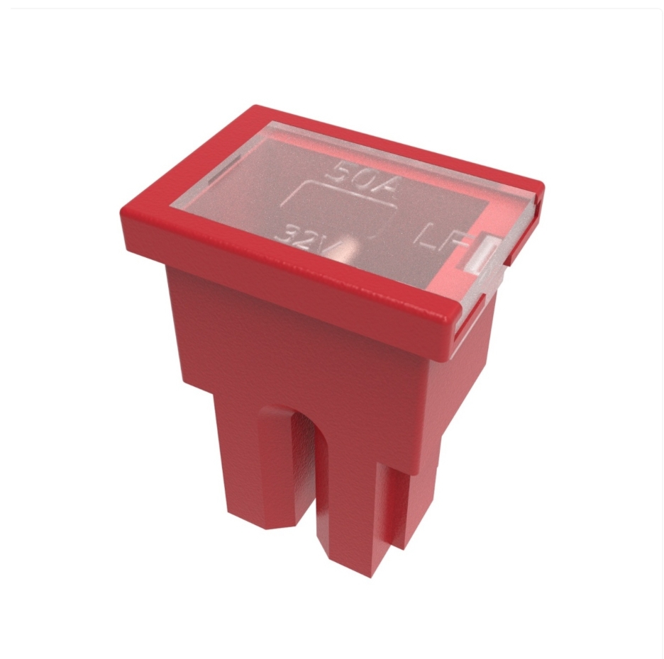

What exactly is a PAL Fuse? Is it different than what you find in a typical fuse box! It seems the term ‘PAL fuse’ covers a broad gamut of this term.
   / PTO Fuse Blows Under Load #18
P.A.L. Fuses
PAL fuses offer dependable circuit protection for automotive and industrial applications, effectively handling high current loads. The fuses are made for systems that require steady, reliable performance in demanding conditions. PAL fuses are particularly useful in many Japanese and domestically-built vehicles.
  • Ideal for high-current automotive applications
  • Durable construction withstands harsh environments
  • Compact design fits various fuse holders
  • Protects circuits from overloads and short circuits
There very heavy duty fuses
