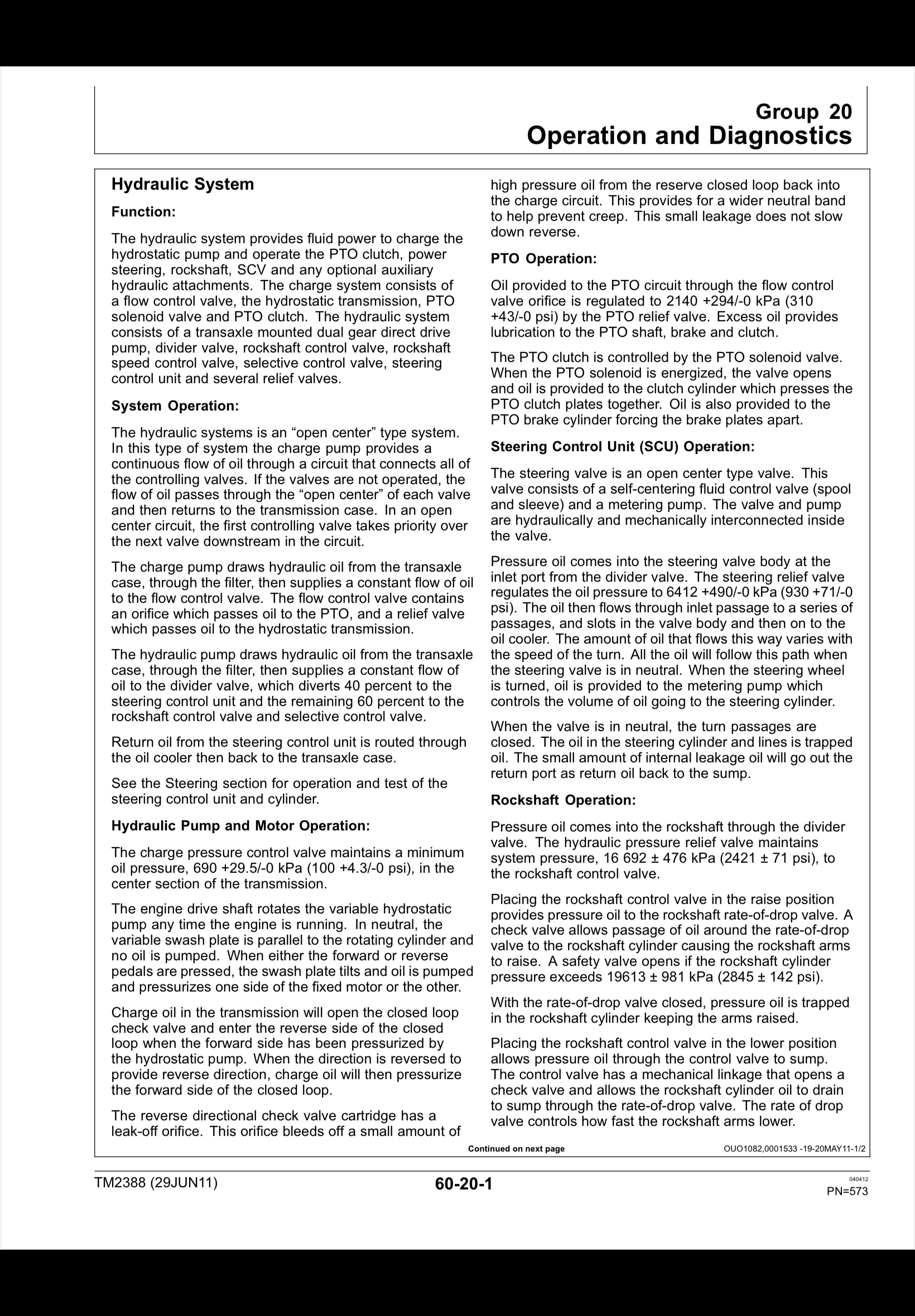

This is a whole new line of learning for me. Very interesting albeit a challenge. I appreciate the knowledge passed along. In service manual there is some ambiguity. There is a photo/guide for “charge pump” pressure test and port that is 100psi. There are fwd/rev high pressure ports at huge pressure 3500psi. The theory of operation talks about hydraulic pump and motor. 21l/min. Not sure how those differ. There is schematic of “hydraulic pump” which is quite small … but has selenoid and relief valve etc. I assume this is what feeds pto clutch? There is also a spec for “pto clutch/brake test port” at 310psi….but no indication where I can find that test port?!

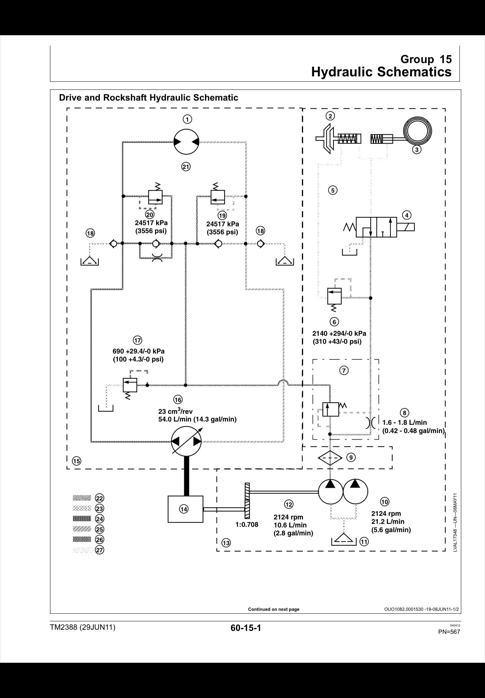

Does service manual provide a schematic for PTO clutch? Can you post a copy of the schematic? Might help us armchair mechanics assist with diagnosis. Charge pump might be the same pump also used for brakes and PTO. Depending on test port location it could read 310 PSI all the time or only when clutch solenoid is energized. Do the brakes work properly? If yes that would indicate that the 310 PSI is available for brakes so would point towards problem in clutch circuit.

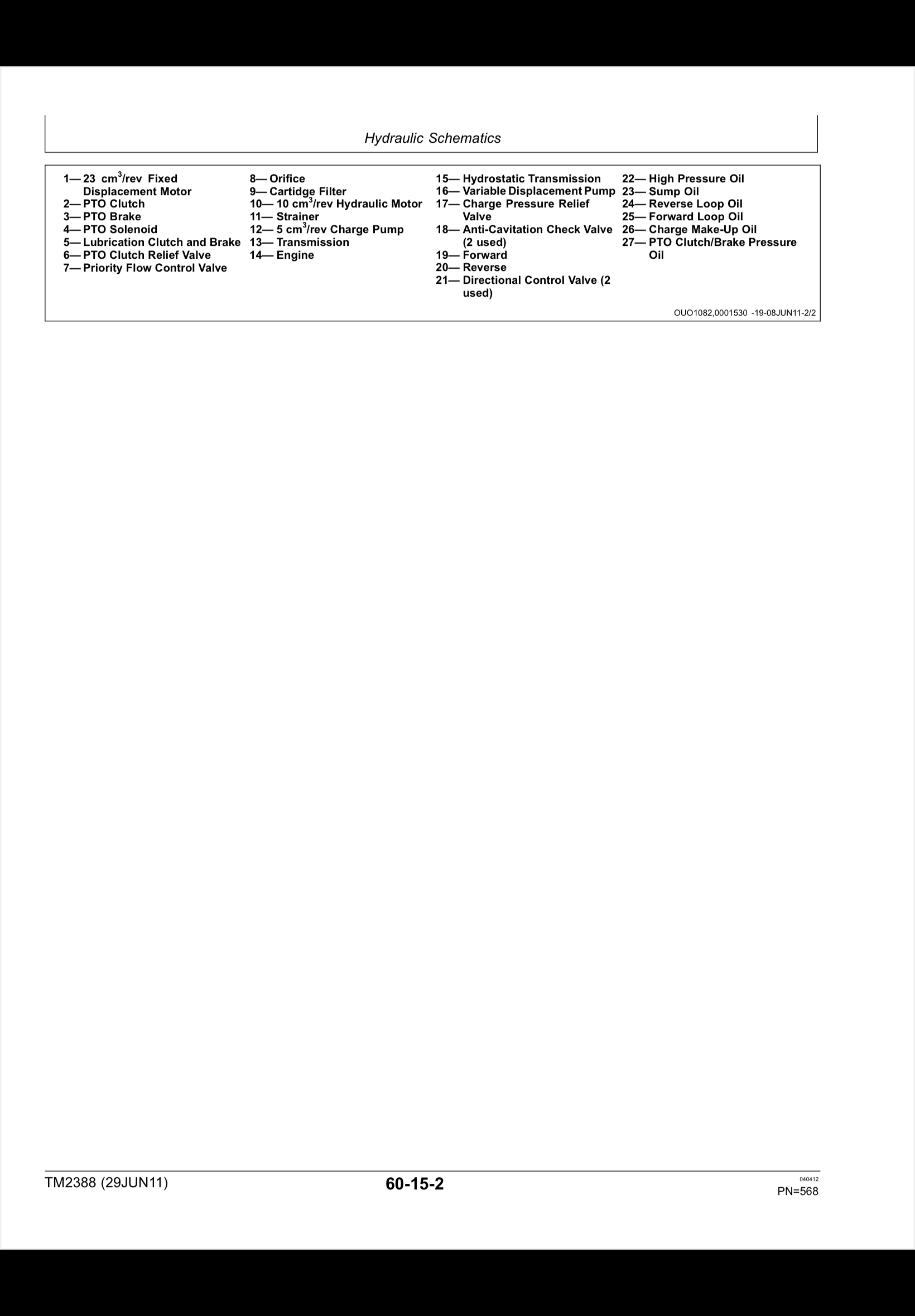

I will try to add as screenshot. I can’t seem to extract a page from the pdf. Let me know if these are readable. Yes brakes work as does steering and FEL and 3 point. And the pto worked for a while. Just started to bog and I shut down After a time it ran fine, on and off. But has done this twice And as noted don’t want to burn clutch if it’s another issue.

Item 7 is a priority flow control feeding oil to the PTO circuit. Item 8 is the PTO relief. The charge pump is feeding the PTO circuit. You should see 310 PSI in the PTO circuit when ever the PTO solenoid is energized. De- energized pressure should drop. Now the big question is where can you test this pressure?

Thank you for this ! And yes ! As noted I saw a spec port in list. I will try to call a dealer.
So IF I was to test ….Would a clog show low pressure ? Or depending on placement of port I might still see 310psi and not know if it’s worn clutch or clog causing issue?
Maybe I should also take your advice on the repair path. IF for now I assume it’s a clog. (don’t want to split transmission without being sure) How do I address it ? Fluid and standard screen change feels like it won’t solve debris in the orifice etc. Can I remove selenoid ( or small pump….or other part) and look for/clean debris ?
