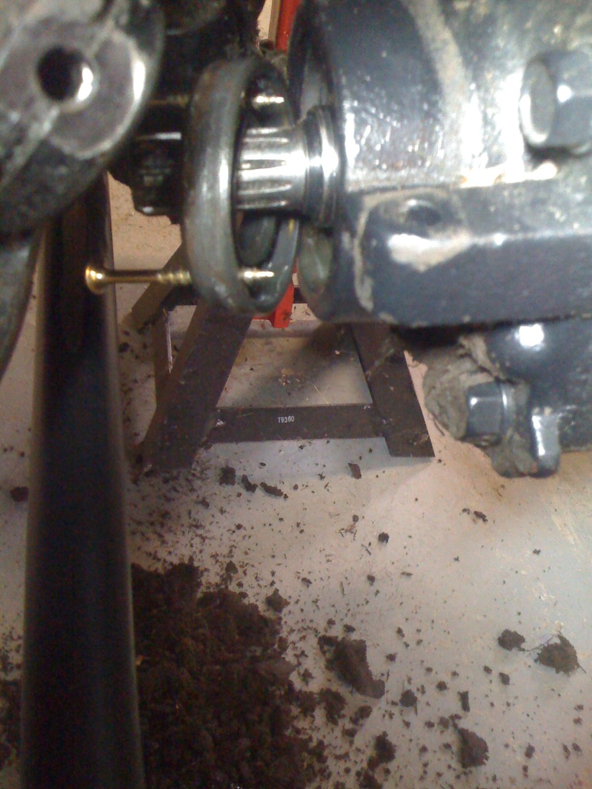

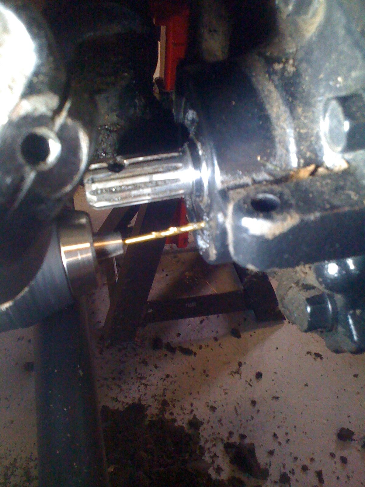

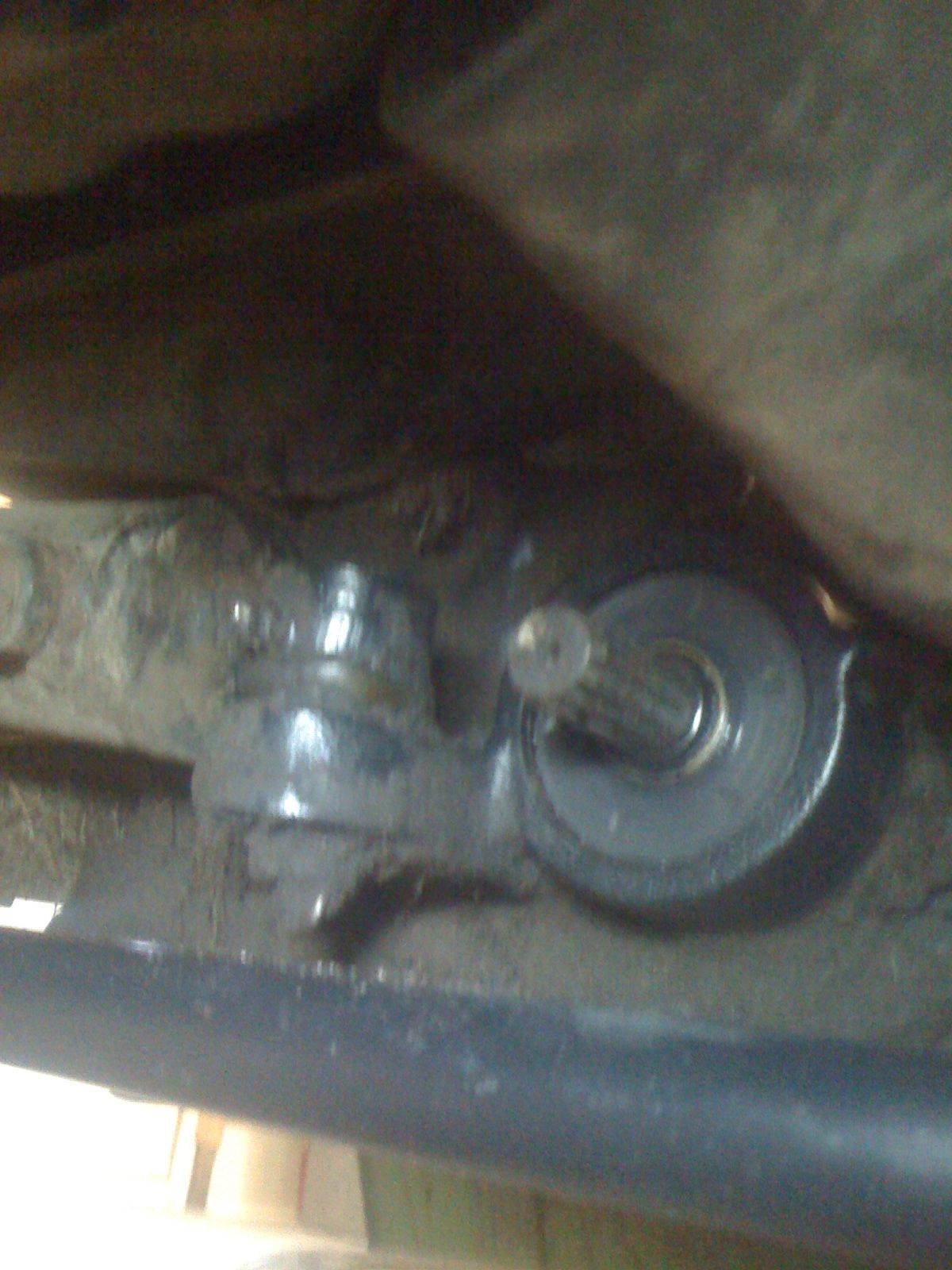

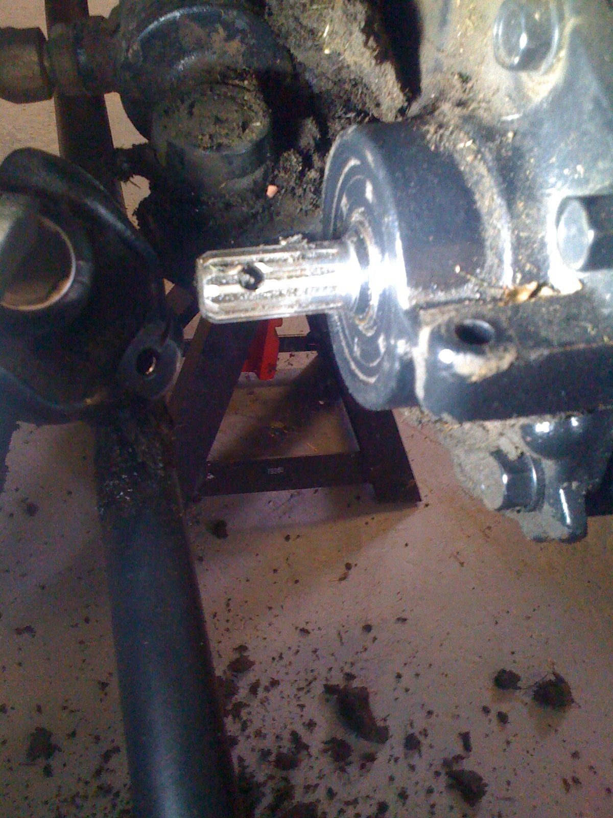

/ 2305 oil leak #6
jsb2b is correct....check to make sure the drop of oil is coming from the boot in front where the shaft for the MFWD goes in...I had that same problem with mine and I changed the seal just 3 weeks ago.
I took some pictures while I was doing it so I might just post them
/ 2305 oil leak #7
Here are a few pictures...Took about an hour to change:thumbsup:

/ 2305 oil leak #9
I have little to no mechanical skills and replacing was not hard. Just use the right tools..
You'll need a pair of snap ring pliers and a spring pin punch to separate the drive axle from the front differential...
