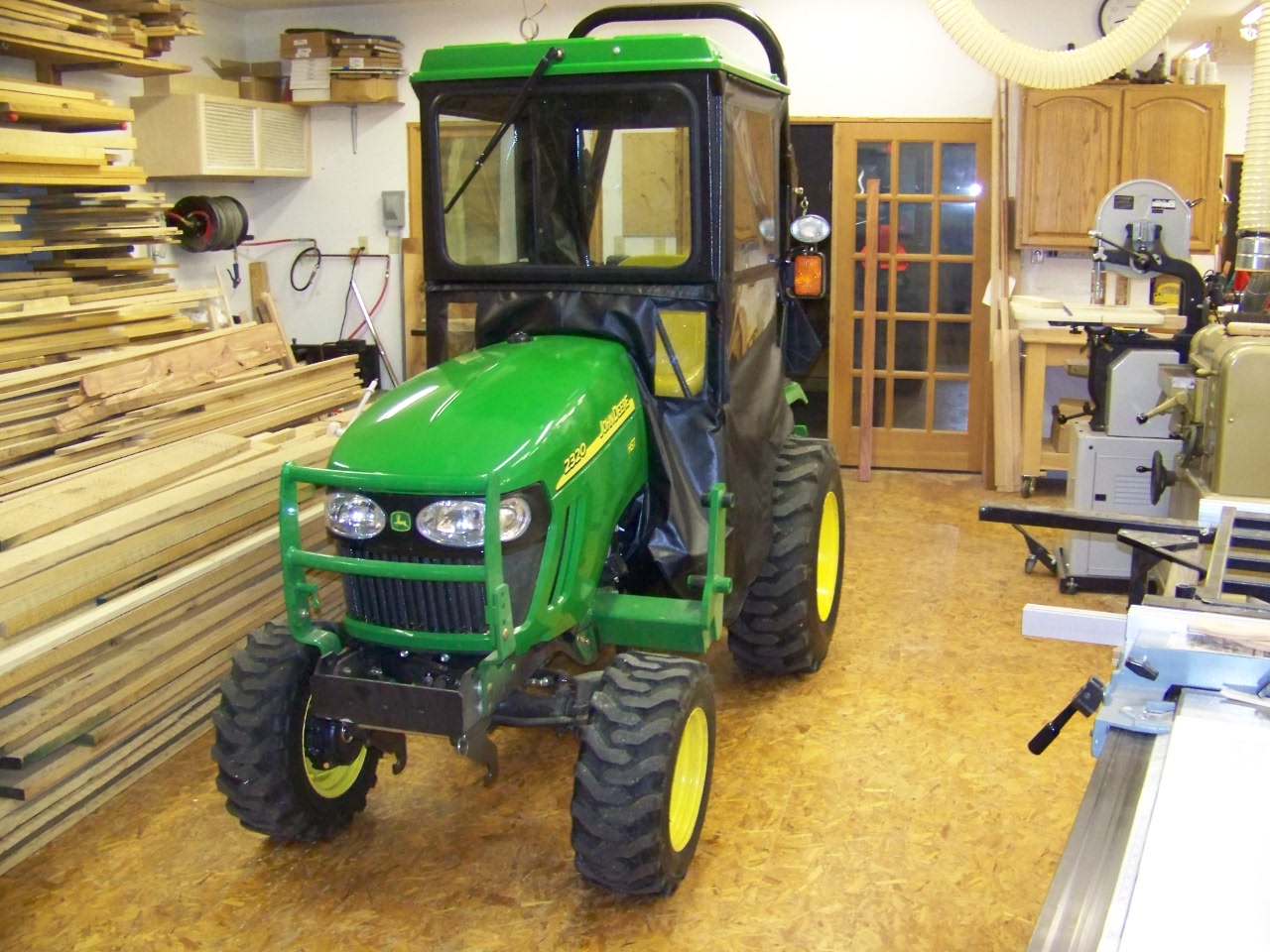

Last spring I traded my 2210 for a 2320. I had an Original Tractor soft sided cab for the 2210. Late in the summer I discovered that Original did not make a cab for the 2320. I decided to try & adapt the 2210 cab to the 2320. They are calling for several inches of snow tonight & tomarrow. So after lunch I decided to install the cab. It went better than I expected & turn out very well.

Did this cab leave rub marks on your 2210 when you took it off. slkpk
I only have the cab on during the winter for snow removal. I never noticed any marks on the 2210. I am sure it would leave marks if it was on all of the time.

That turned out very nice.
looks just like it was made for it.....:)
/ 2210 Cab on a 2320 #10
Looks like it will be "toasty" this winter!! Good job.
Noticed your 62D draft arms are down.... Don't let them get bent$$$$:eek:
I had not locked them up when the picture was taken. Just before I started on the cab install I removed the deck & serviced it.

Looks very good. i have a question i hear that aftermarket cabs are pretty loud inside and they occassionally have an issue witrh fumes. Are you experiencing any of those issues?
It is very loud inside the cab.
I have Peltor hearing protectors that I wear anytime I use the tractor. Cab on or not.
Fumes have never been an issue.

I also have a 2320 and have been looking for a cab. I have been bothering Original Cab Co. about this for 6 months and I received an email from the company recently with a picture of their new cab for the 2320. I noticed in your pics that you have the bar up and was wondering if you could still mount the cab securely with the ROPS down? I am trying to fit it into a garage with 7ft clearance. Obviously I could not have the ROPS up. I was thinking about modifying it some how to attach it with the bar down.

I also have to fold the roll bar down to get in my buildings. To support the cab, I made a small small wood frame that I mounted to the lower roll bar frame.
