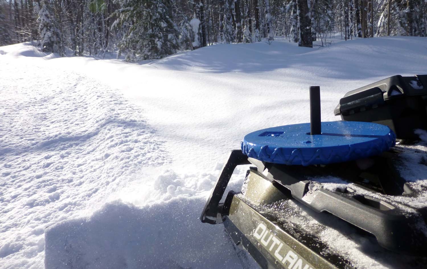

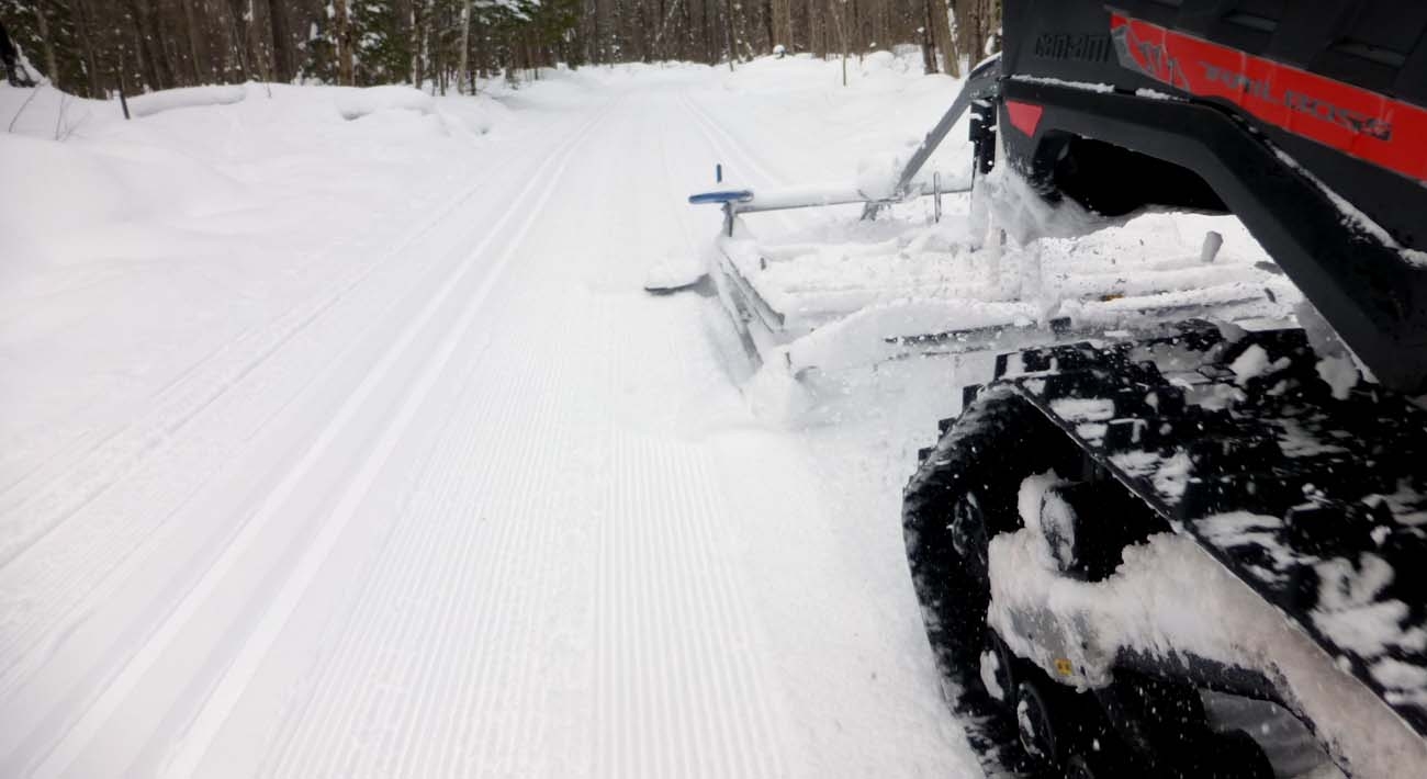

Let me know if you fellows would like to see the new heat shield. This is the underside of the box.

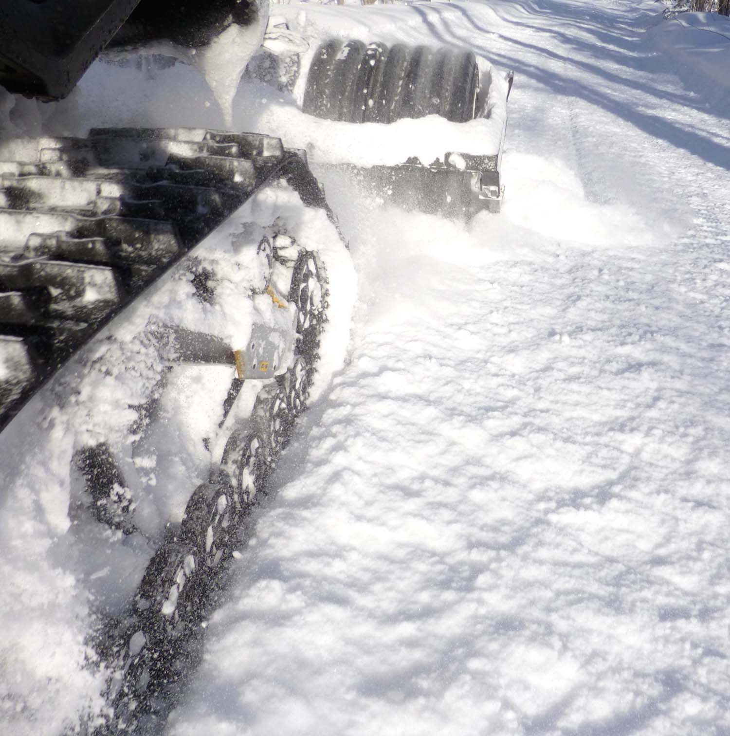

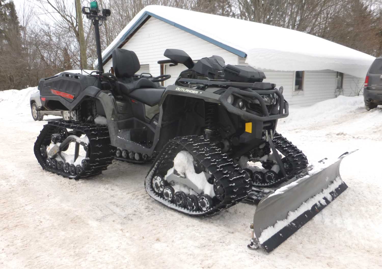

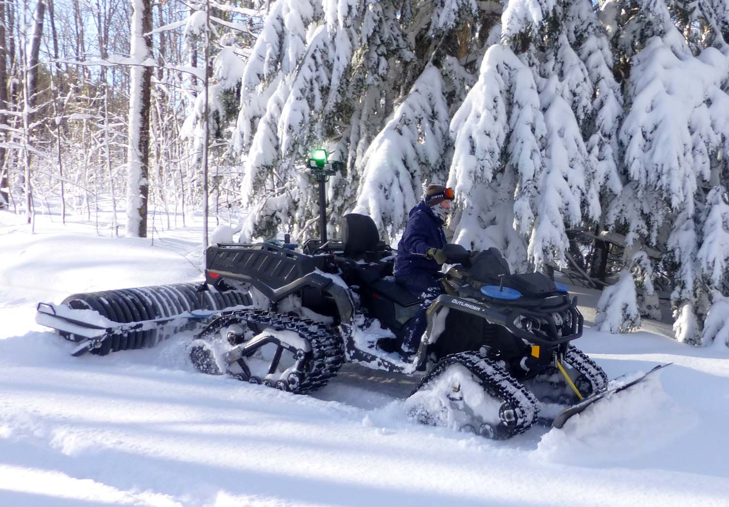

I'm sending our pods to my buddies shop who's seen here in these dated pics to be detracked and all bearings spun and replaced if any roughness is felt. Its now the end of there 3rd season and they need to be checked..

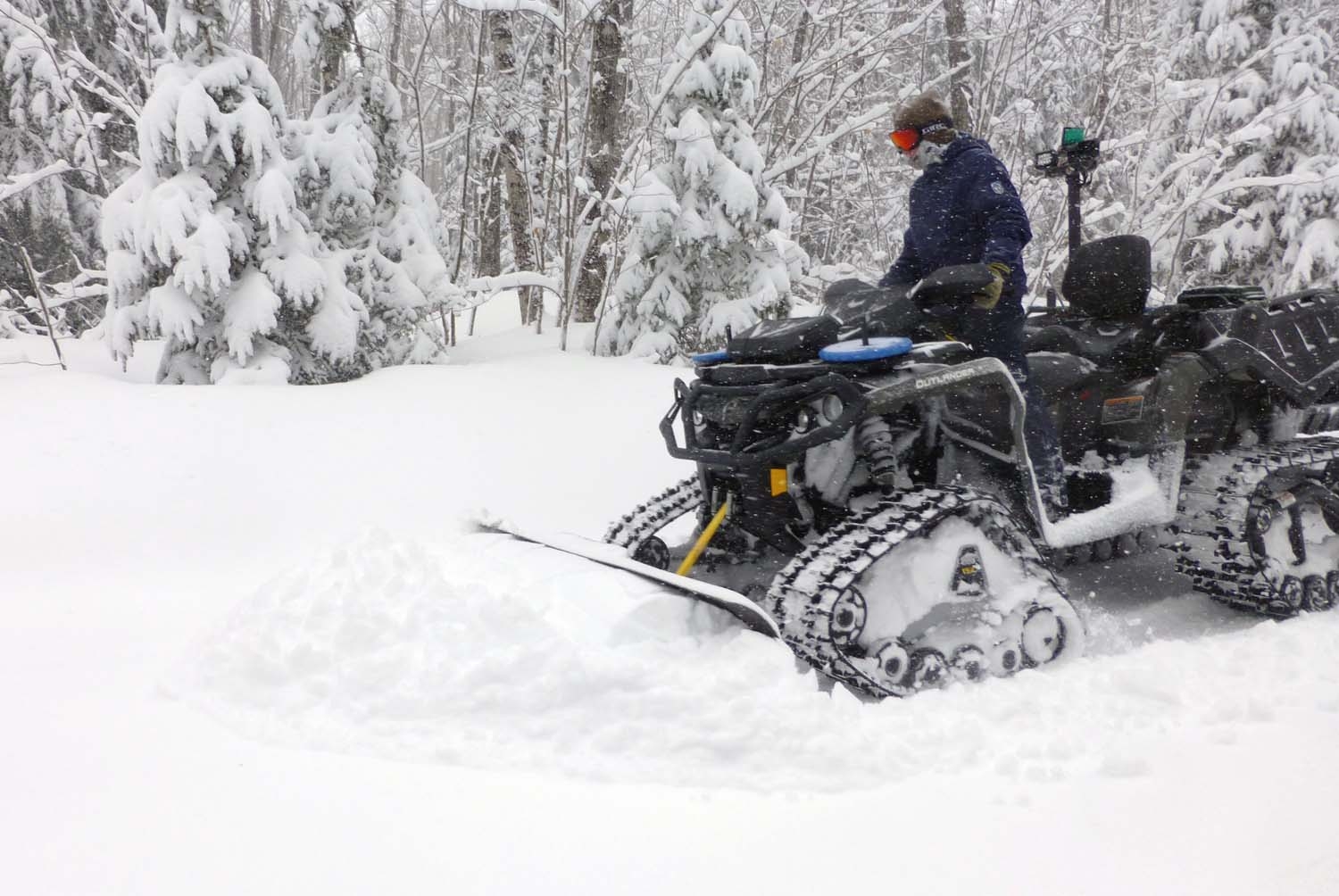

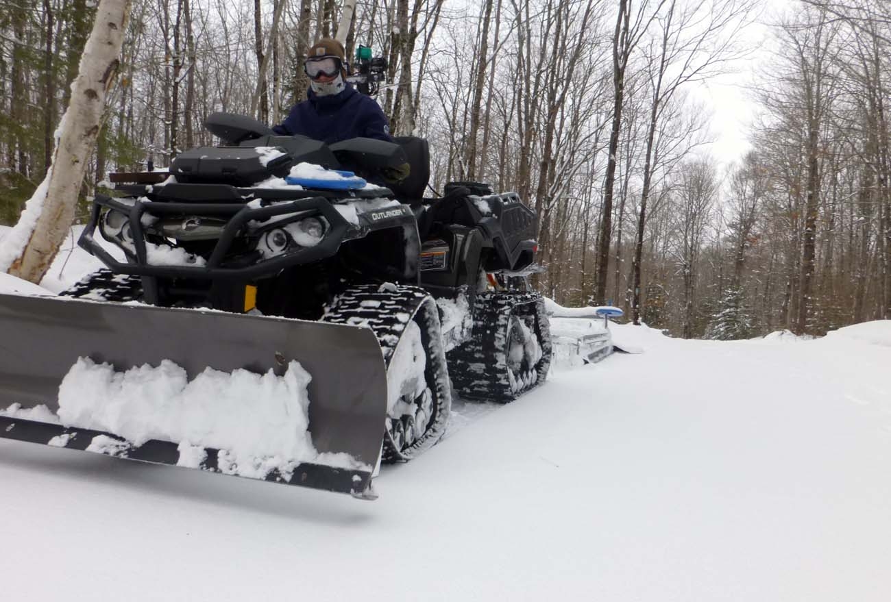

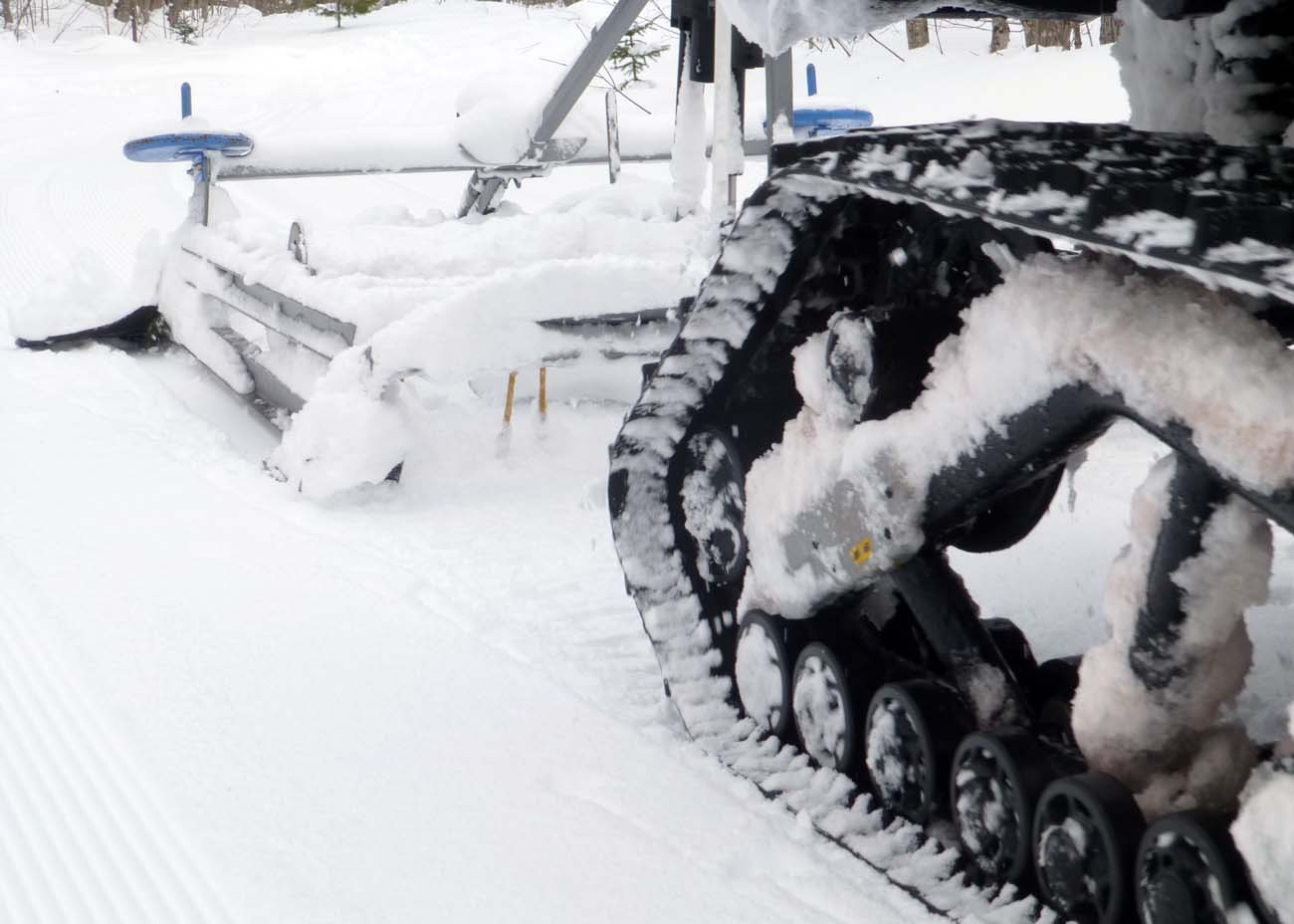

I'm also updatingor reinforcing the plow since its the off season now. This machine sees 90% of its hours over the winter..

Update! One of my former grooming cohorts now operates a lawn and garden service shop. He took our 3 season old pods apart (3 or 4, can't recall) to check the bearings. He went through all 4 track pods and found 2 bad bearings on one of the rear drive axles and one rear idler axle. The front main bearings felt good and surprisingly and did not find any rough idler wheel bearings on them. He pulled the caps on all 6 main axles to check for water intrusion. The rear main bearings on order. Normal off season maintenance.
