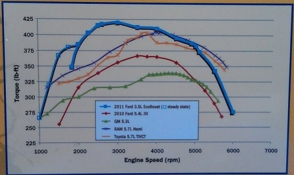

Here is the area under the curve that was mentioned. I know you earlier mentioned some concern for taxing a turbo charged V6 but it has out performed the toyota powertrain in every towing test I have read. Even using common sense, I am not sure how to compare that to the F250. The F250 has about 50 percent higher tow ratings so I would guess it to be superior. I agree the tundra has an awesome powertrain and is probably more reliable but performace and towing capability I would consider it pretty much equal to the F150.

The torque chart above shows exactly why I choose the 5.7L Hemi, considering I had the Chevy 5.3L dog motor. Look at how far you gotta rev that thing to get any torque out of it. What a pig! :yuck:
The Hemi takes care of me, as I tow moderate loads sporadically. For those towing heavy loads more frequently, I would think the arguement for diesel becomes stronger because the Ford EB fuel consumption should drop quite a bit, seeing as it is still a stoicheometric gasoline engine, right?
I guess I still don't see the case for the EB engine - much more expensive than the naturally aspirated V8s, so would not buy for light/moderate towing. Poorer fuel mileage than diesel for heavy towing, and debatable durability?
