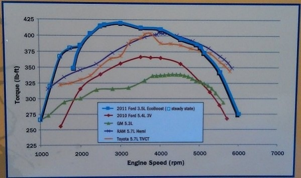

The torque chart above shows exactly why I choose the 5.7L Hemi, considering I had the Chevy 5.3L dog motor. Look at how far you gotta rev that thing to get any torque out of it. What a pig! :yuck:

It's about torque. HP number sell vehicles to the blind. A steep torque curve from idle with a long flat band at around 2500 rpms will eat alive a angular torque curve that doesn't hit is peak numbers till 5000 rpms. This is where the EB shines making 85% of its HP and torque just above idea while the competition is screaming in the 4000 rpms range.

Here is the area under the curve that was mentioned.
What's the source for this? They look like chassis dynos, except for the Ford's. Of course.
If you would look closely, you will see that the peak numbers pretty much match up with the peaks provided by each manufacturer. That's not a Ford-biased graph like you would like everyone to believe, but an actual graph for each MFR. That's what's so great about the EB...a long, flat torque plateau for a torque curve. Very similar to a diesel.
It's not the peaks, it's the shape of the plots which is either totally bogus, or a mix of sources. They are definitely not engine room dyno's... except possibly the two from ford.
   / 2013 Tundra vs 2013 Ford #230
I'm not sure what you are having an issue with in the chart, but it looks pretty normal to me.
