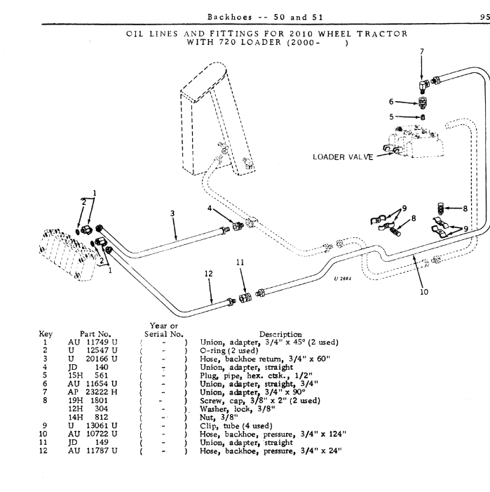

We have a 2010 John Deere and want to install a backhoe. Can any one tell us where to connect the to hoses or the configuration of the hydraulic hoses. We have attempted it with no success.
Thanks for your time.

You will likely need a "power beyond" kit available from your dealer. It will give you a set of hyd. connections at the rear for the backhoe. The power beyond hooks into the loader valve for constant hyd. flow.

Are you adding or already have a crankshaft driven hyd pump installed??

We wanted to tie into the existing tractor hydraulics. We have a loader on the tractor already.
/ 2010 John Deere.. installing 3 point backhoe #6
I seriously doubt a factory 2010 hyd pump will operate a BH very well.
/ 2010 John Deere.. installing 3 point backhoe #7
What model JD tractor are you attempting to install the BH on?
If 2010 is the model, here is the hyd.
Very low pressure
Hydraulics:
Type: open center
Capacity: 8 gal [30.3 L]
Pressure: 1150 psi [79.3 bar]
Valves: 1 or 2
Total flow: 11 gpm [41.6 lpm]
