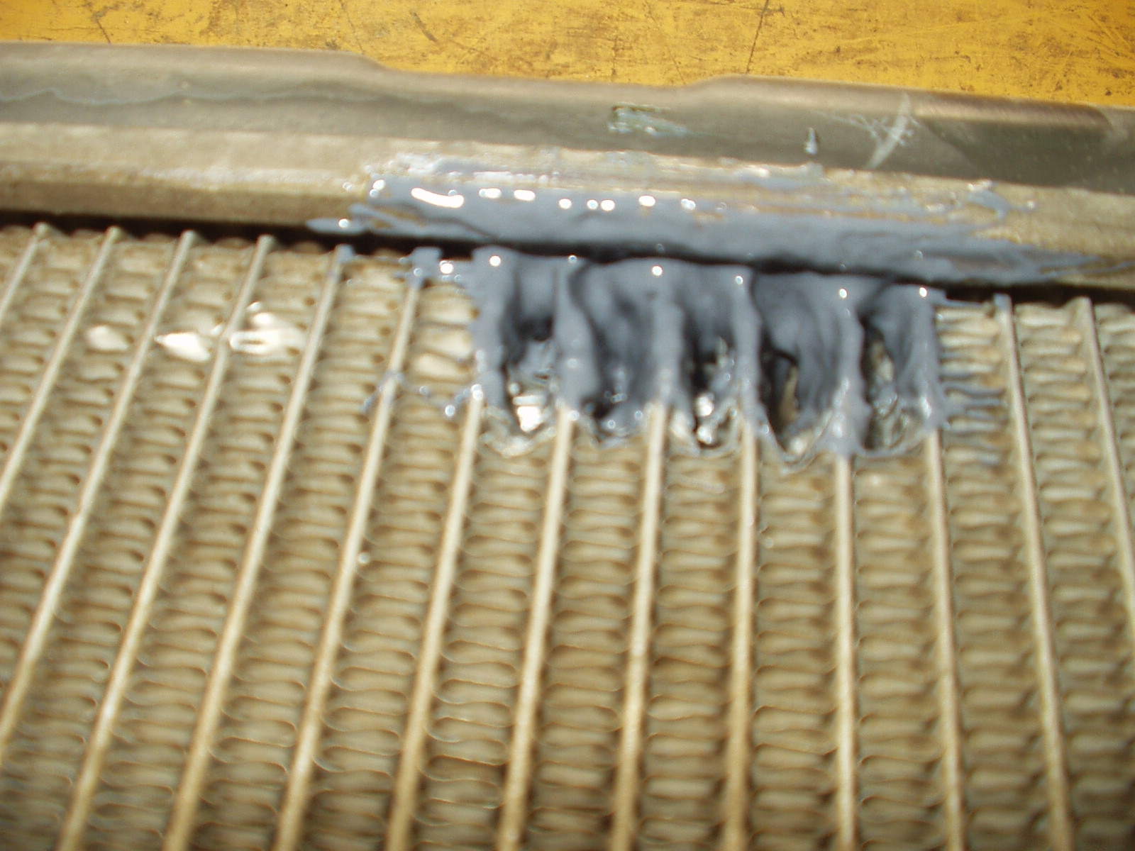

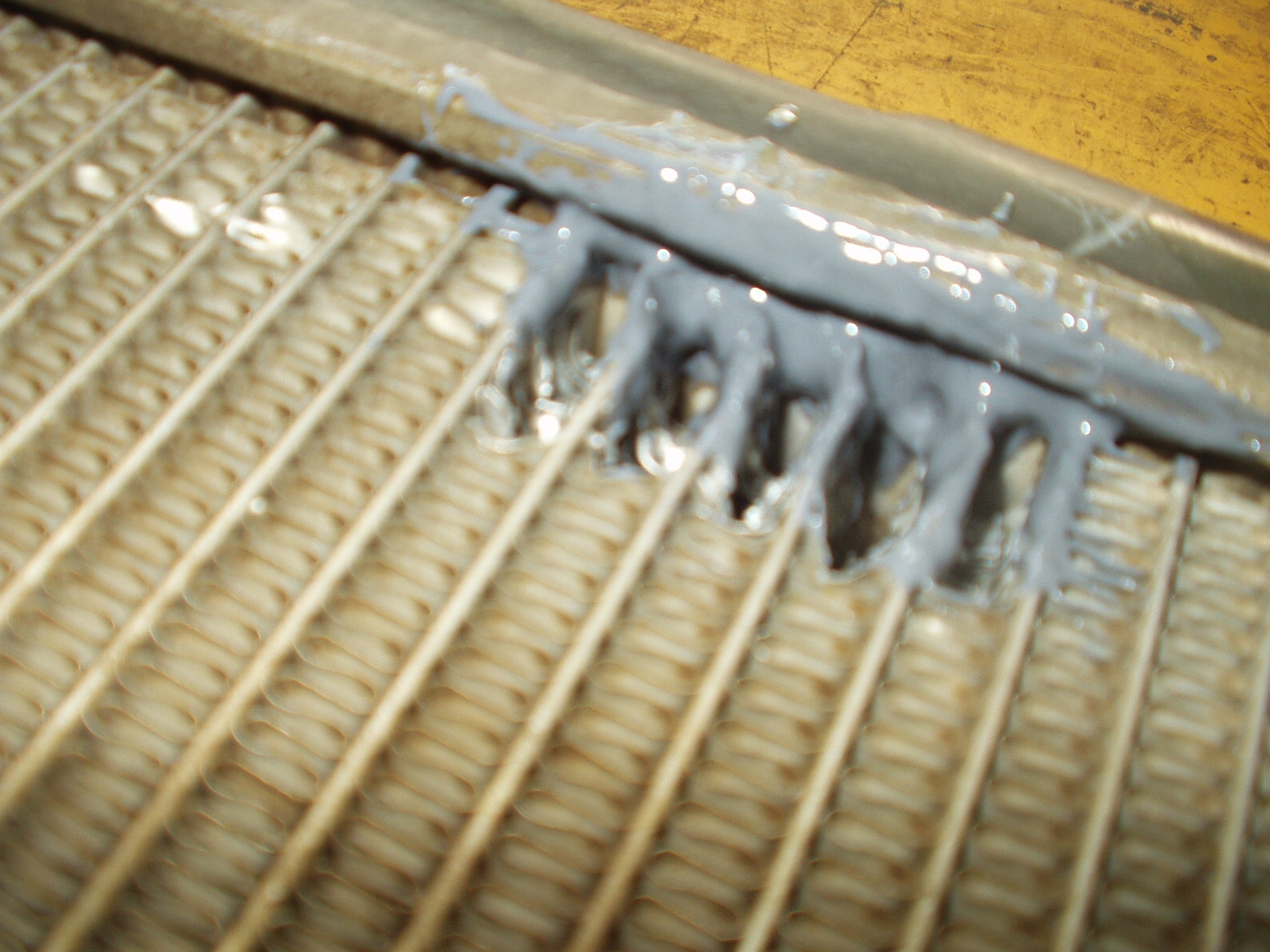

I got the first two layers of epoxy on. Tomorrow I will put another 1 or 2. It takes a full 24 hours to cure and though it says it sets in 1 hour I found that 2 hours between coats still found the first coat soft. Maybe by Sunday I can do a water test to see if the leaks have been plugged.

/ 2003 GC2300 broken radiator. #24
Takes about 24 hours to achieve full hardness...... A gentile application of heat (just warm to the touch) will sometime speed up hardening process .... But don't get it "HOT"....
/ 2003 GC2300 broken radiator. #25
Water tests (?? not sure what that is) don't count. It is Pressure that matters. One can borrow a radiator pressure test kit from most any friendly repair shop OR they can be had under $50 from Amazon. I got one myself, they are easy to use, come with a variety of adapters to match most if not all common radiators, etc. Easily matched both the Kubotas I own and my MF 2660.
The way these work (if you have not already used them) is you use a small hand pump that is part of the kit to pressurize the cooling system including of course the radiator. Run it up to typical pressure (e.g. around 15 psi above ambient; exact pressure not critical) and watch the gauge to see if it stays steady meaning no leaks. Go off and eat your lunch or read your emails and come back and see if the pressure held steady or dropped. Drop means a leak of course.

Water tests (?? not sure what that is) don't count. It is Pressure that matters. ...
If JB Weld is to be believed it claims a rating 4730psi. Since most coolant systems have a pressure relief at 15psi this should be sufficient if a good bond is made. I cleaned the area ahead of time with Throttle body cleaning solution. So if it holds water it will be worth putting back into the tractor and seeing what happens.
One advantage I have is the tractor will not be driving off away from home so if the repair fails it is simply a "Oh Dang!" situation and not a major inconvenience.
I JB Welded a truck ac condenser once after a weld repair was still leaking and it lasted for more than 10 years.

It held water so I went ahead and put it back into the tractor. I ran it for a some time until warmed up and noticed no leaking so I buttoned everything up. I then went out and mowed some lawn for little more than 1/2 hour with the Temperature near 80F outdoors. Tractor got plenty warm but not overheated. After parking back on the concrete in front of my shop I looked all over for signs of leakage. Could not find any. So for the moment the repair is holding.
Yeah the tank has the blow molded plastic top and bottom. It really is not designed for repair. But if they wanted to sell replacements for something that has maybe $5 worth of material in it they should set the price more reasonable. Like $200-$300.
How long it will last is anyone's guess but for now it is working. Thanks everyone for your advice and help.
