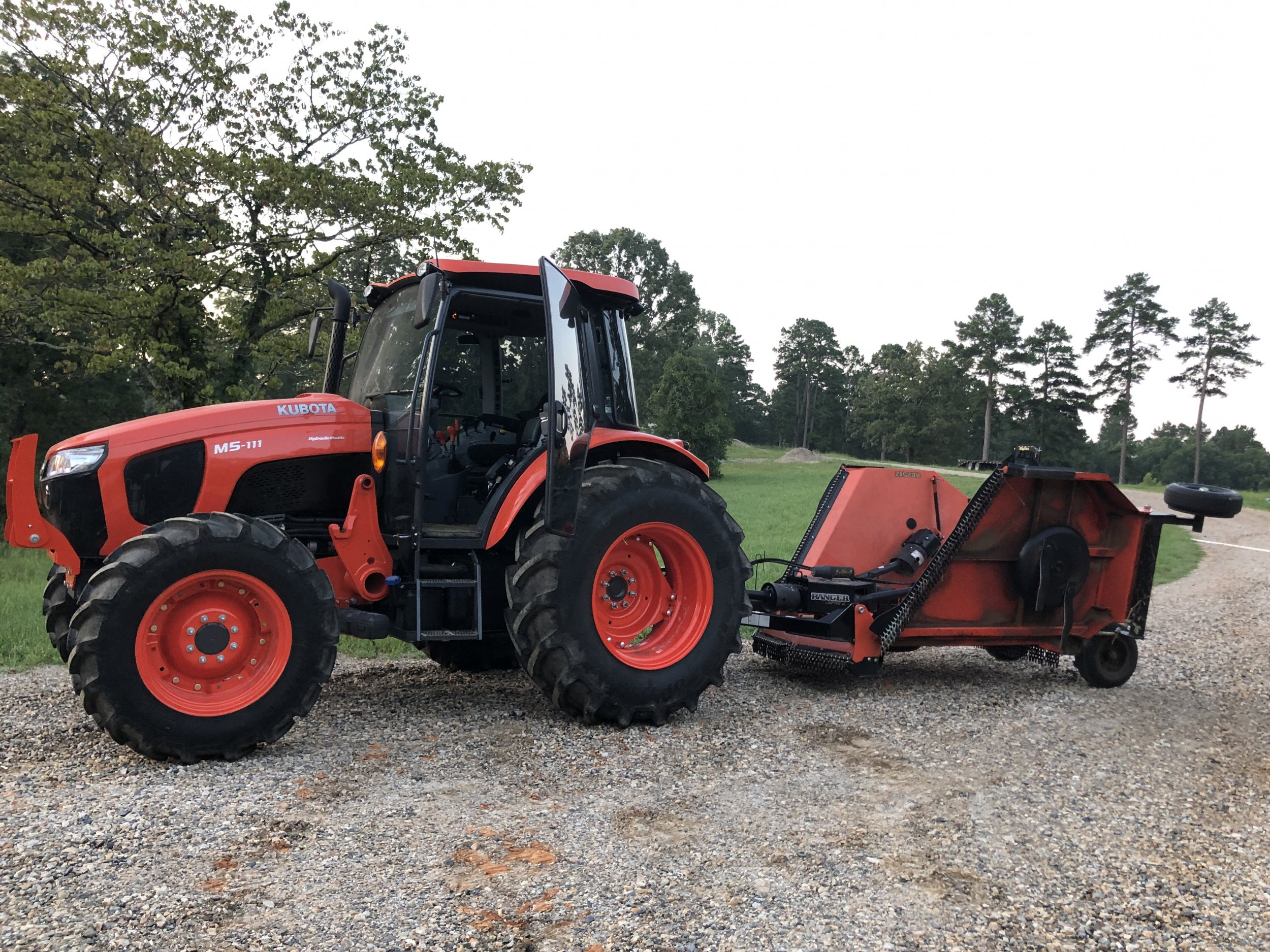

I just went with a Kubota/Landpride 12ft. I had one spindle tranny bearing go out, but..... I tried to mow a t-post with so not really their fault.
What does tick me off is bush hogging & the batwing never can pull up the grass that my tires run over, so the pasture has strips of long grass the next day after a fresh cut! Drives me up the wall.
The only thing I can think to do is buy some blades that have more of a curve on the trailing edge so it might suck the grass up better & give me a cleaner cut.
