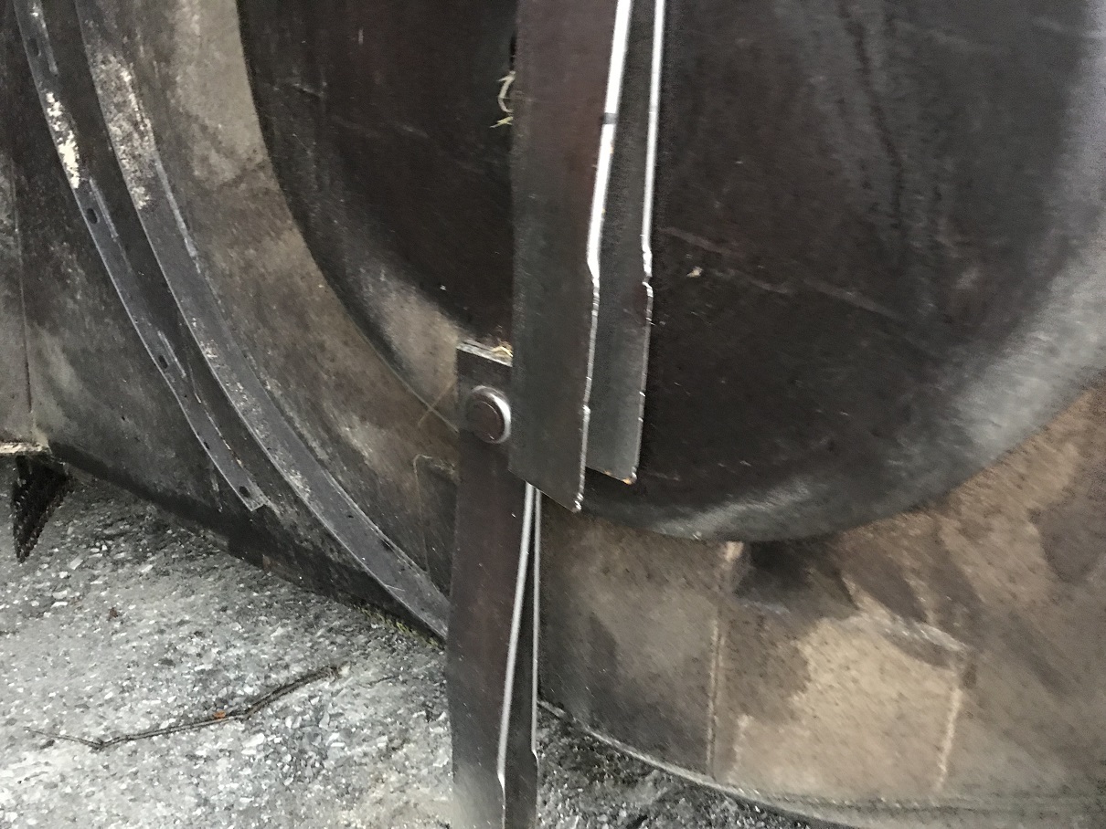

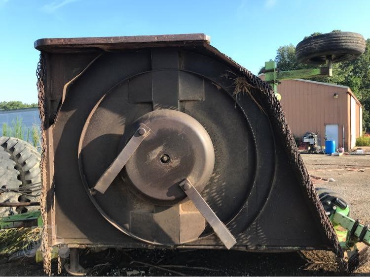

Here's underside of said unit... (been playing phone tag and now, tomorrow,I'm going to leave at 5:30 a.m. to be in a town all day, 2 hours away.
None the less, I don't know what to make of your comments as it relates to the picture. (could this be cobbed together? I don't pretend to know)

   / 20' flexwing behind 1066?
I presumed the double blades were the same as the double knife.... I think I was wrong in that presumption.
