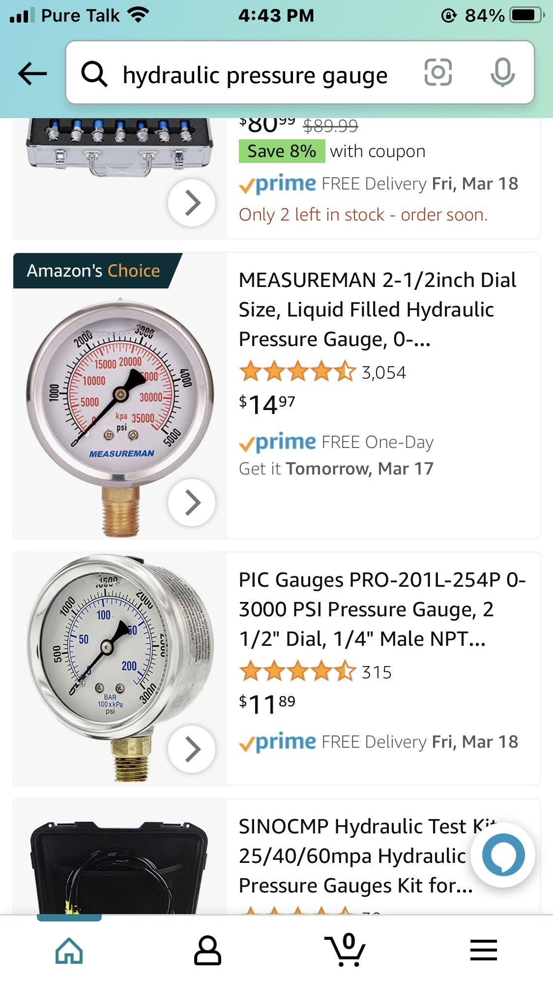

check pressure at one of the loader ports and deadhead the joystick while watching the gauge.
OK, checked at the front curl, 2000 psi, both ports. Checked RH arm 2000psi. Rechecked at both ports on power steering. If I dang near stand on the steering wheel pulling it so hard I barely get a 500psi reading.
So, bad power steering pump?

OK, everything is now tested. I put T,s in on the hose from the trans, then on the hoses going to the front hydr cyl. I have no pressure readings. not even out of the transmission. Oil will drain, but no pressure. If I put the bucket down and lift the front wheels up it still turns, a little easier but not much. My main power steering hose comes out of the transmission. On the parts diagram it is at were the plug is at 61. Any ideals now.
/ 1997 T5C hydraulics Problem #31
looks like the problem is the same as in the link I sent you.

OK now. After a month or so on this problem, with help from people on this site I have narrowed down EXACTLY what the problem is. It is the pump after the gear pump. It is the 3rd section back from the front by the engine. I have heard 2 - 3 different names. The gear pump comes after. Now, with that in hand I have check a lot of sites and apparently mine does not have all the model numbers on it. I have the first part 70111 - and that is it. There is supposed to be more and the rotation on it also. But mine is clean, no numbers and no damage smearing anything. Now, I am tired of messing around with this and I need the machine like last month so I am just getting a new trans which comes with a new whatever you want to call it pump and a new gear pump. I figure that in the long run it is faster. Then I do not have to worry about any of the other parts going more bad than what they probably already are being 25 years old and having had trans fluid used in it. The bad side is the $4400 (shipping included) it is costing me. I should have it by Saturday.
