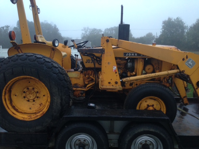

1979 John Deere 301a, PTO, single stage clutch w/ reverser
tractor details
single stage clutch
PTO
REVERSER
3pt hitch

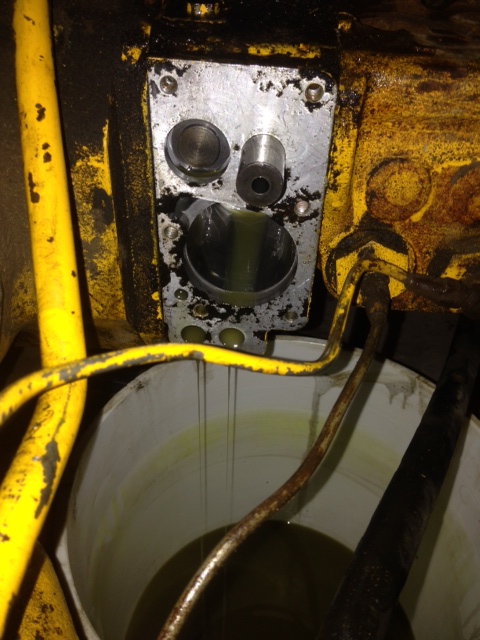

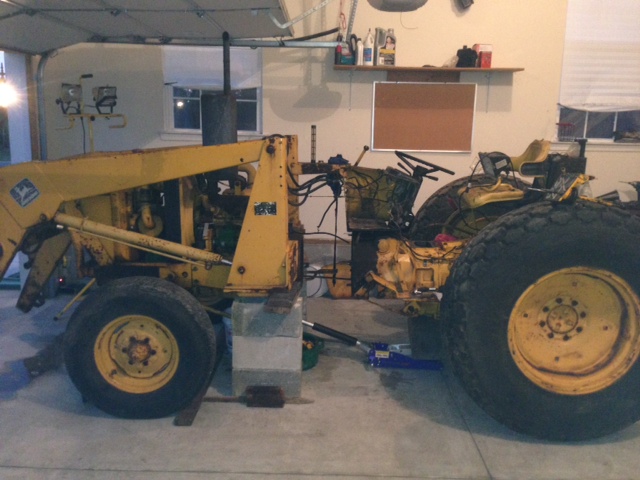

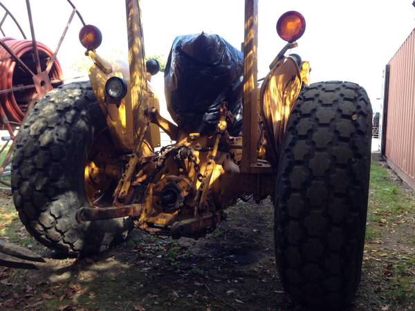

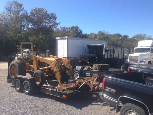

ok, I bought the tractor 3 weeks ago the guy told me the charge pump was bad, within an hour I concluded the clutch was bad. He said, the tractor had just stopped moving and the hydro's had died. he had already changed the front hydro pump and all of the filters. when I replaced the clutch and started the tractor back up, I regained the use of the Hydro's but not the trans (at all) the next night I was able to hook a pressure gauge to the bottom of the reverser valve, the gauge read 150lbs in reverse and neutral (the strange part is, now reverse started working) the gauge went to 24lbs or so in forward. I am looking to verify my suspisions. possibilty A) cracked supply/return line or failed seal to forwared clutch pack? I guess my real questions are because this seems to be a "pressure thing" my clutch pack should be ok? and since I removed the 2 inspection ports on top the reverser valve w/ the tractor running ((not recommended :laughing:) (I had already returned the gauge I had borrowed)when shifting into forward or reverse there was plenty of pressure they both shot to the celling of my garage, lesson learned! lol. that being said, since there is obviosly pressure being sent to the forward clutch pack, the failure has to be between the valve and clutch pack or the return line, correct?

on a side note: I found it very frustrating that hardly anyone ever posted how they resolved there similar issues.

Welcome to the hands-on school for JD closed-center hyd's with reverser. I think you need to buy you a 300 psi gauge from Surplus center for about $15. Have you checked the reverser valve control linkage for loose/sheared pins?

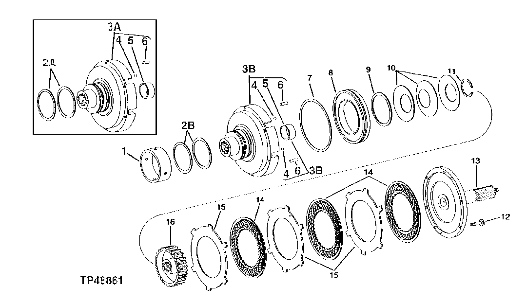

Seems like the most likely problem area would be the sealing rings for the forward clutch. That is what I have found most often. Check key #2 and 2a in drawing. Also the bushing the seal rings ride in wears often also. Key#1. While the clutch pack is out, replace seals #7 & 9 also. This clutch pack is accessed from the same split you had apart for the main clutch. If any of the oil lines need replaced, that is done at the split between clutch housing and trans housing.

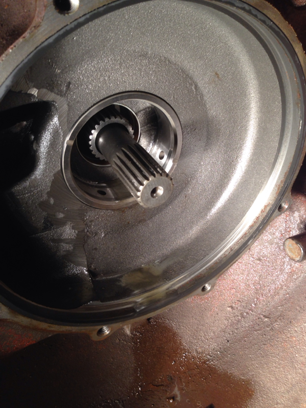

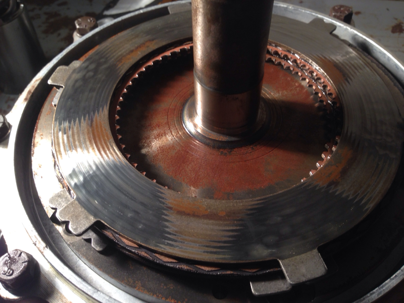

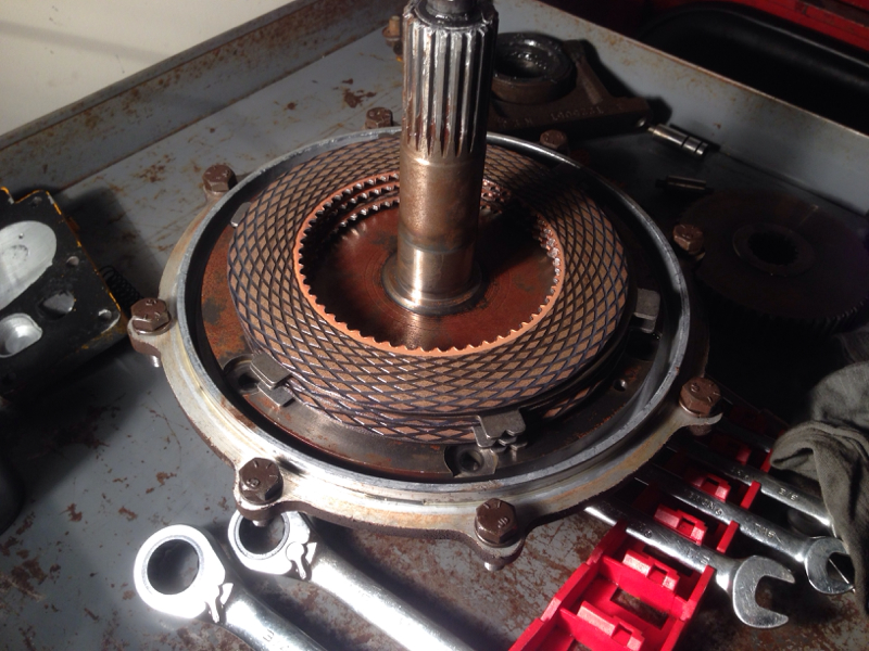

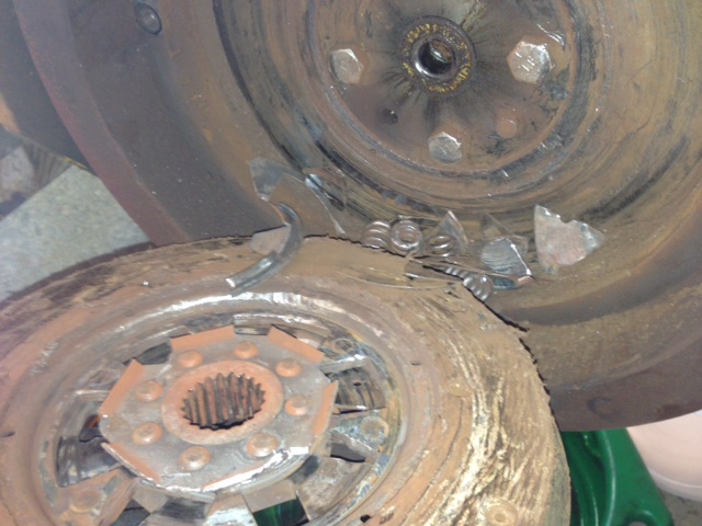

Ok got the clutch pack out, I haft to admit
/ 1979 John deere 301a not going into forward
Ok, I got the clutch pack out, I haft to admit so do the seals ( to the naked and untrained eye) thoughts on the pictures of the discs?

The disks appear to have wear on the splined area. The friction surface doesn't appear too bad. The sleeve in the housing where the seals ride doesn't appear too bad in the photo. Do you have a picture of the seals? Do you have the piston removed from the clutch drum?

I'll take it to work tomorrow and remove the piston. I have a press there
/ 1979 John deere 301a not going into forward #15
Frictions disks should be .112-.118 thick. Separator plates .085-.095 thick. They are supposed to be slightly wavy.
