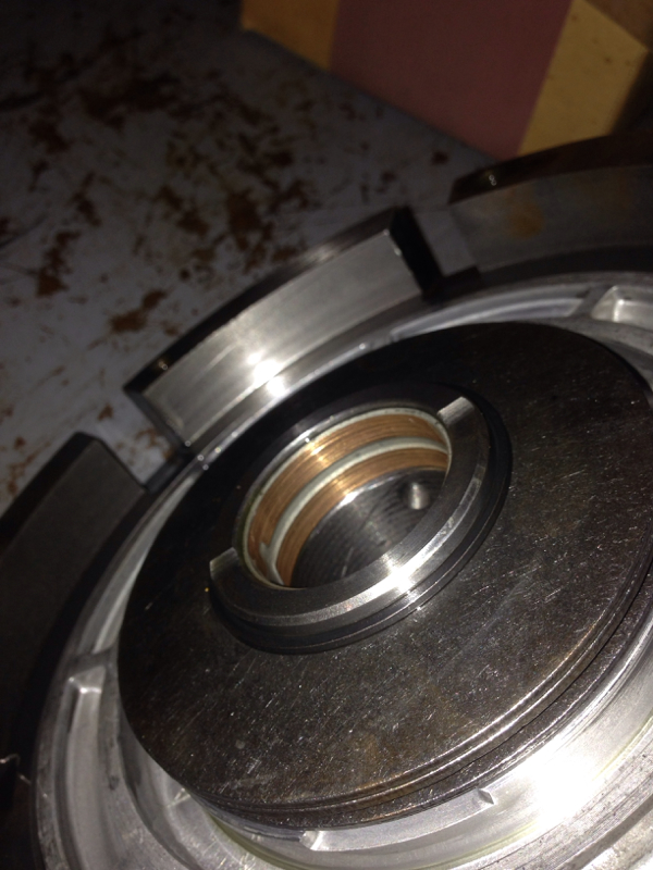

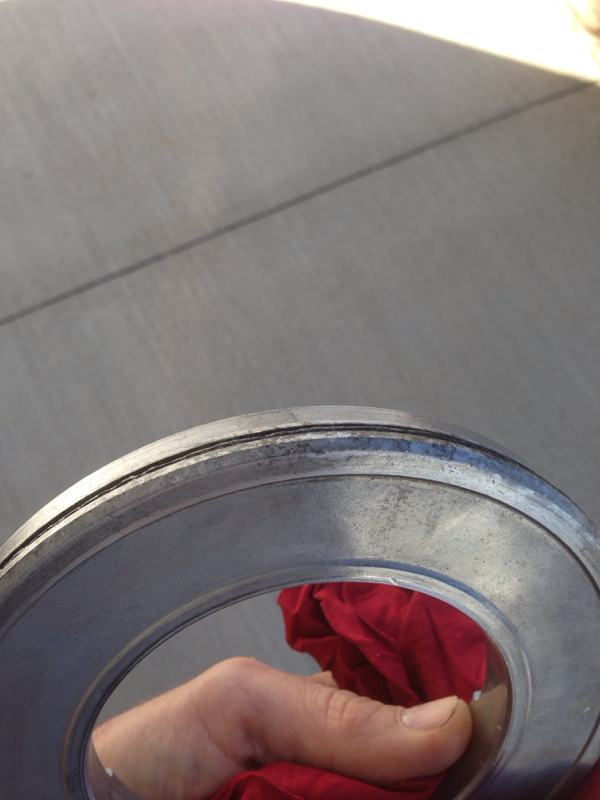

The disks appear to have wear on the splined area. The friction surface doesn't appear too bad. The sleeve in the housing where the seals ride doesn't appear too bad in the photo. Do you have a picture of the seals? Do you have the piston removed from the clutch drum?

Here are some pictures

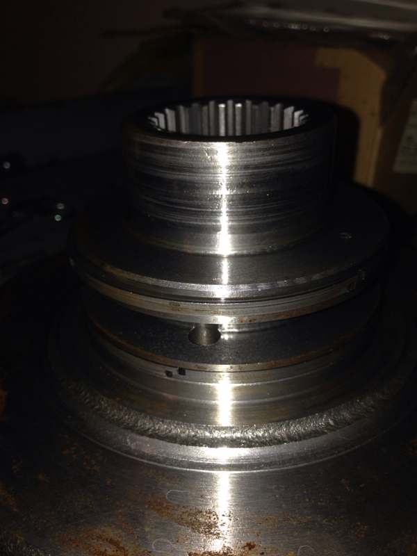

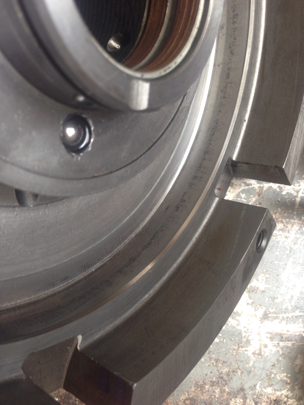

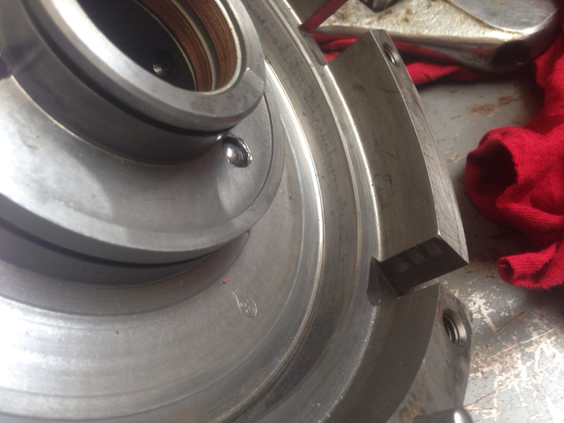

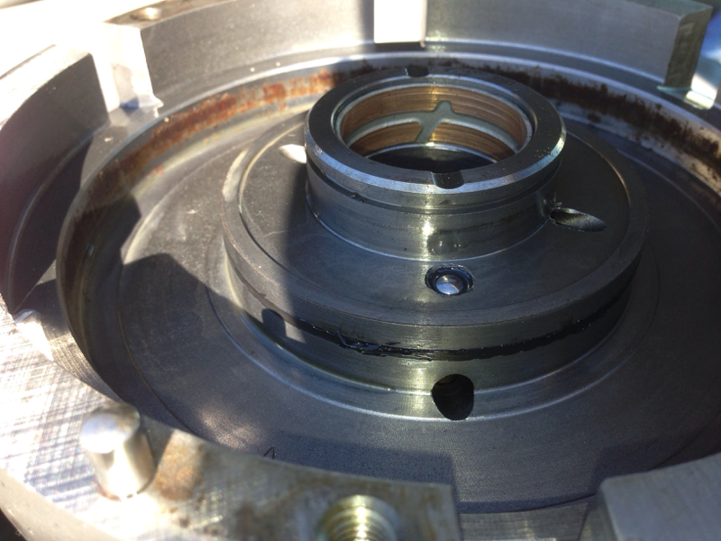

Smoking gun found (I believe ) the seals look pretty bad and note the rust around the inner lip.

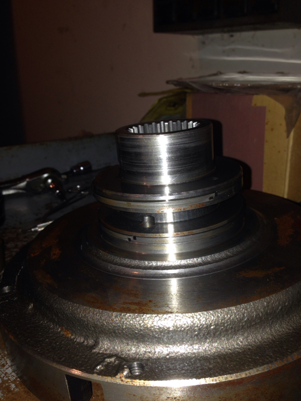

Piston ring

It's not rust on the lip, it's the rubber from the seal

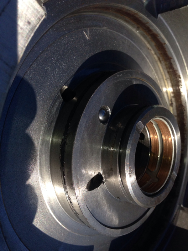

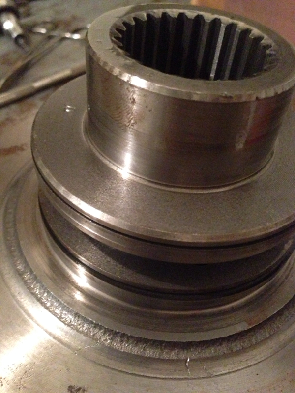

The old outer seal on the piston left a mess on the housing (see prior pics) so I scrapped off as much as I could w/ a razor then took 1000 grit sand paper and lightly sanded it smooth. Should this be ? Should I goto 1500 grit?
