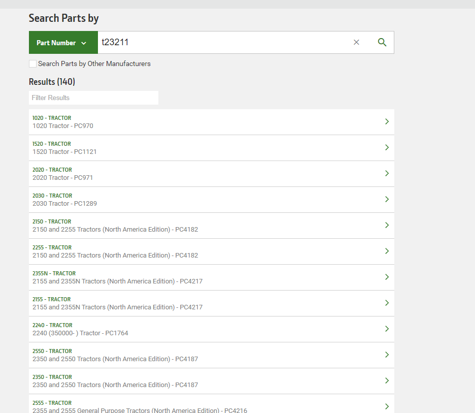

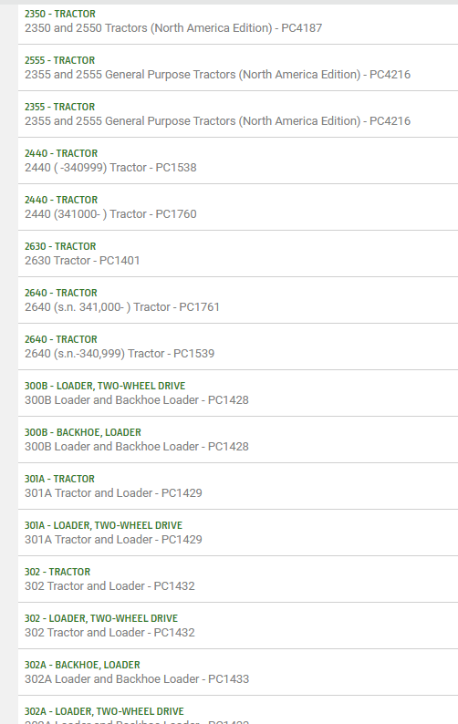

   / 1979 John deere 301a not going into forward #54
Bushing T23211(key 1) has 140 different machine applications including both the 301A & 2640. See attached photos below.
