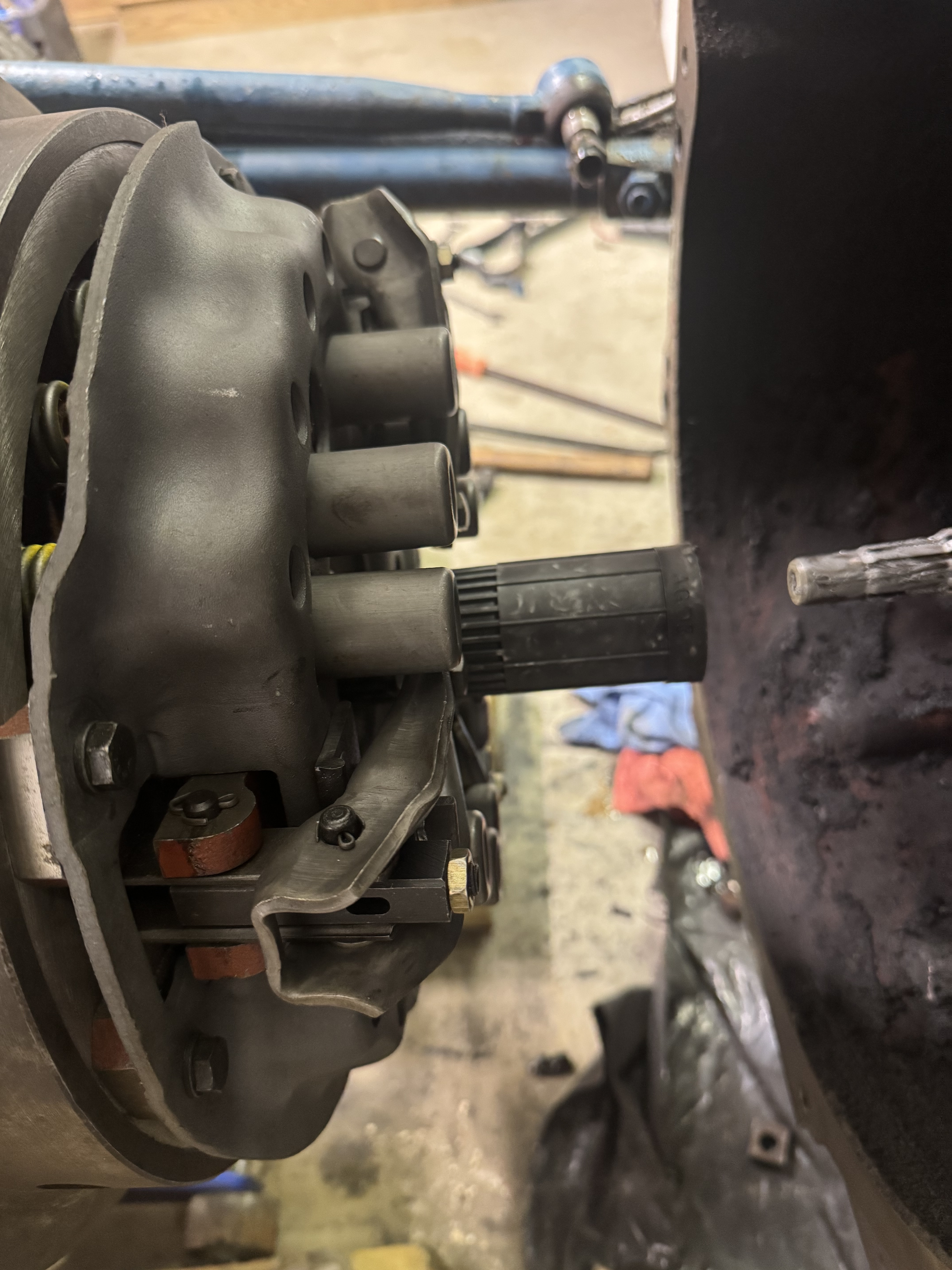

Look at the input shaft splines -like TX Jim posted those look completely stripped off.
Here is a new 3000 8 speed input shaft pic. Shafts and splines do wear had to replace them on my Ford hydraulic pump and the collar as well. Also you can test the input shaft to wheels by turning the input shaft with a chain wrench or slide the old clutch disc on and see that is not positively engaged.
ps. I crushed a pilot bearing once as well by forcing things as a kid on a 1965 GTO. The car still drove but with clutch depressed the input shaft was not being held in true on axis alignment, it also eventually damaged some bearings in the Muncie transmission Take the time to prove the root cause on the power transfer before it goes back together - also turning the crankshaft back and forth a bit and lightly bumping the clutch pedal while getting the pilot shaft to enter the pilot bushing sometimes helps getting the last bit of engine to transmission clearance taken up without forcing things may help.

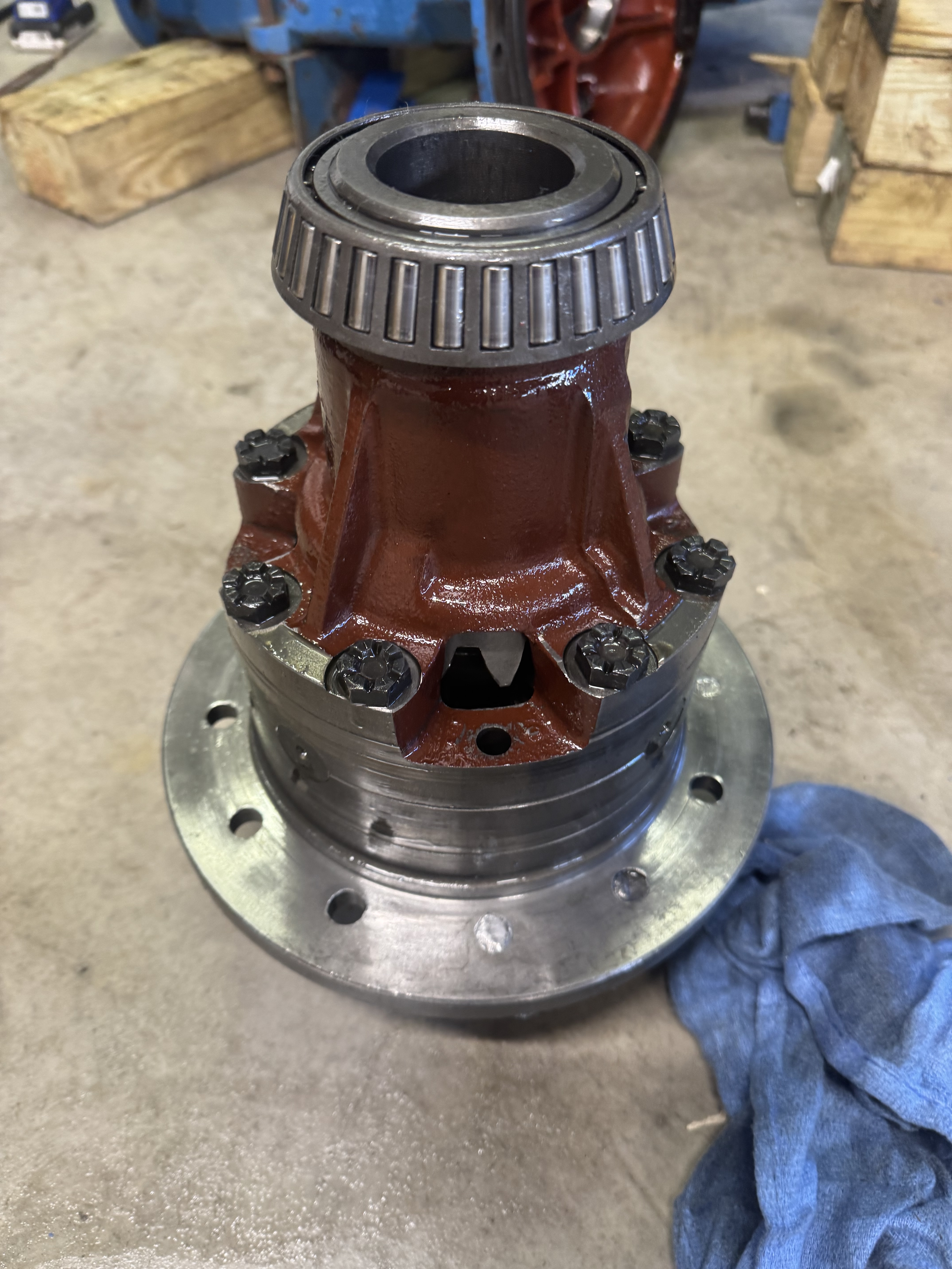

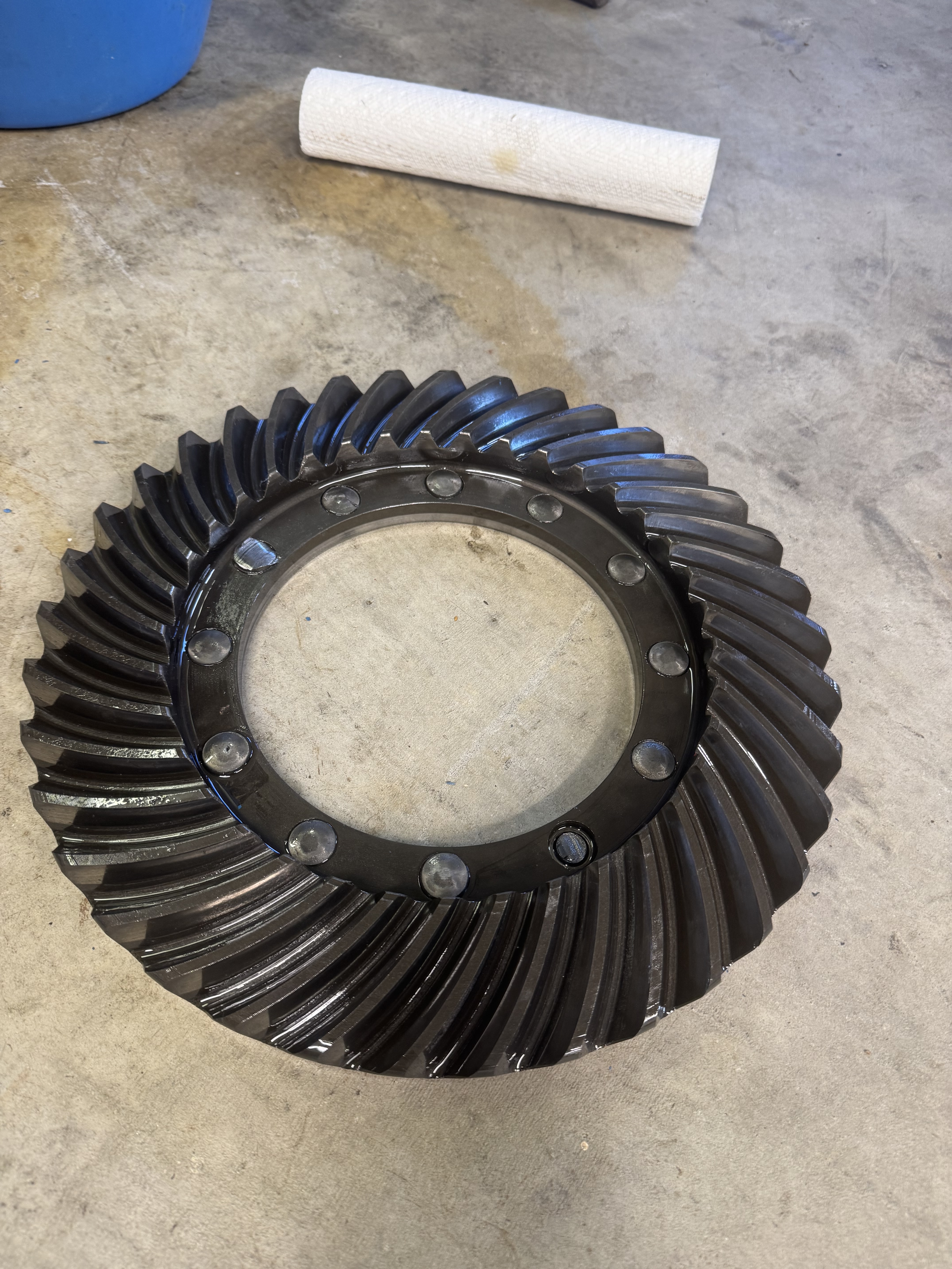

One last question , so turned out it wasn’t the clutch AT ALL , but it’s got a new one now haha it stripped every bolt or stud on the ring gear , have no clue how , but everything else looked great in the rear end , does anyone know what bolt or stud they use to attach the ring gear back onto the differential ? It’s 12 of them

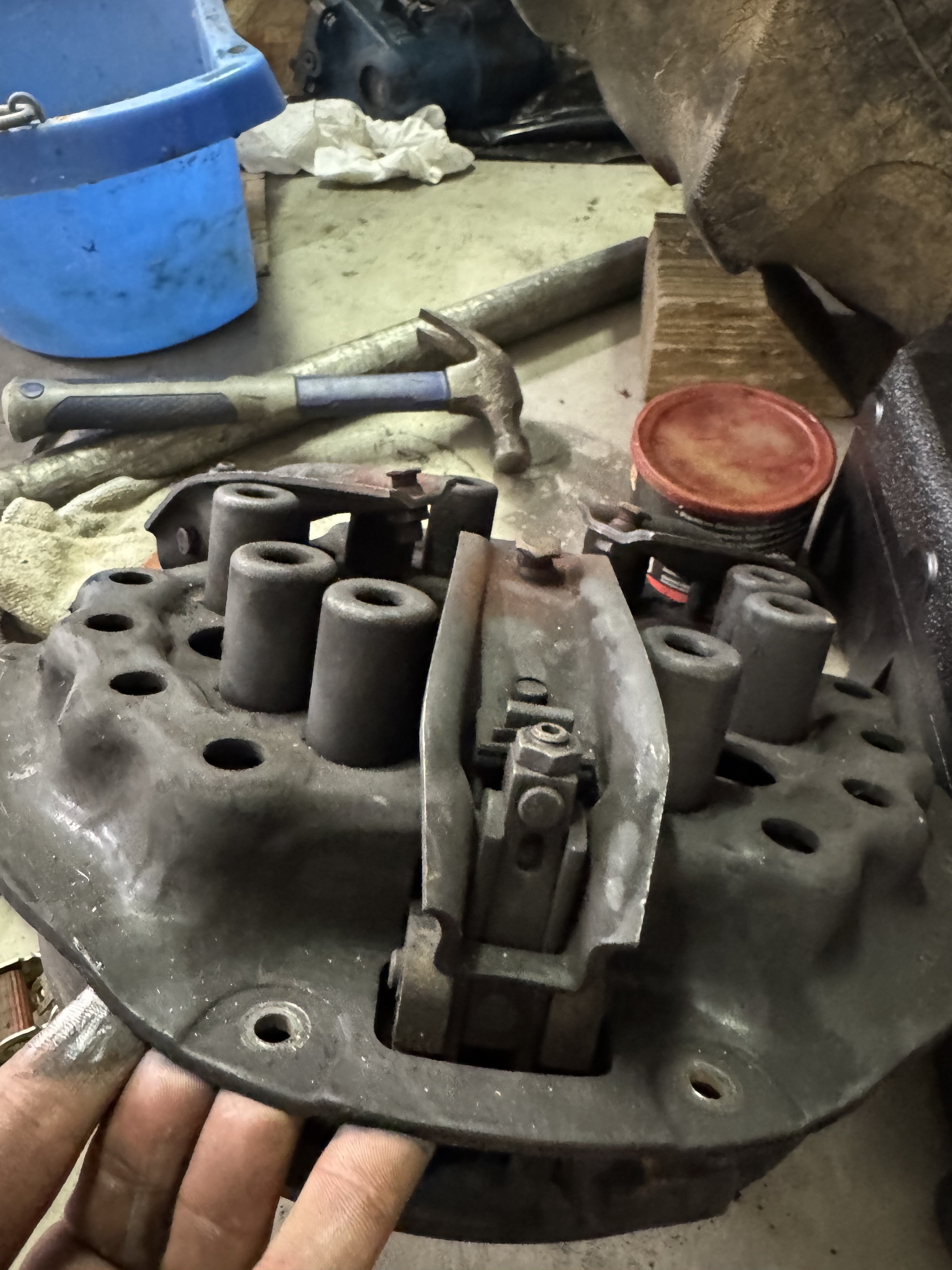

Well I came home from work today and split the tractor again , I can do it with my eyes closed now haha and it is a defective brand new clutch , I can move the clutch forks with my hand so I’m not sure if it just jammed or something broke in it , or I read that they need to be adjusted ? Does anyone know those specs or how to do it or if I need to take it off and have someone set it up , the old clutch fingers are sticking out so it will make contact with throw out bearing but after I split it again the new fingers are in and loose so there is no way it is applying pressure on the disk 1st picture is old clutch and second pic is clutch on tractor now

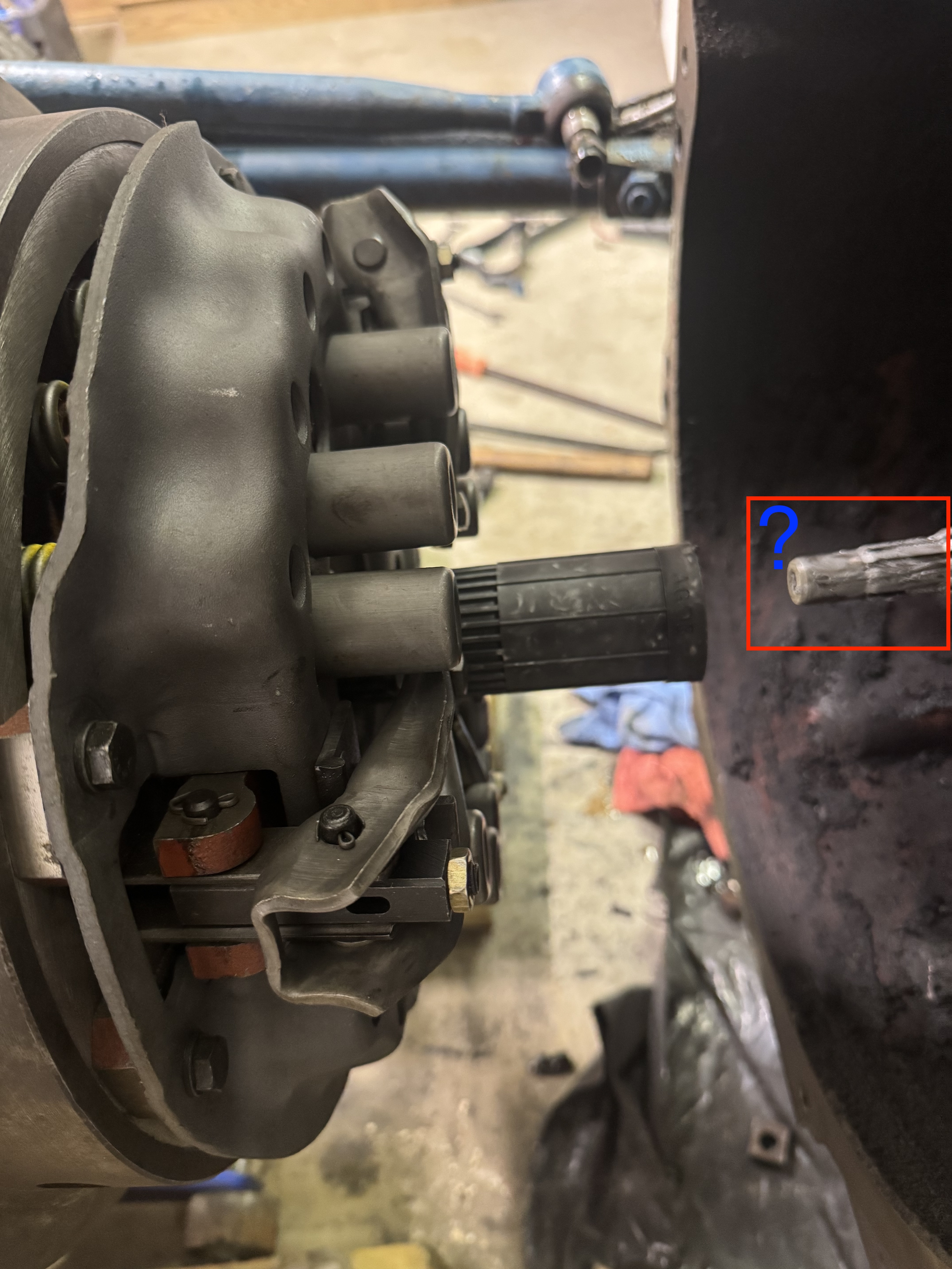

Almost 2 years ago now I was plowing the garden and just one random pass I backed up and then went to go forward again and the tractor hasn’t moved since , no noise no nothing and clutch was pulling good and then just poor nothing , fast forward I split the tractor just got the new clutch in and flywheel resurfaced and the exact same thing ! Still will not move but goes into gear when pressing the clutch in. It feels the exact same as it did so I’m guessing it wasn’t the clutch in the first place , if anybody knows what might be the culprit please help !
Have you checked all the Clutch Linkage? Sounds like a Major Break in the Driveline. Good Luck.
   / 1970 Ford 3000 won’t move but goes into gear #31
I would try the PTO to assure you have power back through the rear end. A fellow had a similar problem on one of these forums several years ago. I had a hunch he had a broken axle and asked him to apply each brake pedal separately at a time and sure enough the tractor moved. But this was on a Farmall Super C where the brakes are on the bull pinion shaft.
Being your Ford's brakes are on the end of the axle, not sure how you accomplish stopping one axle if it is broken between the differential and brake. If it had a differential lock to make both rear wheels turn that would be a different story, but don't believe the 3000 had a differential lock. None the less, guessing you may have a broken axle on one side or the other.
This is a good point. My uncle had a 3000 and there was a diff lock pedal on the right side at the back of the foot board. If you press that pedal with it in gear and running the tractor should move and would point to a broken axle being suspect.
   / 1970 Ford 3000 won’t move but goes into gear #32
Sounds just like my old Ford 8N that let me down twice when I owned it. The tractor broke a rear axle shaft in half. There was no noise, no jerk or anything. Jack up one side and spin the tire. You will know if it is connected to the rear end or not. If you feel it turning parts inside then let it down and jack up the other side. One-time I even sheared all the ring gear rivets. PS: I should have read all the posts before replying. At least you found your problem. I used grade 8 bolts and nuts on the 8N ring gear when it sheared the rivets.
   / 1970 Ford 3000 won’t move but goes into gear #33
I’d be careful of putting in too strong of a bolt in there. I’m assuming they are also a shear-pin type of device, maybe not. Grade 8 will hold for sure, but what else might break from a torque overload when those don’t give? I use the softest bolts to hold auger bits on the post hole digger so they shear before anything else gets broken in the drive line.
   / 1970 Ford 3000 won’t move but goes into gear #34

One last question… does anyone know what bolt or stud they use to attach the ring gear back onto the differential ? It’s 12 of them
Never had any tractor apart to the degree you have now… however… I have replaced the ring gear bolts in the final drive on the sidecar shown in my avatar… the factory had recently gone from grade 5 to 12.9 as they were having issues with the #5 bolts shearing and tearing up the case…
The new bolts were installed with red loctite per manufacturer recommendation…
My guess is: the ring bolts aren’t a sacrificial fastener…
   / 1970 Ford 3000 won’t move but goes into gear #36
Could have been a cascading failure where either they weren't torqued correctly by the factory or previous owner or one or two bolts were defective or... the bolts were over torqued.
If one or two fail the rest are doing all the work and then they let go.
I wish that I could remember what I used 40 years ago for bolts. These bolts are not supposed to be sacrificial. All that I can say is measure the holes and get bolts that will fit fairly snug in the holes. The ones that I used had no threads where it went through the housing and ring gear. I also used LocTite on them.

It was a major break , it had broken every stud in the ring gear on the differential haha going to get new bolts today and should be good !
