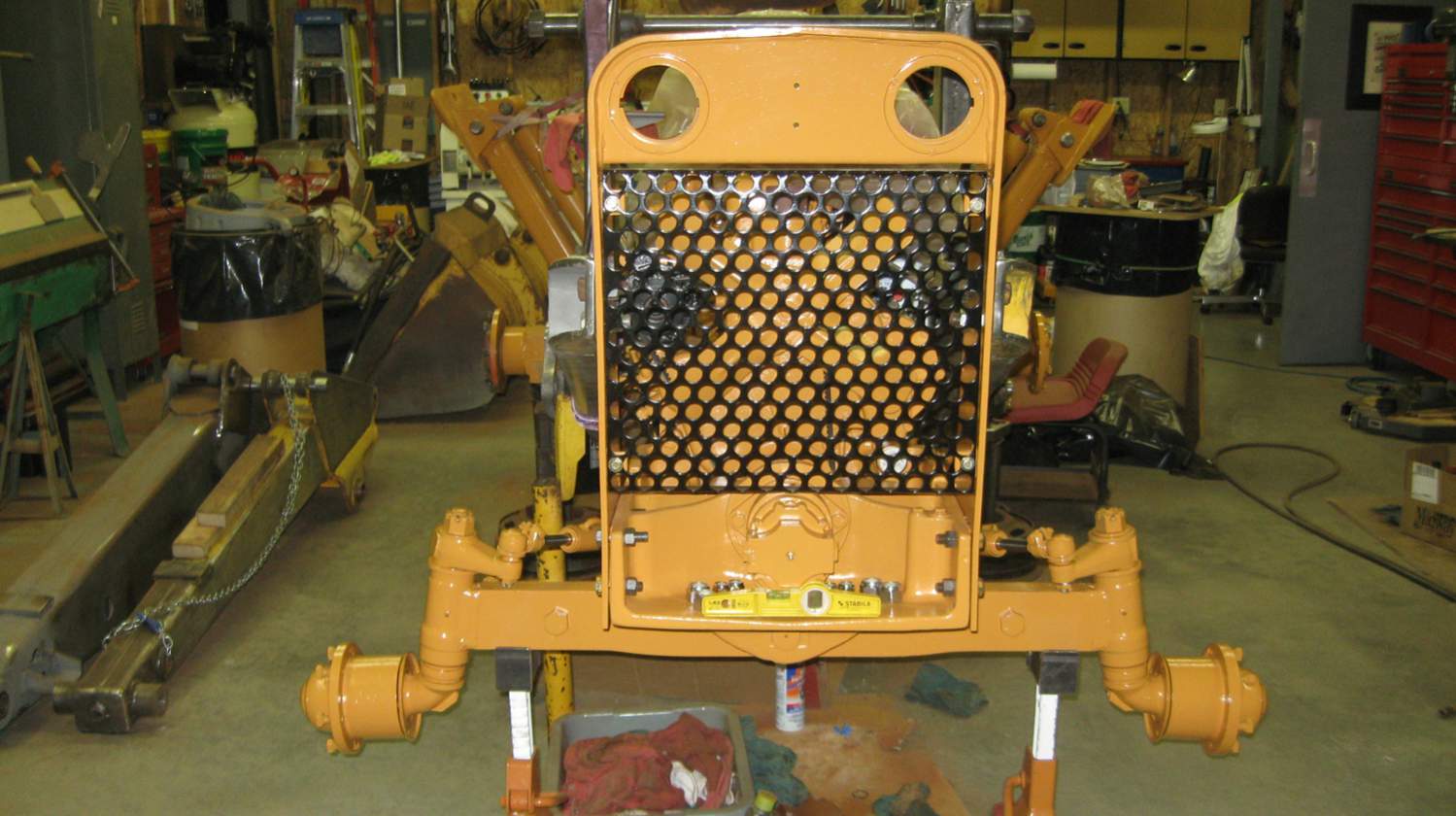

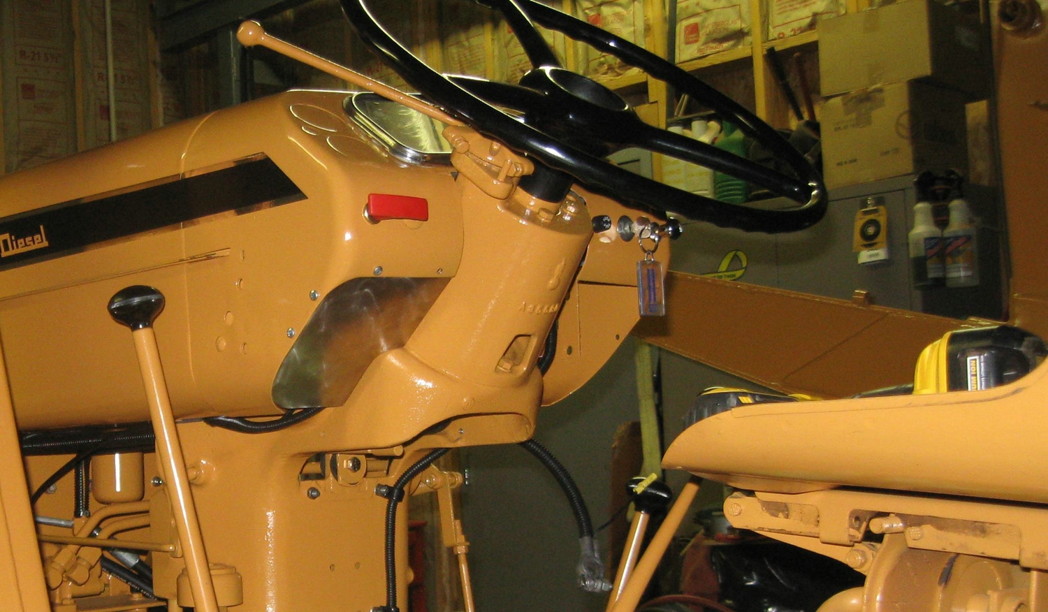

Thanks Terry for the very kind words. It really has been fun but labor intensive and time consuming project, I'm working on several new picture presentations with description posts and will be putting them up shortly. I'm going to be taking a bunch of pictures of the backhoe outside in it's no scratches condition before I operate it, because I know it will never look like this again! I'll share a series of these too.

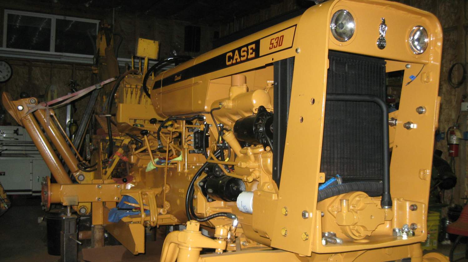

Very nice! Would you be able to post a short video of it running when it's ready?
/ 1963 Case 530CK Backhoe/Loader
#125
Well Mancelona Man, another forum member ask the same question earlier in my project. I guess I don't have any qualms in posting a video, but I have never done that process before and don't know what it entails, so I'm open for suggestions. As of now I don't own a movie camera, but was considering one of those new Go Pro types. But, I don't have a clue as to how to post a video. I suppose I can research the internet and check YouTube. I just have never had a reason to do this before now. Thanks for the question.......

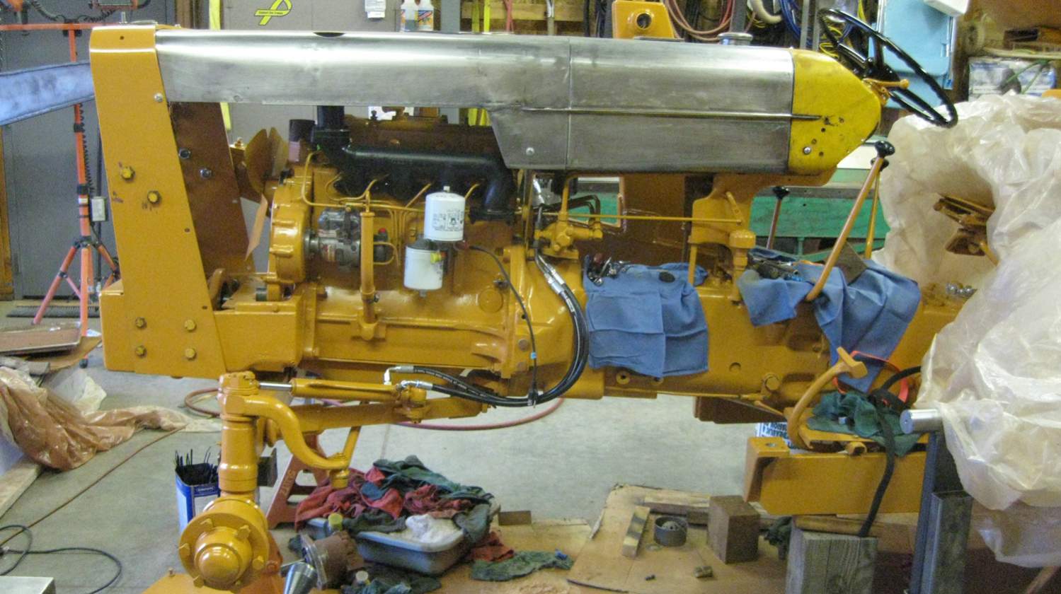

Here's one taken late this afternoon.
/ 1963 Case 530CK Backhoe/Loader #127
Better than new! Great job!
I agree^^^, most times when a full restoration is done the machine IS better than new.
My only concern would be with clay type soils the narrow bucket could plug up. That said the existing bucket is much larger radius than on my 110 and should dig faster.

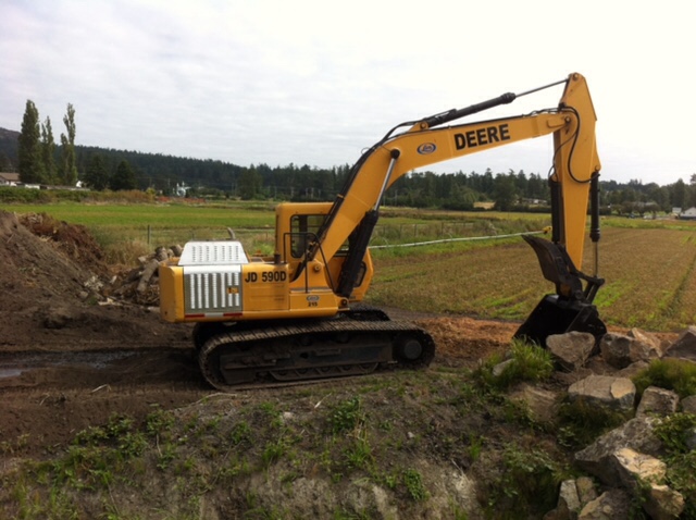

I find it helps to not "curl" so much to totally load your bucket. Try to dig flatter (like following the bottom of the trench) as looser material will fill the bucket.
This may seem inefficient as opposed to taking one big scoop while curling but then shaking the bucket to unload is also.
Another thing that works sometimes is stop dipper travel when the bucket is half full. Reverse direction a few inches then continue filling the bucket. This may help alleviate some of the suction in clay.
Here's my JD resto. Not as nice as your Case. :)
Terry

Hey Big Barn, thanks for the picture of your excavator. And I'll tell you what; it looks every bit as good as my resto! You also had a much bigger job as well.
And your suggestion to not "curl" so much I have tried when digging. You know there are so many little tricks that you learn along the years that a guy adopts and really don't realize you are doing it as you are doing it. I worked around this one operator back in the 70's & 80's and he was just like watching a ballet dancer at work the hoe was just an extension of his hands and arms. I could never hope to work at his level but he taught me a lot over the years...... just watching him as he moved dirt!

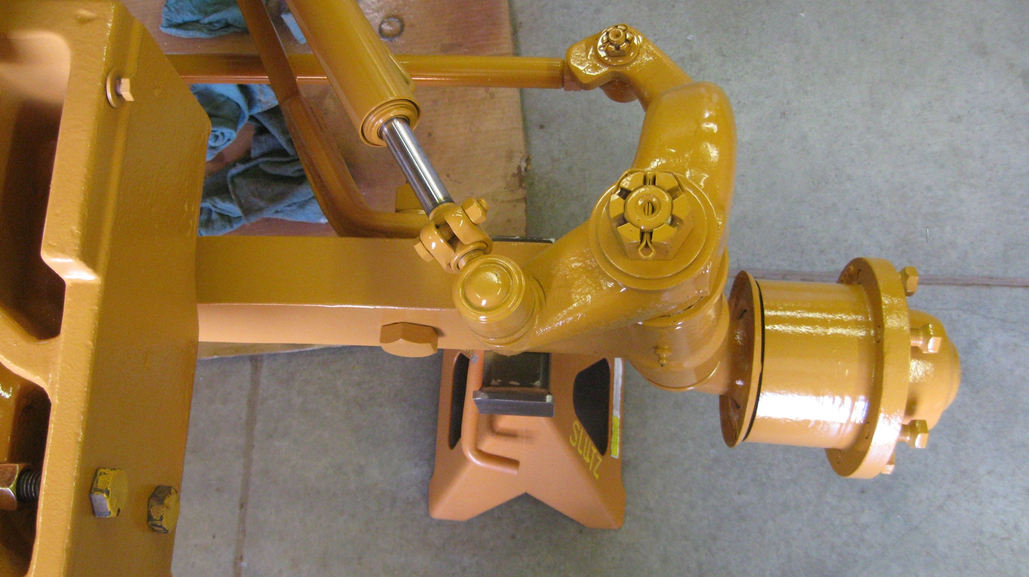

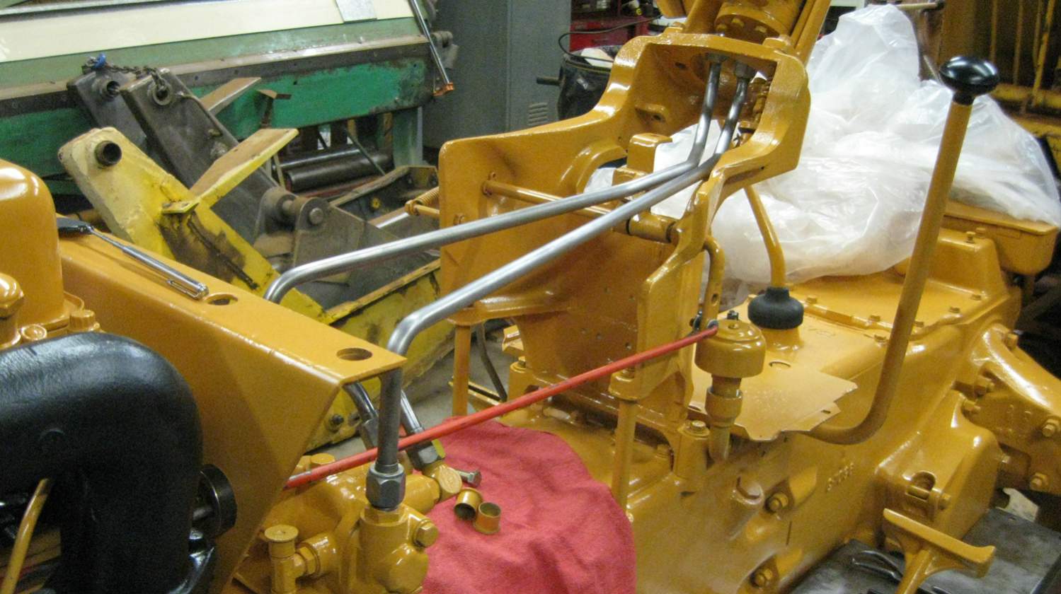

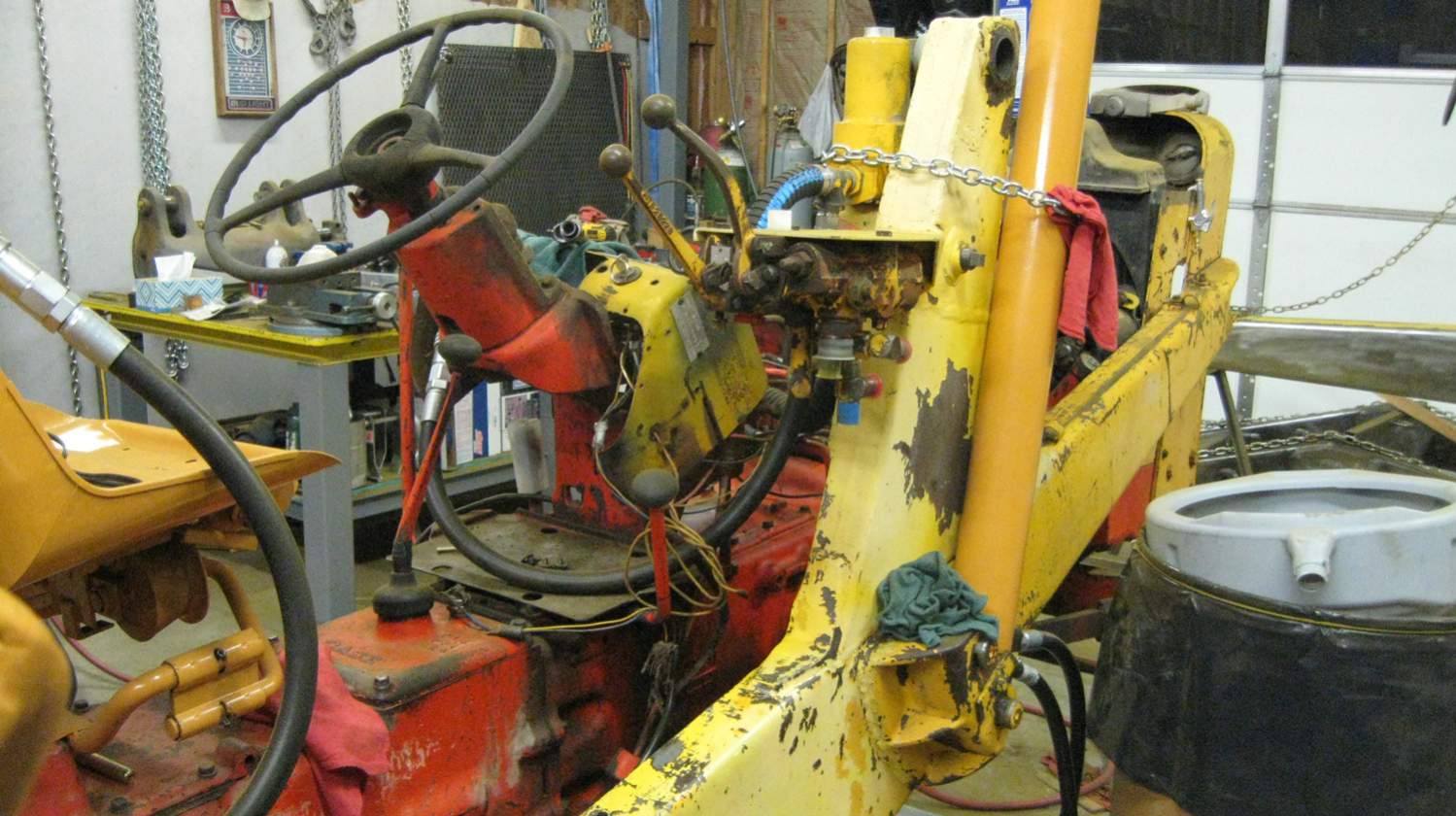

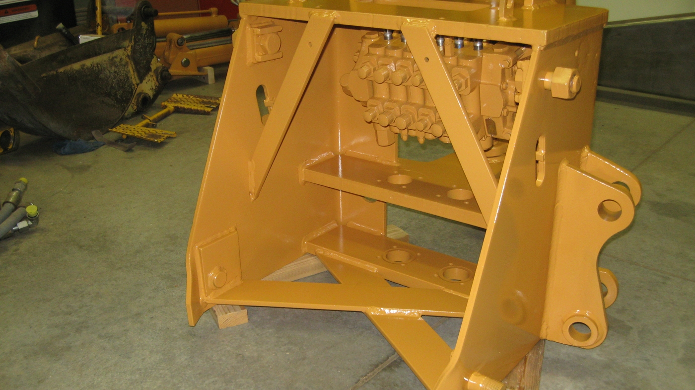

Here are some pictures of the backhoe main frame housing; cleaning, prepping and painting.... My overhead crane was really indispensable for this part of the restore. The metal is so thick and massive that you just can't maneuver it for all the operations that I needed to do, without an ability to lift, swing, tip the part.
This is a shot of the housing upside down and I was stripping paint, chasing threads and prepping for later welding.
Most of the paint off the sides, then lacquer thinner was applied by rag, to clean any remaining grease and paint dust off. I used these really neat paint removing disks on my 4 1/2" angle grinder. For me, it was less messy than liquid paint remover and faster to remove paint and rust.
Just a shot of the right side and still upside down.
Ok, I now have the housing cleaned up and back over behind the tractor, and checking the alignment of the two bores that connect with the tower. Somehow, the upper flat had been bent up and by using a solid straight piece of round 2"bar I was able to see the problem. The lines on the flat shows where I had to heat it, then bend it down for the final alignment. Man that thick iron soaked up the heat. I turned up my largest rose bud tip and it took a long time to get it to a bendable temperature.
This one shows how much it was off. The bottom (self-aligning) bushing was in it's housing and 2'' round bar was about 1/2" off of the bore. I have no idea how you bend an over 1" thick flat stock. It's just that after installing all the new bushings nothing would line up, which means that there was an awful lot of play in all of my connection and now I know why everything was so loose!
This one is just for perspective, show how I was using the crane to align parts.
After machining the pins, bushings and such I now have the right tension set on the bottom pin-bolt and it really rotates nice!
Got the valve body cleaned, painted and bolted up, ready for the levers.
This is a good angle of the boom holder that I designed and fabricated. It really came in handy as a crane connection for moving this part around. It made it so that I didn't have to scratch paint with my lifting chains as I was positioning the heavy thing.
This picture is just showing it's time to hook it up with the docking bars on the tractor.
I've got several more posts that I'm working on to show you guys before I make may final presentation and maybe I'll still get another one out later today, thank you all again.....
