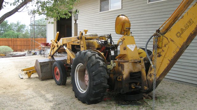

Just thought I would see if anyone here would be interested in my 1963 Case 530CK restore project. Been working on it for the last several months and have gotten quite a bit done, but still have a long ways to go! It will include pictures of all the processes that I am doing with before and after pictures. I bought the hoe in 1998 to build my shop and it had been rode hard and put away wet. Was not able to fix and repair all the stuff back then because I had a regular job and there just was not enough time to do it then. After I built my shop in 1998 I fabricated an overhead gantry crane that spans and runs the entire length of my shop with 2 ton electric Coffing hoist. The crane is really great for picking heavy parts off of the hoe and loader.
Since 2012 I have been retired and did not get started until this summer. I had to fabricate and machine a lot of parts, also flush off old welds and re weld and fit up some of the structural frames and such. I though some of you might be interested in a running account of my project.

Well, thanks for the interest.............will not send too much at a time, but I do have quite a few pictures that I have taken along the way and intend to take more as I finish more steps.
Here are a three to show how it looked as I started:
Here shows the stabilizer area after I removed them and before I cleaned it.
Here is one from the front.
This one shows what the previous owner had put in the bucket links.

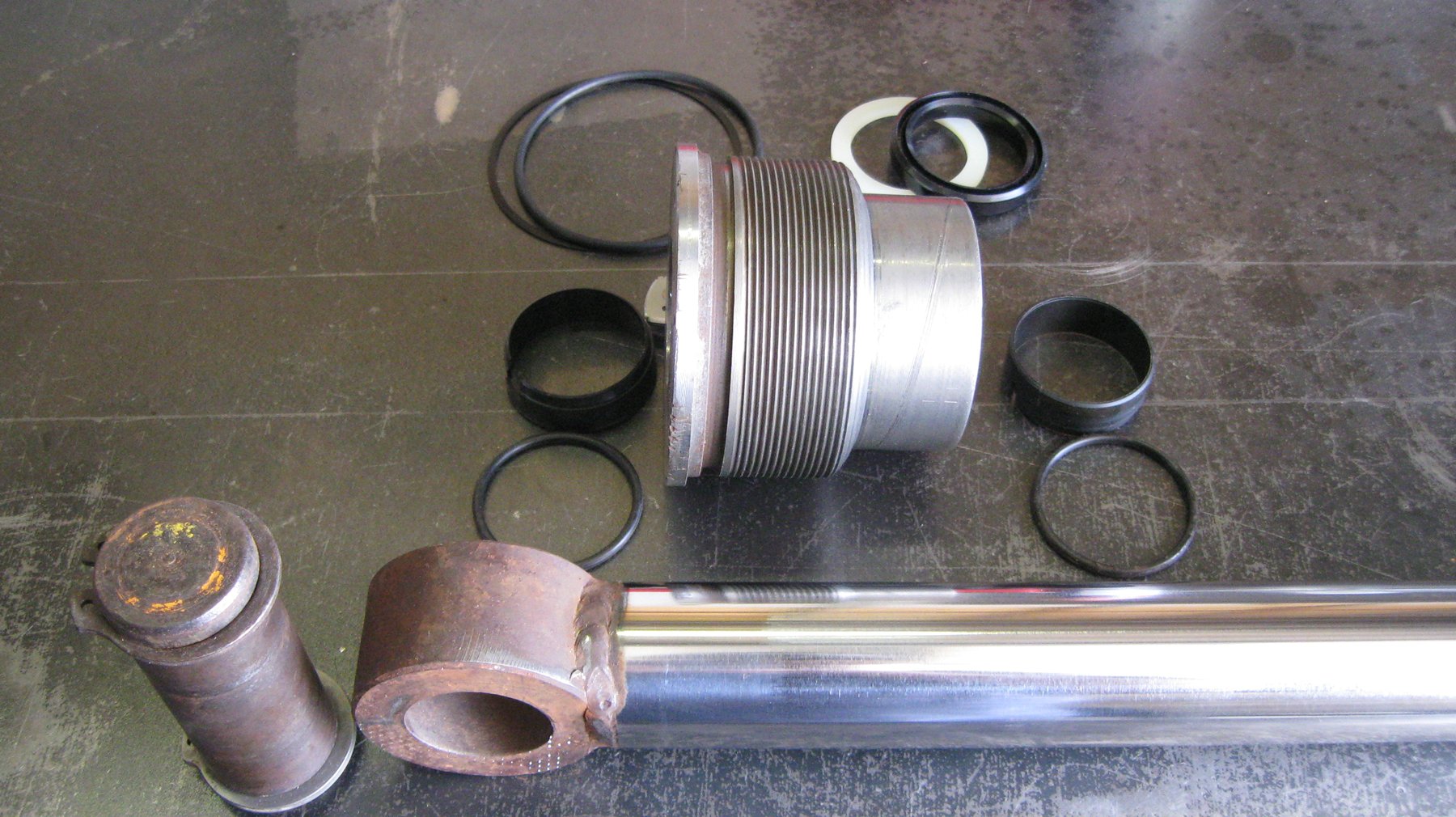

Well this is the first installment with more to come. I decided to start with a cylinder rebuild for the stabilizers since it was one of many parts that I was trying to 電ry up the bleeding of hydraulic fluid. Almost everything on the tractor was leaking and not one of the cylinders would hold its position after shutting down the hoe. Also for those that have not rebuilt a cylinder; this will show you the components and maybe illustrate how simple a cylinder is.
Here is the cylinder completely disassembled. Of course, the rod with the boss on the end where the pin connects to the stabilizer is front and center. On the left is the gland nut with an assortment of seals and wipers.
Close up of the gland nut and the seals and wipers
This one shows the metal washers that sandwich the packing which is spread out above. That center fibrous looking washer helps the piston (when installed in the cylinder) to ride gently on the cylinder walls and keeps it from binding up.

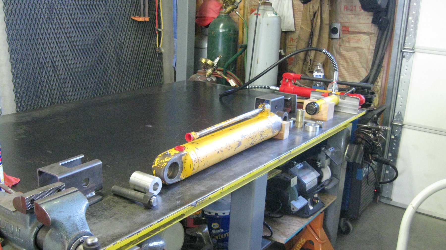

OK, this is the set up that I fabricated to assist in re-installing the piston back into the cylinder. The piston packing can be quite stiff and will resist normal efforts to push it back in, even with lots of lubricant. I used a port-a-power type horizontal jack and pump to facilitate the procedure. You will notice that at each end of the cylinder is an assortment of pins bushings and square tube boxes.
A view from the other end.

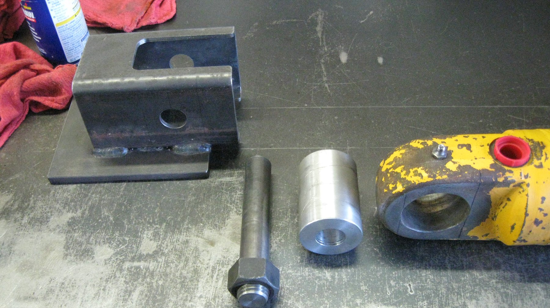

A close up with all the parts needed to hold the port end of the cylinder. You will note that I welded a shoe to the box tube so that the pin bore will always be oriented perpendicular to the axis of the cylinder. When re-installing the cylinder it just makes it so much easier to then install the pins. Once the piston packing is in the cylinder it is pretty hard to rotate it into position.
Since there are different sized cylinders on the loader/hoe it follows that there are different sized bosses connected the rods of those cylinders. So, I machined different sized bushing to fit the different sizes. You will note that I stitch welded a shoe or plate onto the sq. tube to keep the orientation with the port end.
This is a view with the whole set up together to show you how I trapped the cylinder between the jacking device and one of my vises farther down the fab table. If I have a longer cylinder, I just unbolt the vise and move the block to the other vise even further down.
It is a simple set up and really saves time!

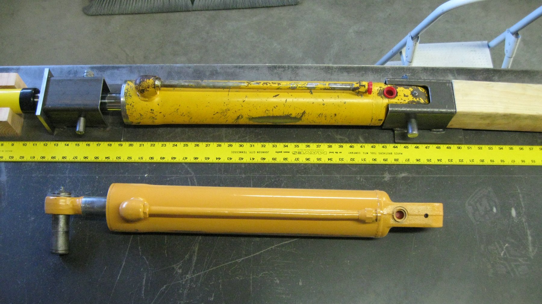

This one show an over view of a cylinder that I just finished and painted and one in the (set up) and a rule to give some perspective to the size. The metal tubes that connect the hydraulic lines were bent up like pretzels, but with a little work with mandrels (matched the I.D. of tubing) and a machinist vise and small hammer I was able to straighten them out again. I have had to chuck up in my lathe most of the gland nuts and re-face the ends then re-bore the シ holes because of the damage caused by others that did not use a spanner to unscrew the gland.
/ 1963 Case 530CK Backhoe/Loader #12
Very professional rebuild, you obviously know your stuff.

Very nice! Did you also hone the cylinder or was there no scratching in it?
#16
Good question ThomasH. You know I only had to hone one. It was the right stabilizer cylinder. I'm speculating, because it did not happen on my watch, but I think a stone or something got caught between the cylinder and the stabilizer leg. With the tremendous leverage that is generated by the cylinder when retracting it put a dent in the cylinder. So I designed and built a device that slides into the cylinder with a pancake jack attached that exerted pressure from the inside but spread out the force in the opposing direction so as not put a crease or dent. When I had finished I honed it and it works perfect with no sticking.

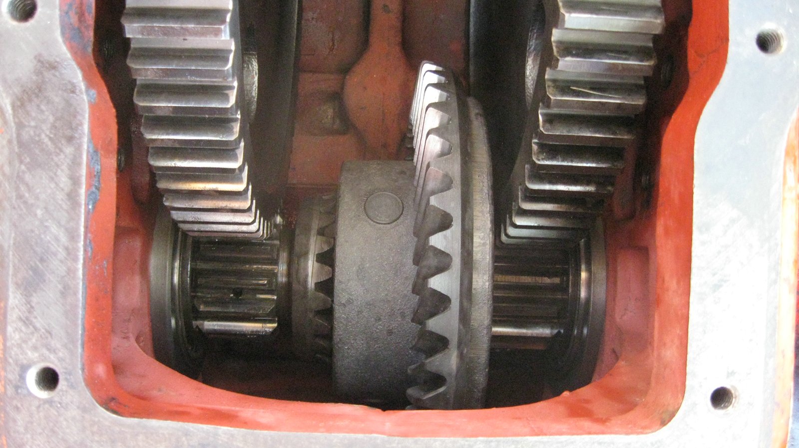

Second Installment:
I had to repair and rebuild the damaged axle bearing and bull gear before I could move the tractor into the shop. When you are working outside, a guy cannot control conditions and that makes the job even harder. Even though I had gravel as a surface to work on, nothing beats a 7 inch slab of concrete!

I included this one to illustrate how the ring gear and small spur gears on the stub axles mate up to the bull gears. For those of you that haven not gone into the tractor this far, those stub axles extend through the final drive for the disk and band brakes to attach to. When you do a brake job this is what is on the other end, the spider gears are what allows the other shaft to continue to move while the brake is applied on one side or the other. That makes for a nice turn in tight places.
Cap to the final drive, made a new gasket, then re-installed. Time to fill up the housing with gear lube and get the hoe moving toward the shop.
