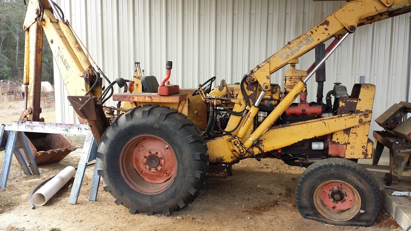

Not yet convinced that it's a CK, though I do know that it once had a FEL (sold off, sadly, prior to my ownership). Still trying to pin down the precise year. Help is welcome. =) Here's my girl.

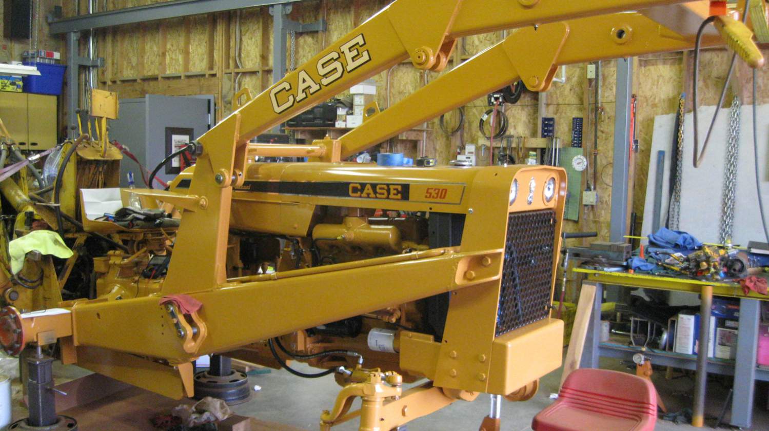

My last picture post, addressed the swing cylinder rebuild and machining parts for the cap pins and trunnion bushings, so to bring you up to date on some of the things I've been doing on that end of the tractor, I've decided to show you what I have been doing to restore the boom and it's parts. Got real busy with a lot of projects and side jobs, so it has set this project back a couple of months, so I know it's been some time since my last post.
I designed and fabricated a set of arms to hold the boom and stick (some call it a dipper) and the bucket when it's stowed or in it's full up position while using the loader or transporting the machine. As most of you will recall; the boom on a 530CK came with a chain on each side that one could hook up and hold the boom in the stowed position. Most of the hoes that I've seen have the chains busted off or discarded. So I tried to come up with a useful solution, you can be the judge as to whether I succeeded or not.

This is what it looks like in the first fit-up. I had to get the correct sizing for length between brackets and pins or the boom cylinder would not lift far enough for the hook to engage the pins. It was sort of trial and error.
You can see here the nut and washer that I explained earlier how that fit and visually see what they do. After making one up, I then clamped both up together so that my final machining made them identical.
Just more of the fit up process.
The hook end and this picture shows how the 2 pieces steel welded top and bottom thickens and helped form the final shape of the hook.
I just included this picture to show the over-all function of the device. The overhead crane was indispensible in the raising and lowering of the boom!
Side view.
Close-up of the connection and frame brackets.
I had to use my hand fall to lift and manipulate the boom. My Coffing electric 2 ton hoist would not lift high enough to bring the boom up the distance that was needed, slower than electric but what a man saver.
OK, here is a final fit up before tack welding and final weld.
This shows the cross bars and stiffeners in the final welding. All that is remaining is to pull the shaft out cut it to length then groove both ends for the snap rings and get some paint on! :thumbsup:

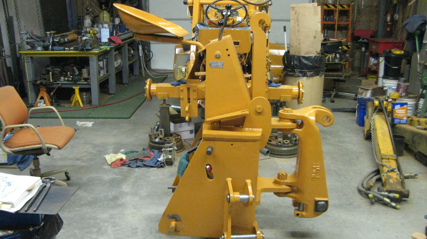

Well here are a couple of teaser pictures. I'm going to pick up where I left off with my presentation and submit a more detailed image of the finishing process. You guys have been so patient with my slow posts, that I feel I owe you the rest of the story!
I was able to get the wheels and tires on, so it looks like something that actually works.
One at the front, it almost looks like a face, huh? More to come.......
