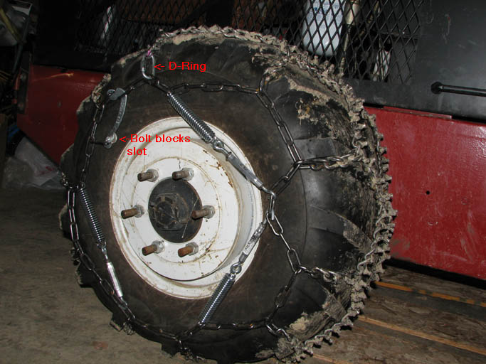

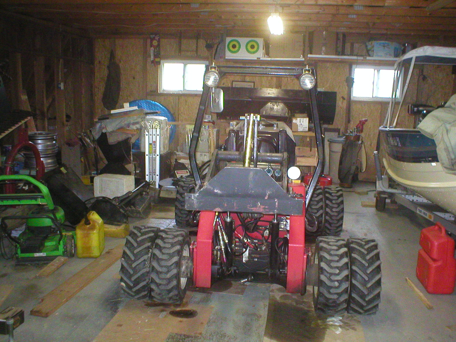

Do you put chains over both tires or just one. I have chains that I sometimes use in the winter but I always take the dual wheels off and just use the chains on the single wheel. I don't think I could get the chains on with the duals on as there is very little space between the 2 wheels.

I typically install the chains on the outer tires of the duals. That way, if i want the tractor without chains, i can just pop off the outer wheels. I have cheap chains that i could also install in the summer instead of the studded chains. I install the inner side of the chains first because there is not lots of room. Then i tighten the outer loop.
An advantage of the chains on the outer duals is they do not rub against the tractor frame.
Ken
   / 1845 Problem #8
Outers... Took the tire off, put the chains on and bolted the tire back on. Make sure you use high quality connectors at least on the inside. Mine were marginal and taking the tire off was too much if a pita.

I just looked at you picture and you ave different tires than ken and I. Much skinnier and I think taller. You know the size?
   / 1845 Problem
#9
My tires are 23x8.50 x12

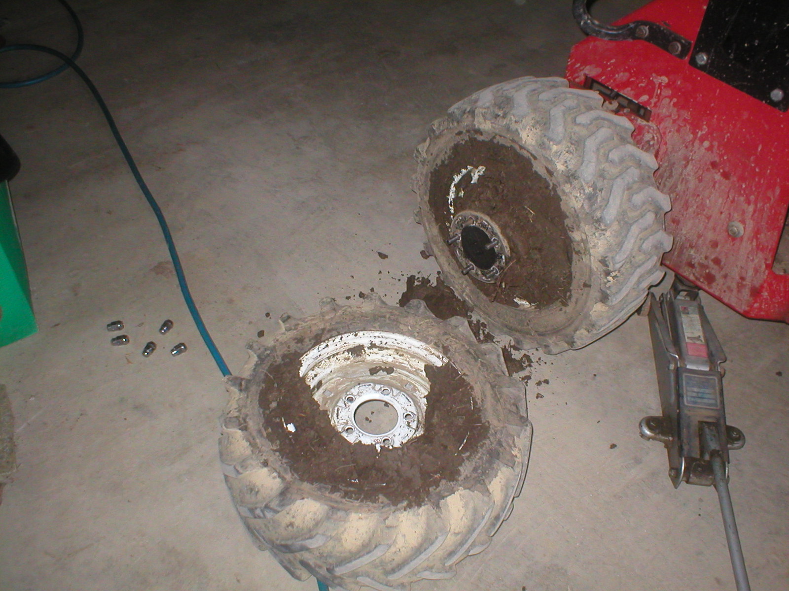

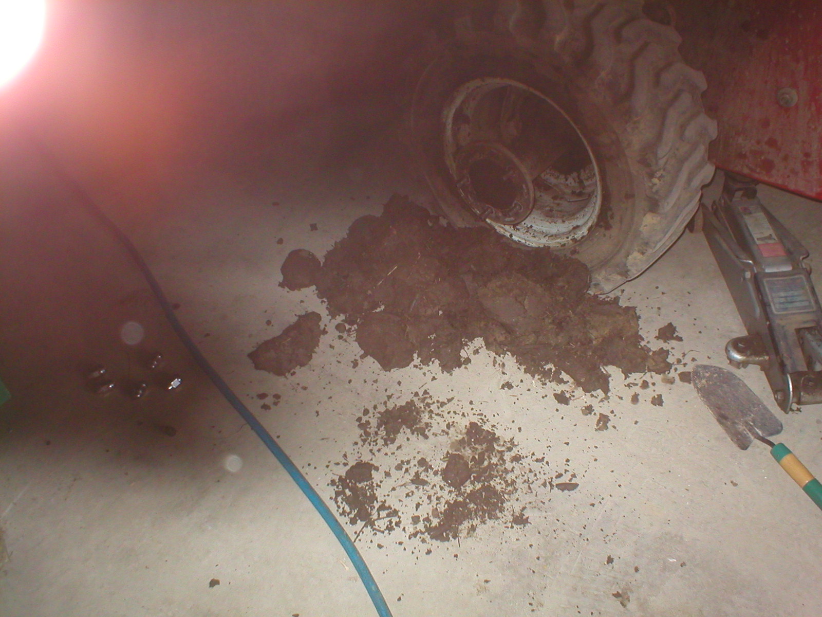

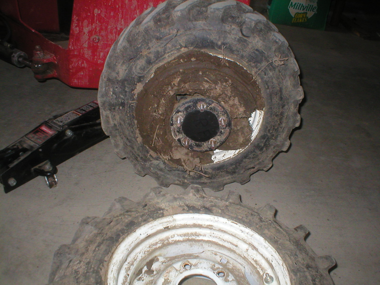

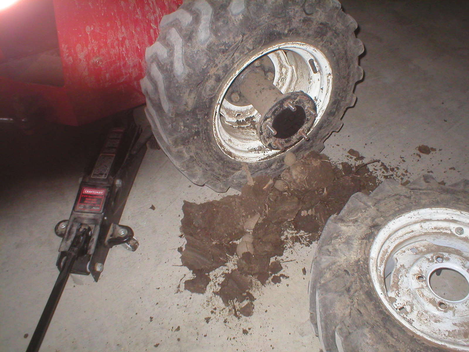

2013-04-04 06.22.14.jpg2013-04-04 06.28.30.jpg2013-04-04 06.31.51.jpg2013-04-04 06.35.04.jpgI finally decided today to take the front wheels of my 1845 and clean the mud out. I drove it previously up and down my driveway as fast as it would go and a lot of the mud between the tires flew off, then I tried prying out some more with a piece of 3/8 by 2 inch steel , still looked like a lot in there. When I took the outside wheel off I could not believe how much mud was packed in the wheels between the 2 tires. See attached pictures.

That is an amazing amount of mud. We have a different setup. There is a metal ring that spaces the two wheel rims from each other at the hub. In the attached picture, you can see the larger hub. So in between the two tires, we do not have the space like you do. At the outside, we do.

I have had it break the valve stem off one wheel and if you leave the mud in there it rusts the lug bolts.
