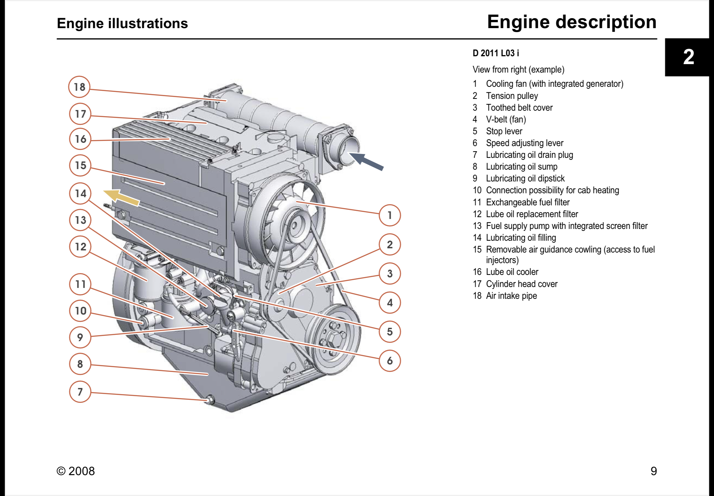

I had taken the cover off the cooler and never put it back on
If you ran it without the engine cleanout cover off, it is like running your car without the fan belt. It would most likely overheat (if severe enough it would score the pistons/cylinders).
I agree that you should do a head gasket replacement and inspect everything along the way. It doesn't seem like it would be too difficult, but that is coming from someone that never did it on a Deutz.
/ 1845 Smoking Bad #22
I don’t think that’s what he was referring to. There is this odd cover over the oil cooler that blowers the hot oil out the side instead of up into the pto cooler. On mine I put some spacers in to raise the lid to allow more air flow. I don’t think there would be any effect on the engine temp with the cover off. Just warmer pto oil.
/ 1845 Smoking Bad #23
Roger that, without pictures, I thought he meant the cleanout cover on the side of the engine.
