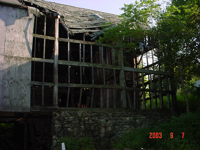

Don't give up on the project if you love the old place. Unless of course it is too far gone. I rebuilt this barn at a cost of about 1/8th of what it would have cost to replace it. Here are a before and after shot. the barn was built in the 1820-1840 era. Inside the walls you see is all missing. The cneter section collapsed. There is a big void missing that is 36' long by 24' wide. This includes the center section of the barn being gone.

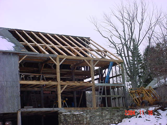

This picture was after we replaced all the beams including rafters.

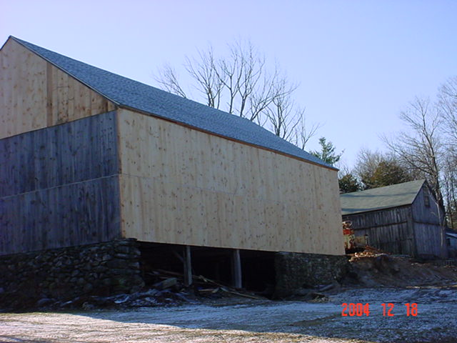

The final project picture. You can do miracles if you have the time and patience to tackle a job like this.

A barn is a different story and wouldn't be lived in. It can be a real trial living in a construction site for a while. Big difference in wiring, plumbing, asthetics, etc. also Time is really the problem. To rebuild economically, it has to be DIY. If one has a job, he spends off time building (and farming in my case) The time involved in being the one man crew and not spent with family is expensive and irreplaceable.
Nice job on the barn.
