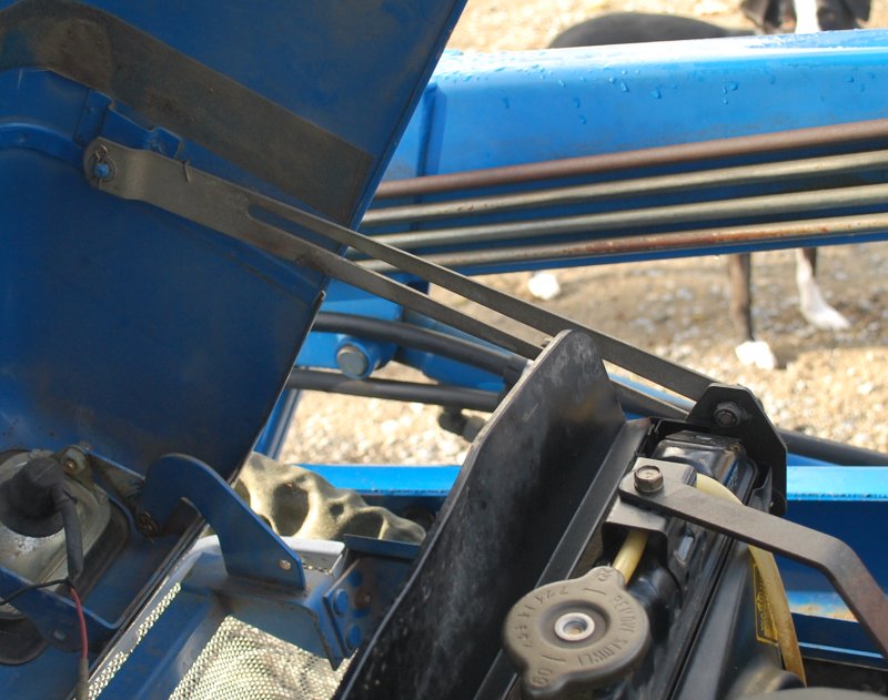

My 1715 has a notched arm and spring setup to prop up the hood. Connects to a bolt down by the radiator area. Trying to find it on the parts diagrams and I see nothing even close. Certainly does not appear to be something someone added since there are factory provisions for it on the hood.
Do you 1715 owners have this hood prop?
I wanted to get a new bolt for it ... looks like it should have a shoulder bolt but just has a conventional bolt instead ... so it keeps coming loose as it can't be tightened down or the prop rod won't slide in it.
Thanks.

Just use a little BLUE loctite that will keep it from vibrating out.....
/ 1715 Hood Prop Arm
I was thinking about that ... or just turning up a spacer and using loctite too. Now I'm just more curious than anything else, as to why it's not shown in the diagrams.

Here is a photo of the mystery hood prop. Attached to a bracket that was obviously an OEM part of the hood.

That's the same prop arm that's on my NH1920. It looks too short in the Messick's picture linked below but if you call them, they can give you the dimensions and specifics on the shoulder bolt. New Holland 192 - 4 CYL COMPACT TRACTOR 2 SERIES(1/87 - 4/2) Parts Diagrams
I bet that is the same one .... and I'll wager my hood was replaced some time before I got the tractor with the hood from a 1920. It was a rental unit from a dealership so it probably saw it's share of haphazard use. All the parts there look identical to what is on my 1715.
Thank you sir.
/ 1715 Hood Prop Arm #15
Thank you sir.
If you need me to, I will take my 1920 hood support arm bolt out and measure it for you.

Thanks fried, I only needed the shouldered anchor bolt. I'm good to go now.
