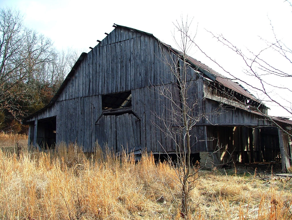

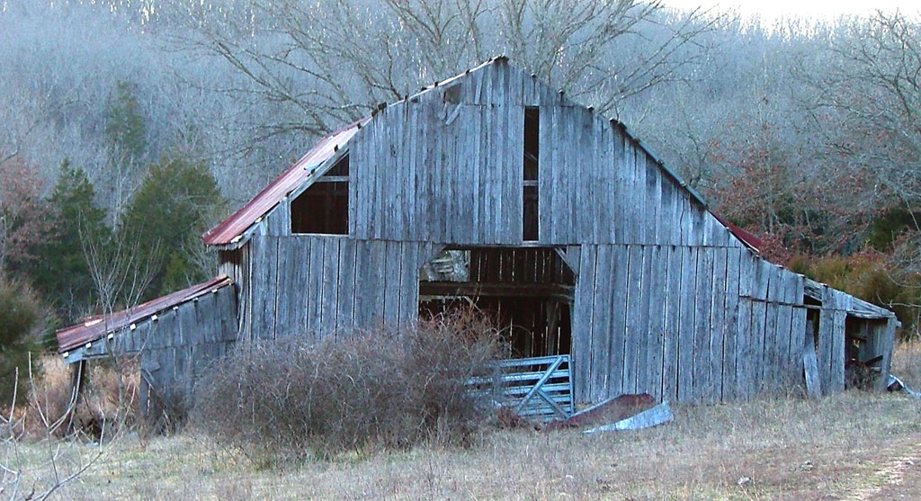

The southern Missouri Ozarks has never been populated by a lot of money but it has been populated for a long time. There are a lot of old barns and I get a kick out of poking through them and trying to imagine the difficulty of building them back in the day. Fallen-in barns are not as common as you think so I haven't explored them much. Folklore says they usually burned up full of wet hay, though, instead of collapsing.
When the OP was asking about thoughts and ideas, I thought he might be open to other ideas including what has worked in the past.

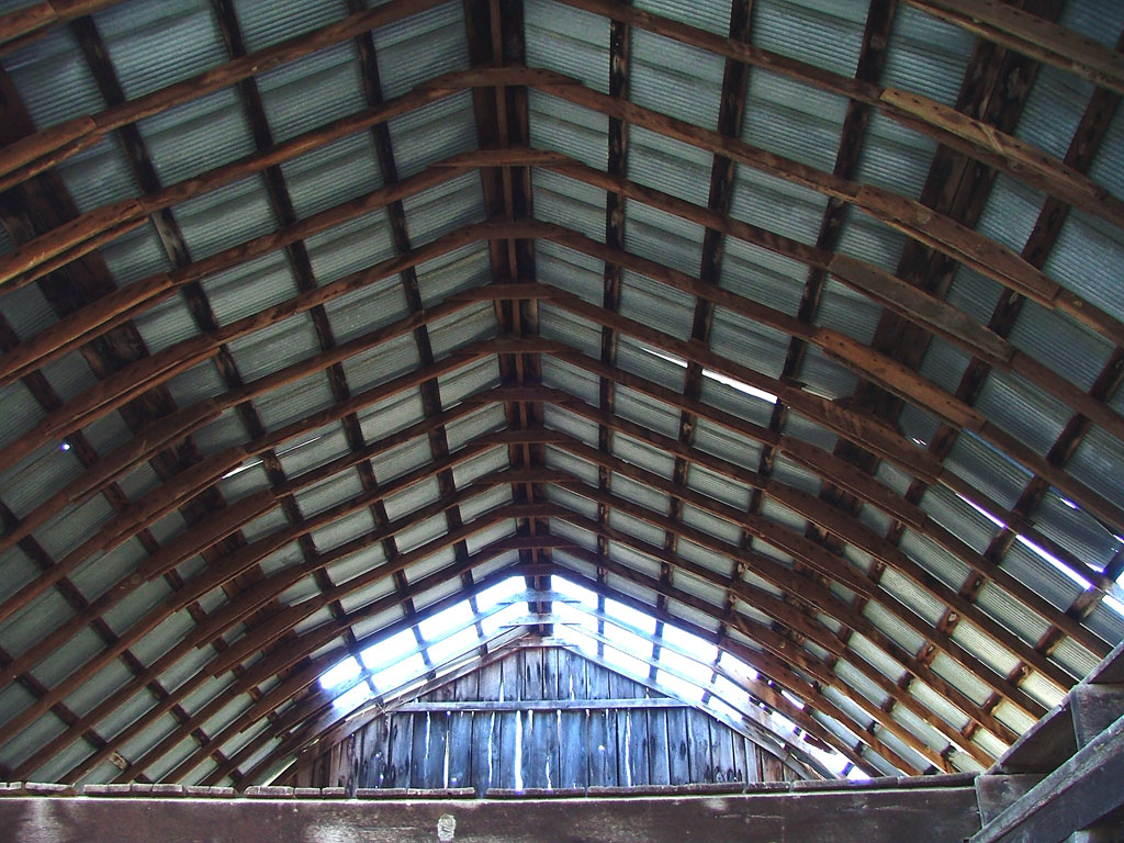

My decrepit old barn is not unusual for the area. There is a retired fellow up the road with stories of splitting 18 cents a square bale 3-ways when he was hired to fill the loft up to the rafters when he was a teenager. He says the barn was old then, too.
Site mixed and hand poured concrete footings. 8 by 8 beams, 1x12 slab sides. Loft of 2x8 joists and 1x planks. Then that gambrel roof of long 2x4s probably sawn locally and cured since last Tuesday when they built that roof 15 feet off the loft deck. And that lumber dimension is exactly 2x4, too, and not SPF but oak. Purlins and a tin roof must provide an awful lot of rigidity for it still to be here for me to marvel at. Yes, I would have liked to talk to the builder.
No Lowes, few tractors, wooden ladders not cherry pickers. No calls to the ready-mix yard. Pickup trucks were puny. No power so no power tools. 4" uncoated nails. No codes or inspectors, either. No running water. Right adjacent is a 10' diameter, 12' deep, concrete and rock lined cistern, though. Hand dug is the legend.

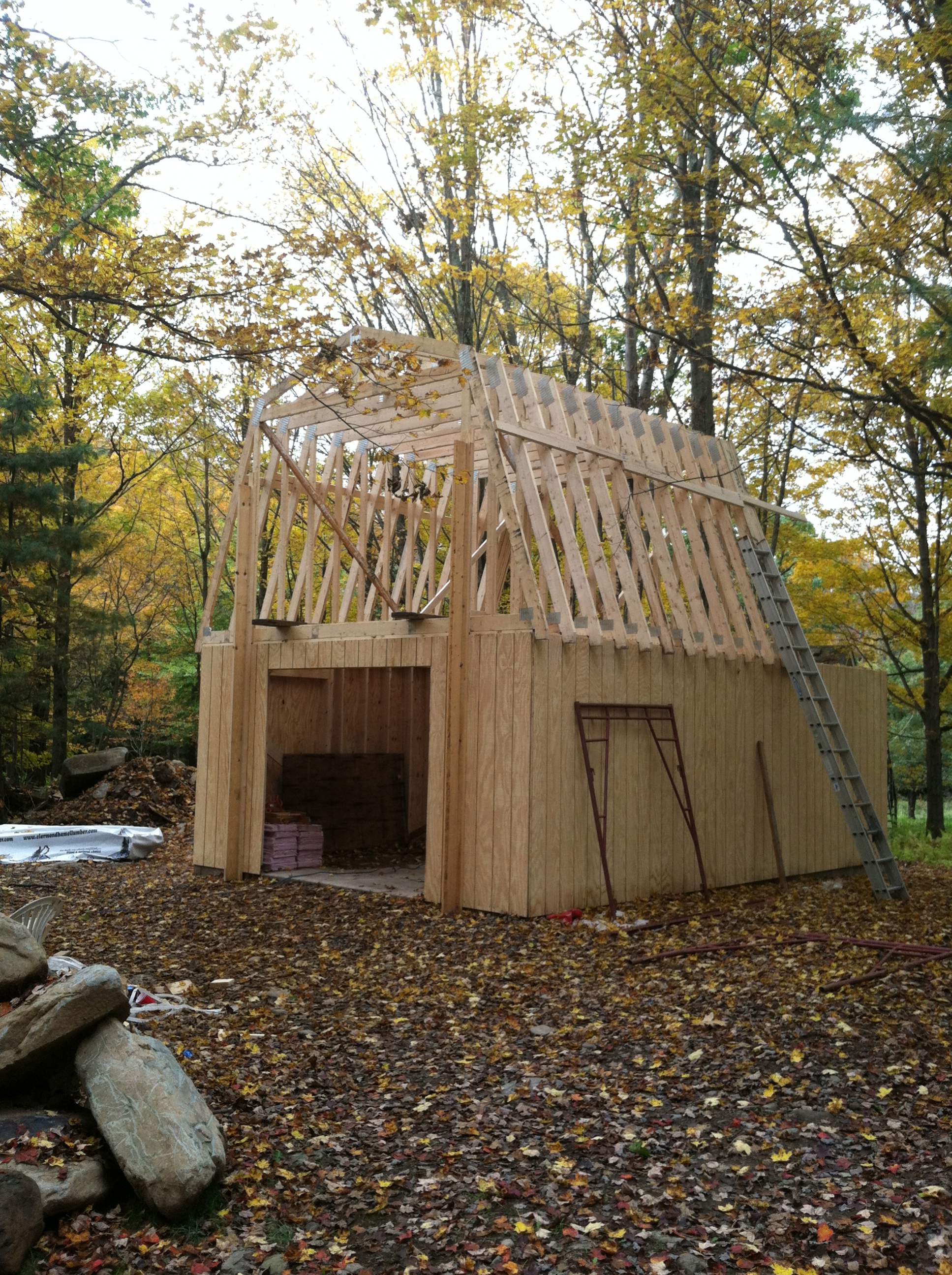

I have used thousands of 2x4 roof trusses. Not on little sheds but on 40 ft spans and longer on 2 and 3 story apartment buildings, in 150 mph wind zones. It's all in the engineering design, the web member, ect. Top cord, bottom cord are often 2x4, and most Web members, although some times you'll see 2x4 bottom cord.

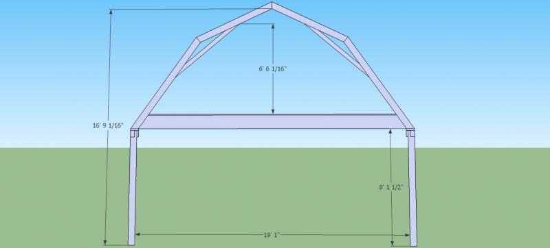

So I did a little more research (basically some creative Googling using the phrase "braced rafter") and found this:
http://pbis.okstate.edu/images/documents/6410_high.pdf
I've run across these old USDA plans before but this was the first time I had found a design that fit my needs. The drawing contains dimensions to build a truss or braced rafter system spanning anywhere from 20' all the way up to 34'. The 20' truss is built from four 2 x 6 x 8s, two 2 x 4 x 8s, fourteen gusset plates of 1/2" plywood, and a lot of nails. Glue is not mentioned, but I will definitely be gluing mine with a high strength construction adhesive in addition to nailing. Once I build a jig they should go together fast. Here's a section view of the new barn plan incorporating the braced rafter design:
The question now is whether or not this design requires the rafters to be tied together via a floor joist. The building is going to be 24' long and I'm thinking that I really only want the loft to cover half of it. So basically half the rafters will be tied together with 2 x 12 x 20 floor joists and half of them won't be. Any thoughts?
I see another question: Did your building get wider? Now you're talking 20' wide? With that span, you'd likely have to investigate wood i-joists.
Not having ceiling joists to tie the wall together is problematic. Something will have to be done to keep the walls from bowing.
And you really probably want a full loft floor anyway. It'll be pretty tough to insulate that gambrel roof unless you step up to sprayed foam. OTOH, conventionally insulation under the loft floor will keep the shop pretty cozy.
:D Well, everyone was telling me to go bigger... But yes, I figured going up to 20' couldn't hurt, especially since I had a good rafter design.
Steel cable? If I do the half loft I thought about running two cables, evenly spaced, between the beams on the open side with turnbuckles so I could tighten them up as/if needed.
