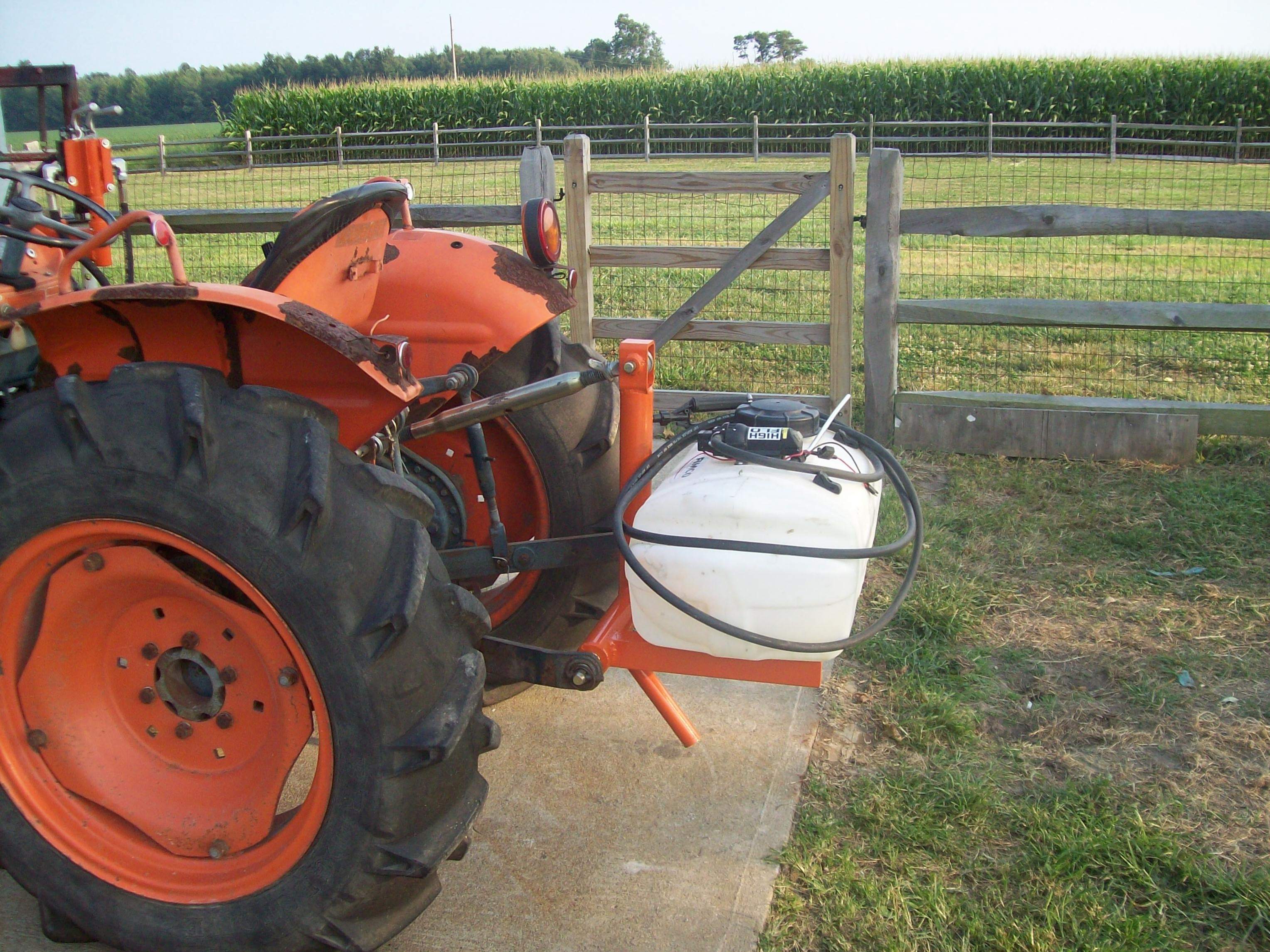

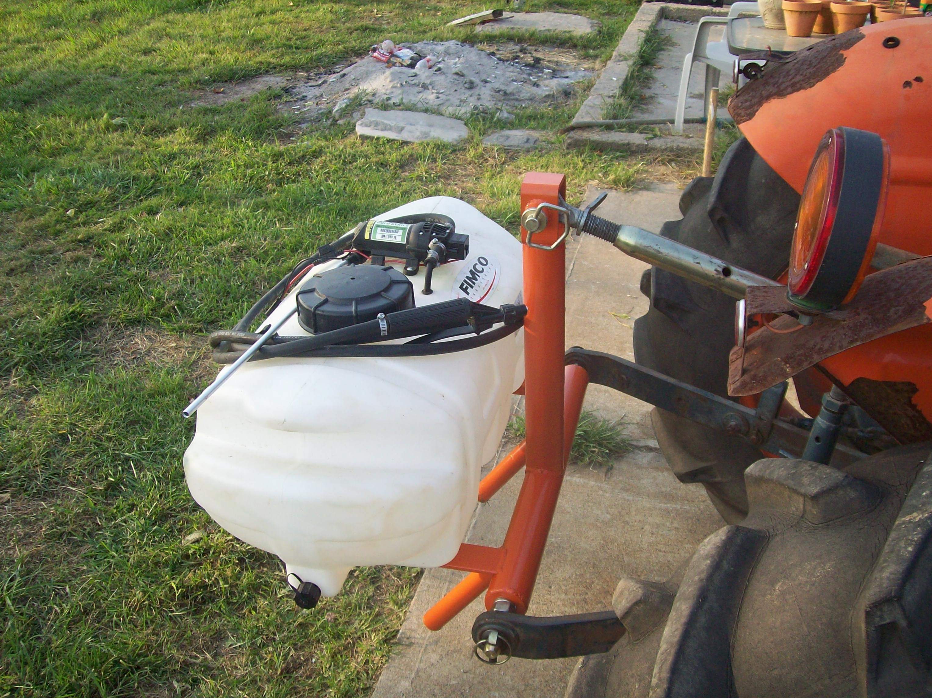

   / 15 Gal sprayer on a 3 point? #24
Here is mine...took about 3 hours to fabricate. Nothing fancy, but do plan to add a boom to it soon...

Danny 1553 I really like yours and think I will steal your idea.
Thanks exactly what i was looking for.
Brandon
Brandon
It is yours for the taking, glad i could help. BTW, it's made from some scrap 2" pipe I had, and some 2" angle. I got the 3 point pins at TSC, the only thing I had to buy. I'm also going to add a Q/D 12 volt outlet of some type to the rear of the tractor, so I don't have to stretch the power wires up to the battery every time
Dan
