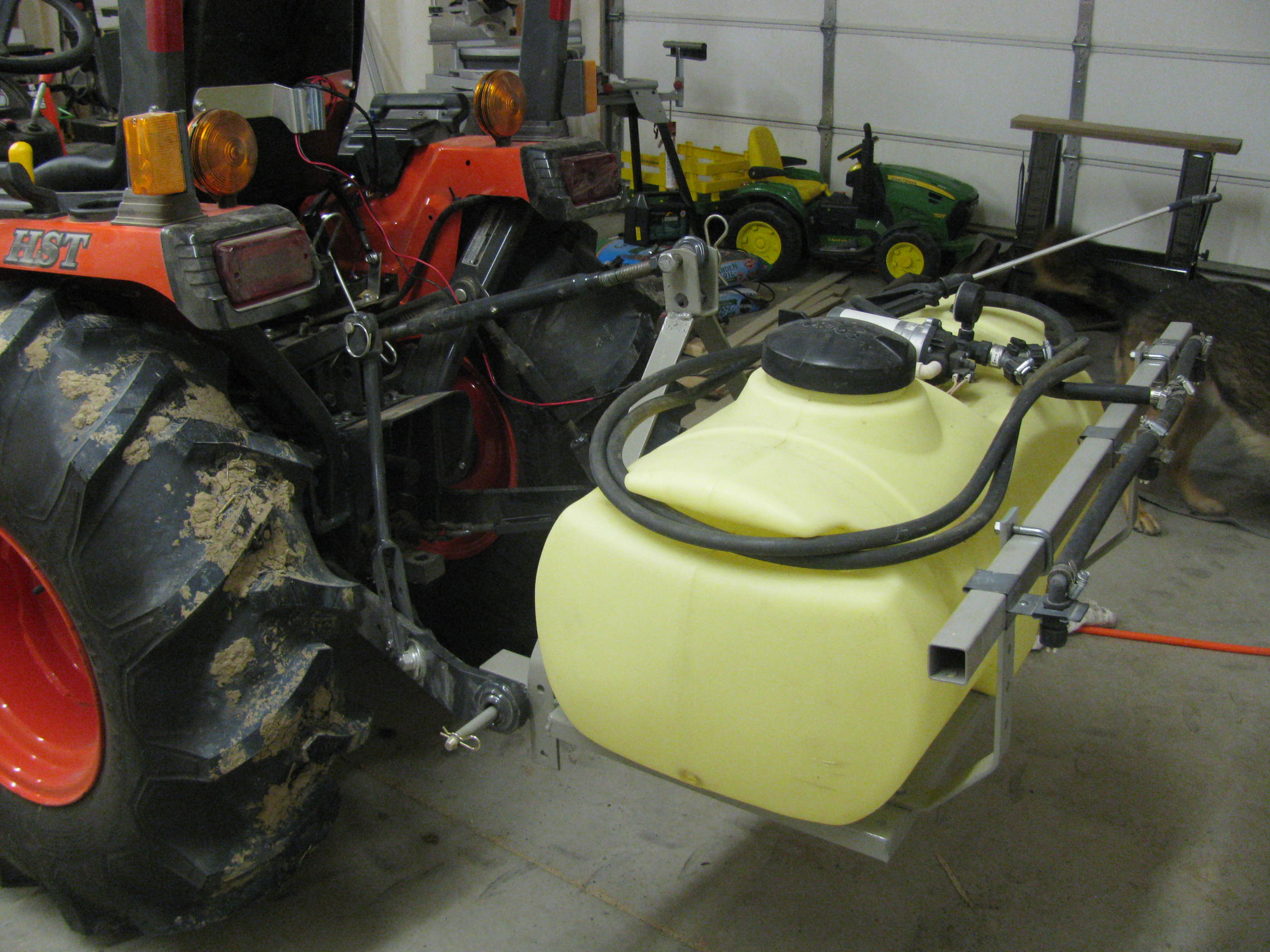

Here is mine...took about 3 hours to fabricate. Nothing fancy, but do plan to add a boom to it soon...

It is yours for the taking, glad i could help. BTW, it's made from some scrap 2" pipe I had, and some 2" angle. I got the 3 point pins at TSC, the only thing I had to buy. I'm also going to add a Q/D 12 volt outlet of some type to the rear of the tractor, so I don't have to stretch the power wires up to the battery every time

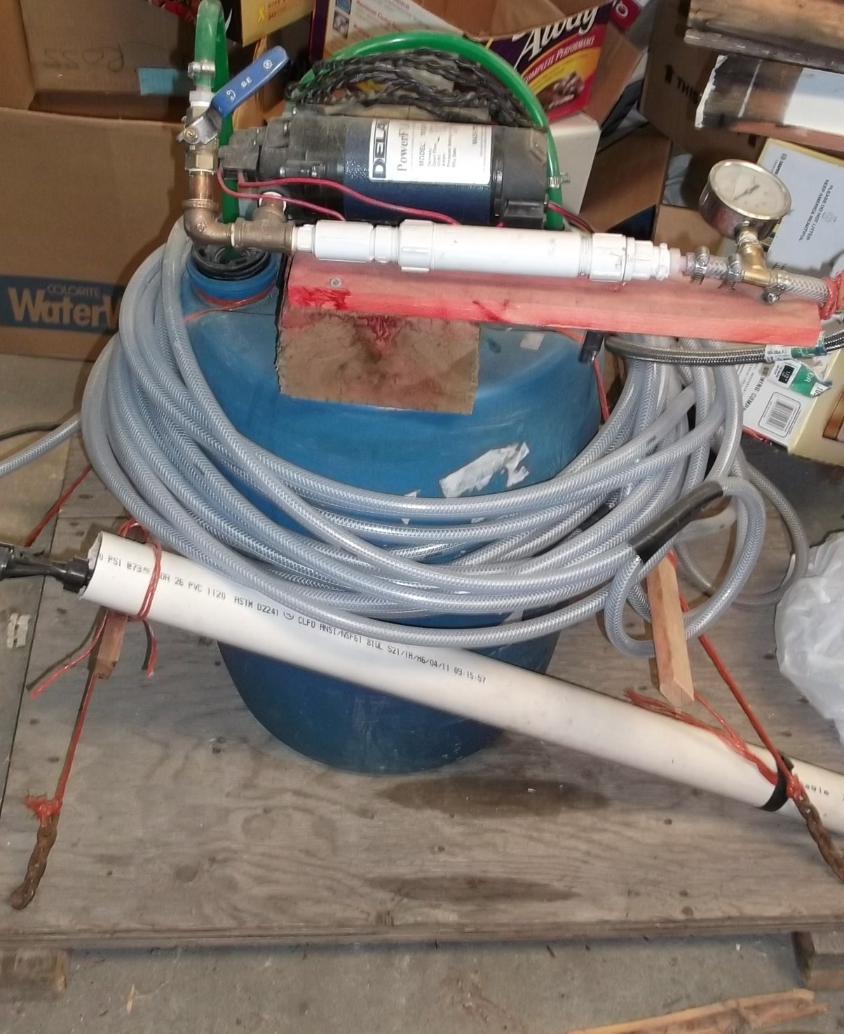

I mounted my tank and pump to a pallet. I use a hand wand w/60' of hose to get into places the tractor won't go.. If you have a set of forks you are in business... I also made a boom sprayer out of PVC that I used for some time... at the Ag store they have spray tips that clamp on 3/4" PVC... works for me... Maybe this will give you some ideas... Dave
