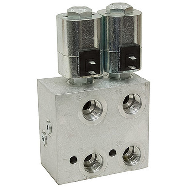

Has any one used any of these lower cost valves ;
or some thing else? Need to split the bucket roll-back circuit to control a grapple.
Not sure compared to the $200.00 Name Brand ones on the market

I would rather deal with a hydraulic supplier like Surplus Center, Discount Hose, etc.
You'll need more than just the control valve, you'll need hoses, couplers and fittings which they can help you with.

Since plumbed into curl -dump should work fine but pay close attention to see if there is any mention of the coil being polarity sensitive.
Like Fuddy stated you will also need a source for hose and fittings.

I'm very familiar using these valves on our AG equipment.
https://www.ebay.com/itm/387273575258.
I make all my own wiring harnesses and have access to fittings and hoses. Just thought the style I posted would be less bulky
and easier to install on a Compact tractor.
