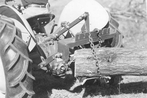

Something simple to do what s219 suggests might be as shown here with the 8N (chain to hold the log), or using the iMatch with tongs (chain works here too) to get the end of the log up so it doesn't dig in and a little weight on the rear wheels for traction.

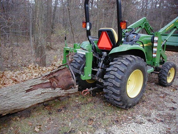

   / 1026R #6

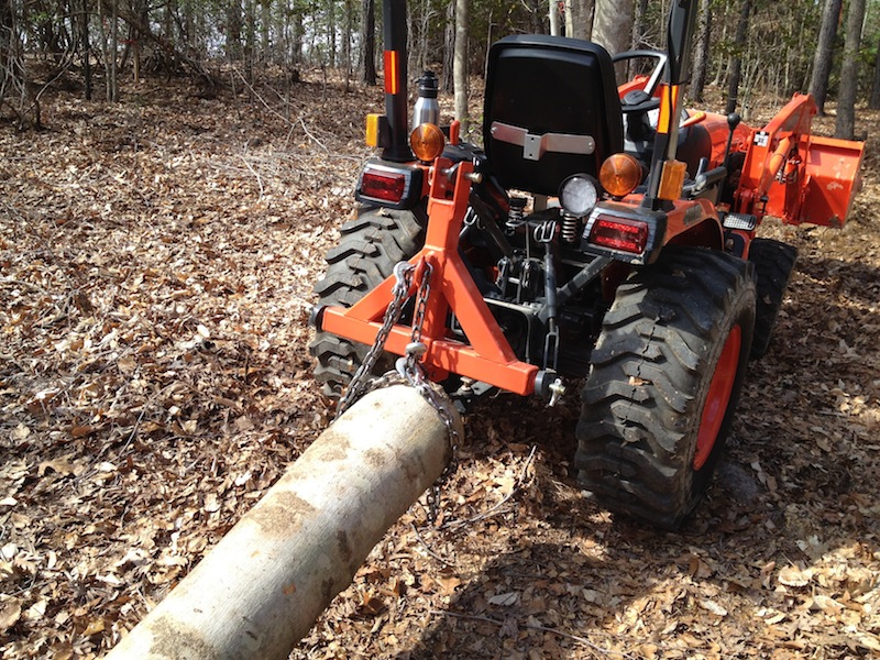

Here's what I use -- a combination skidding plate and trailer hitch:
   / 1026R
