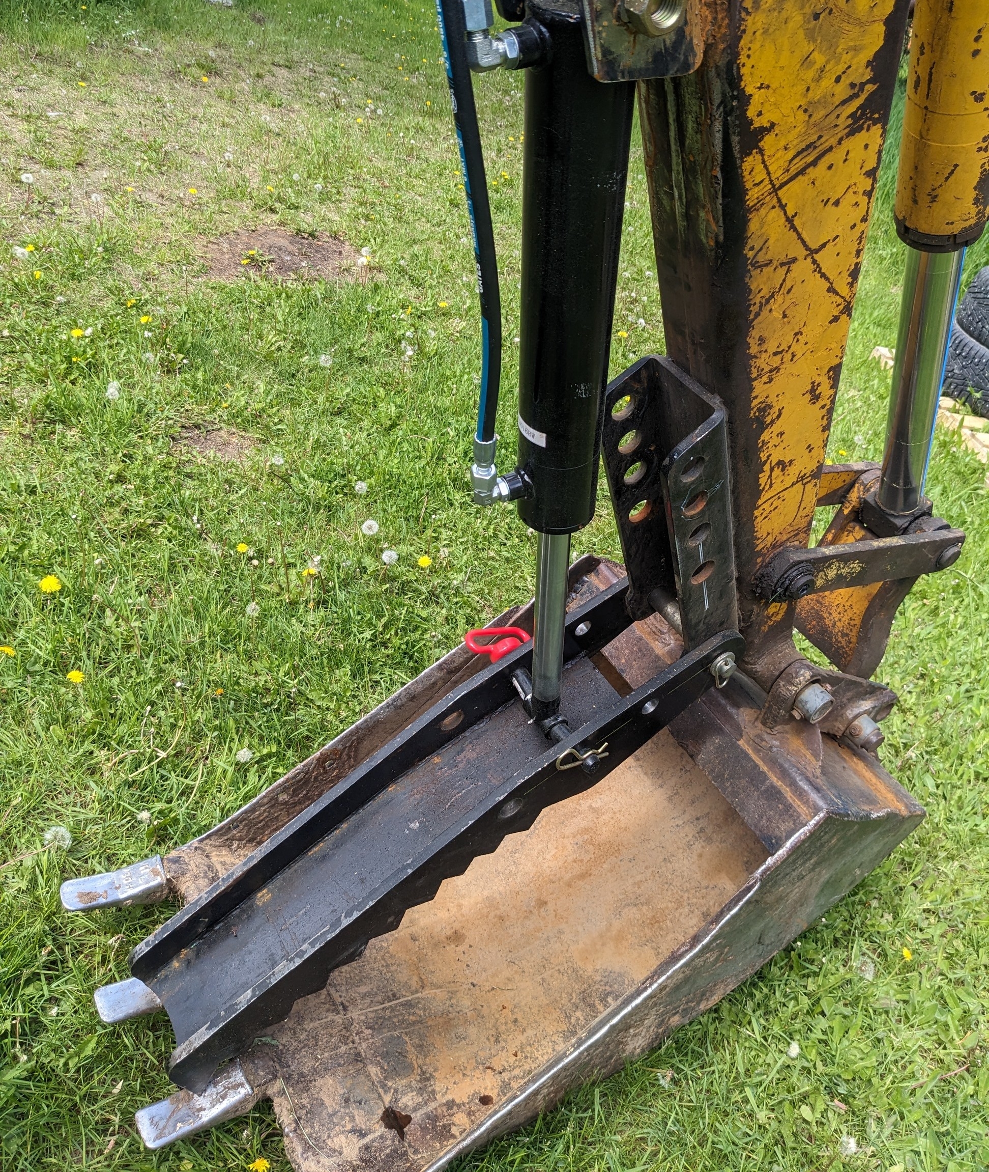

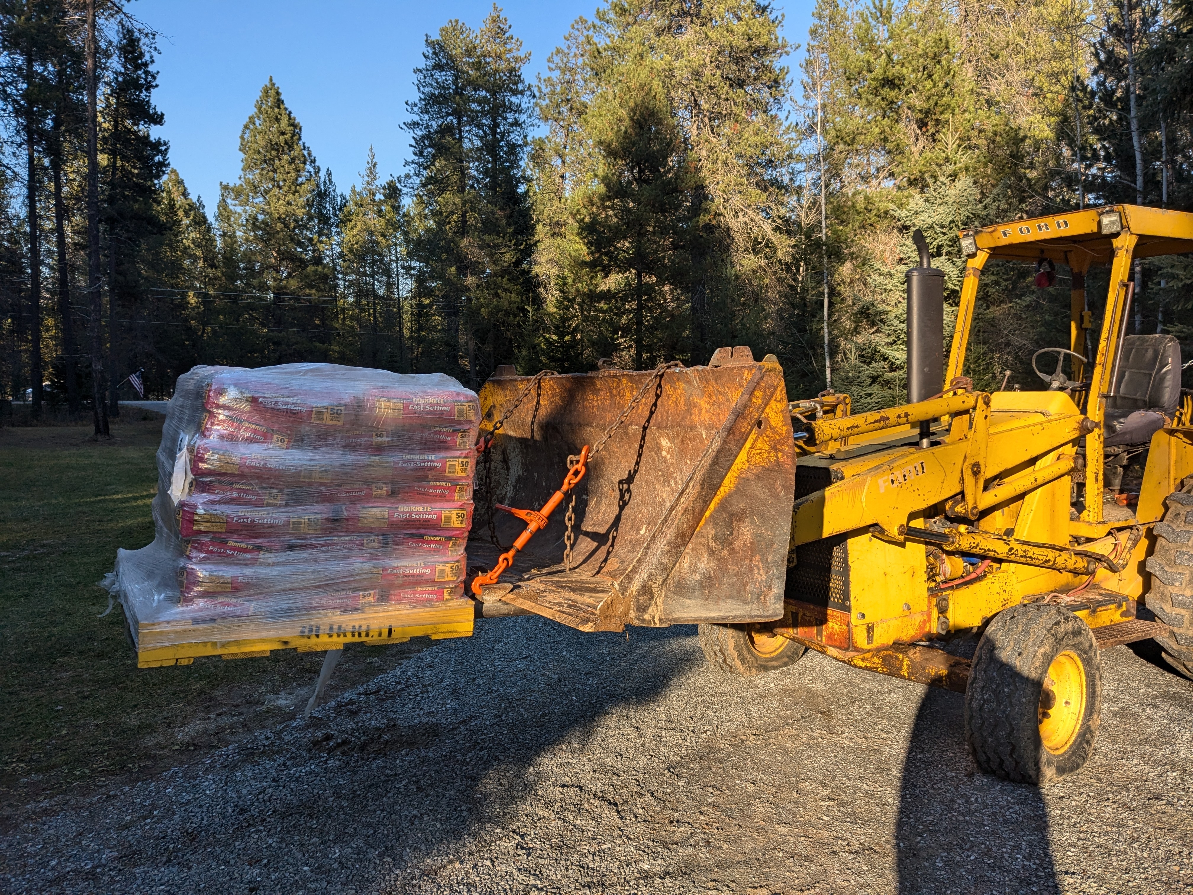

Second to last trench I did with the 550 36" deep X 400' It was a little hard on the Harbor freight 12" wide bucket I adapted instead a full 2 foot wide trench, but some welder work fixed it up. My guess is that 100lb HF bucket is probably about as beefy as what come on a new SCUT backhoe for a bucket.
TLB can make short work of moving a full 3300lb pallet of concrete if needed for a job as well. New is always nice but there is serviceable old equipment out there, many people buy an old machine get the jobs done and then sell them for close to what they paid for them. I just truly believe a newish/new SCUT would loose against even the lowest priced backhoe above digging the depths the OP is asking about especially if the SCUT or old backhoe is also tasked with transporting those spoils.
If I was to buy today out of the list above the Case 580 C would be it, Even at the 16.9 K price, if as described should also be powered by the venerable Cummins 4BT and has modular drivetrain parts replacement unlike a Ford 550-555. Oh and if a guy feels like it with some of the money saved add a hydraulic thumb to the backhoe.
