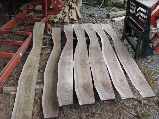

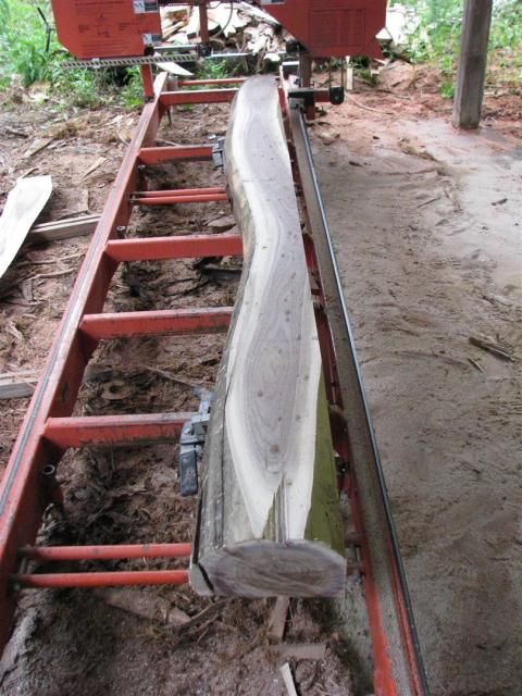

I started sawing a whack of Walnut my neighbor dropped off. First log was very....interesting:
I need trim wood for the interior doors and windows. After studying this log, I figured it was a good fit. I trimmed it up and left one live edge:
Then I slabbed it out at 4/4 thickness(1 & 1/8"):

No, I either use a water hose or pressure washer or nothing to clean them depending on condition.
Bark does not dull the blades, but rocks and sand caught in there from skidding does. If a log arch or tractor forks are used then no cleaning is necessary since the logs never get dragged through the dirt.
Blades very rarely break. I send my dull one's back to Woodmizer's Re-Sharp center and they set and sharpen them...about $8 ea, then ship 'em back. New blades cost about $18 ea and can be re-sharpened around 6-10 times.
In good clean soft wood a blade can last all day. Hardwoods usually require a blade change mid day.....that is unless you manage to find something foreign in the log to hit.

Cool. Isn't the color of fresh cut walnut wacky? It fades really fast (within minutes), but the first time I saw it I wondered what was wrong with this walnut as it looked greenish.

Yep, and Walnut seems to attract more tramp metal than even Cedar. So far I have been real lucky and the only metal I have found has not been in any logs.......but parts of my mill......backstops and dogs(clamps):laughing:
Pacer, the worst thing I have heard to hit is a ceramic insulator...they really tear stuff up. Guys on the sawmill forum show pictures of stuff all the time, civil war bullets, cannon ball, railroad spikes, chain, cable, a frozen squirrel(yep)....you name it it can be found in a tree:D
DST, yes this curved log had a large wide green band all the way through the log. It faded to light brown in about a half an hour. Some of the colors you see upon opening up a log are just brilliant. It's too bad that oxygen removes some colors so quickly, so you have to enjoy it like a sunset.
