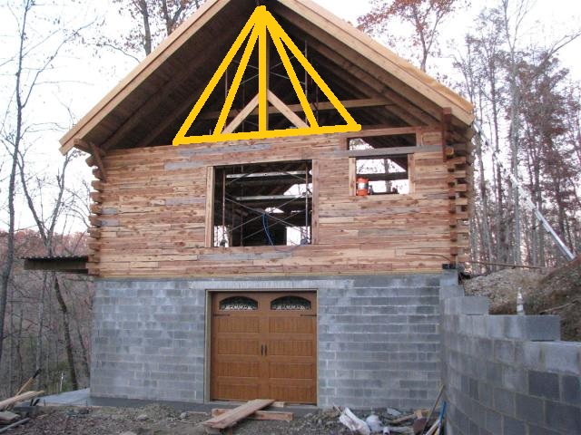

I guess this really make it "Av-ant Guard" eh?
Nope, it makes it "like far out man" . :laughing:
