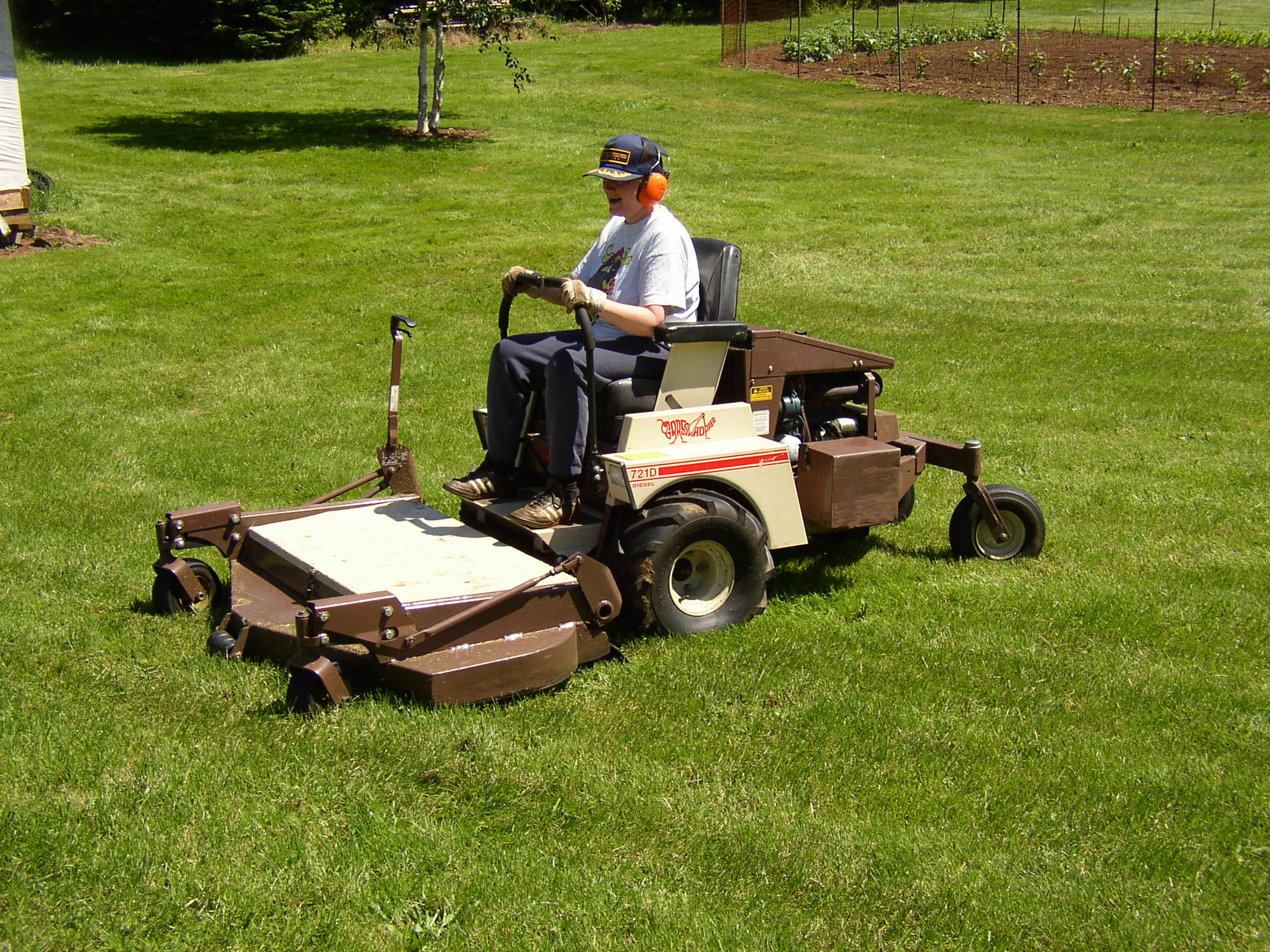

I bought a used model year 1993 Grasshopper 721D Diesel commercial with 61" RD mower back in 2003 for three grand and spent close to one grand on parts to refurbish (none for the Diesel engine so far).
About the only maintenance the previous owner (commercial lawncare) had done was engine oil change, which explains the need for refurbishing.
For me the cost of buying & refurbishing this mower works out to $222 per year so far, since the labor refurbishing it was free (a hobby).
Other than regular maintenance, repairs over the last 18 years have been pretty minimal: one new driveshaft, PTO clutch, two spindle bearings and two sets of gauge wheels.
The mower works & looks about the same now with 1800 hours on the clock:
