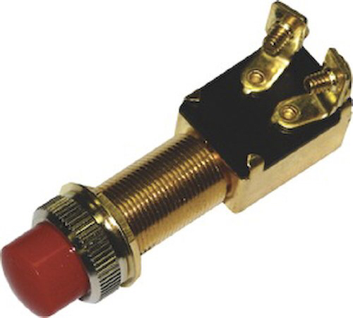

Farm Boy, you are absolutely correct! My plans are to mount the momentary switch down by my foot so that I can activate the horn without taking my hands off the control arms. The horn will mount up under the front of the machine where there is a nice area that allows me plenty of mounting options that are out of the way and out of site. Of course, I'll post some pictures once it is complete.

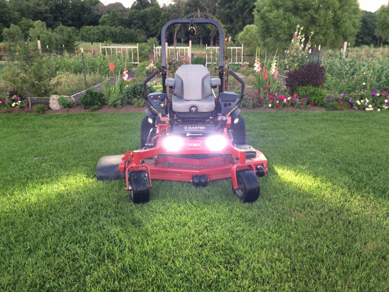

I like the light, but I would bust them. I need to make a draw bar that is a little nicer than the current 2x4 board.
I gave my light placement a lot of thought, taking into account available mounting points (as little drilling as possible), function, ascetics, and my particular mowing areas. I don't really have any hazards, so was comfortable keeping them low which also keeps the bugs down low as well and not swarming around my head. It works for me, but totally understand that others may have different conditions, desires and needs. Thanks for stopping by and commenting!

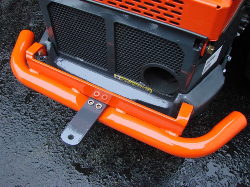

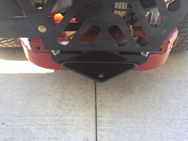

I have a hitch similar to what you got from Amazon, and I use it all the time. It works great for my trailer, sprayer, and spreaders. I've even pulled light harrows when seeding areas.
That's great to hear! Yea, it sure is beefy - 1/4" thick steel! Took awhile to drill out the extra space to fit my existing bolt patterns. My use will be very similar to yours. Thanks for commenting!

Gragoneggs - thanks for your kind comments. Can totally understand the lights up high on the ROPS - that's where I have mine on my Kubota Grand L3540 and they work great for snow plowing and other outside tractor work at night. For the zero turn, I wanted to try them lower and more directed since my focus would be on the path ahead as well as the mower deck sides. After testing them out, I'm really pleased with the performance - they are more than adequate in brightness and coverage for my task.

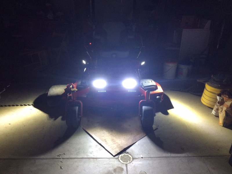

Ok - looks like photo uploading is working again. First off, here are pics of the LED light strips I used on the underside of the mower.

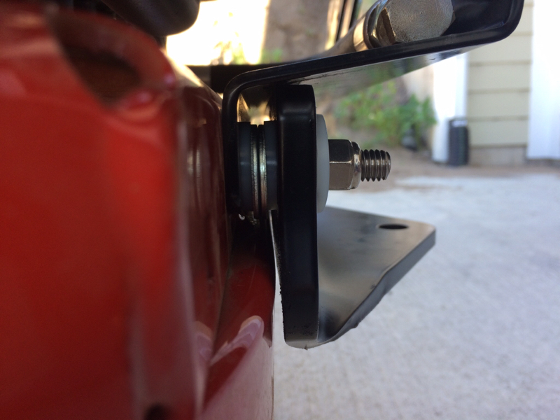

I also complete the horn mod - pretty happy with how the install went and the positioning of the momentary button for activation with my foot. It's a pretty heavy duty button, so I'm hoping it holds up to the foot activation - not that I plan on using it all the much! :)
I am a bit disappointed with the loudness of the horn compared to the engine noise. I'm not sure it will be heard if I'm running at full throttle while mowing. I may have to look for a louder horn like I have on my tractor.

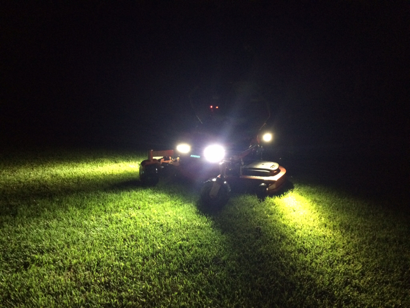

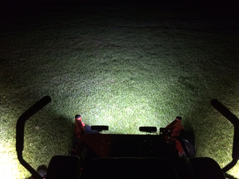

Here are some additional night time shots of the lights in action. I'm very happy with how these turned out and I'm absolutely loving this new lawn mower!
