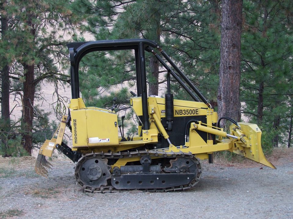

No that is not my listing. I have mine under Wenatchee craigslist. I also have it posted in the private party ads on this site (here is a quick picture).
Mike

Hi Dave,
The rippers are something I originally purchased for my tractor and then trasnferred to the dozer once I bought it. I guess my first question would be what exactly to you want to do with wither the rippers or box blade - it will tend to make some difference. From a practical standpoint the box blade is the best bang for your buck. You get the advantage of ripping teeth combined with being able to scrape/moved loosened material. The rippers on the dozer we used to pull up some roadbed (deep) so it could be regraded and rolled. But the attachement was primarily was used to rehab old skid roads so nature could reclaim them - something a box blade would not have been all that efficient for.
You won't go wrong with a quality box blade (and also has better resale than basic rippers).:thumbsup:
Mike
