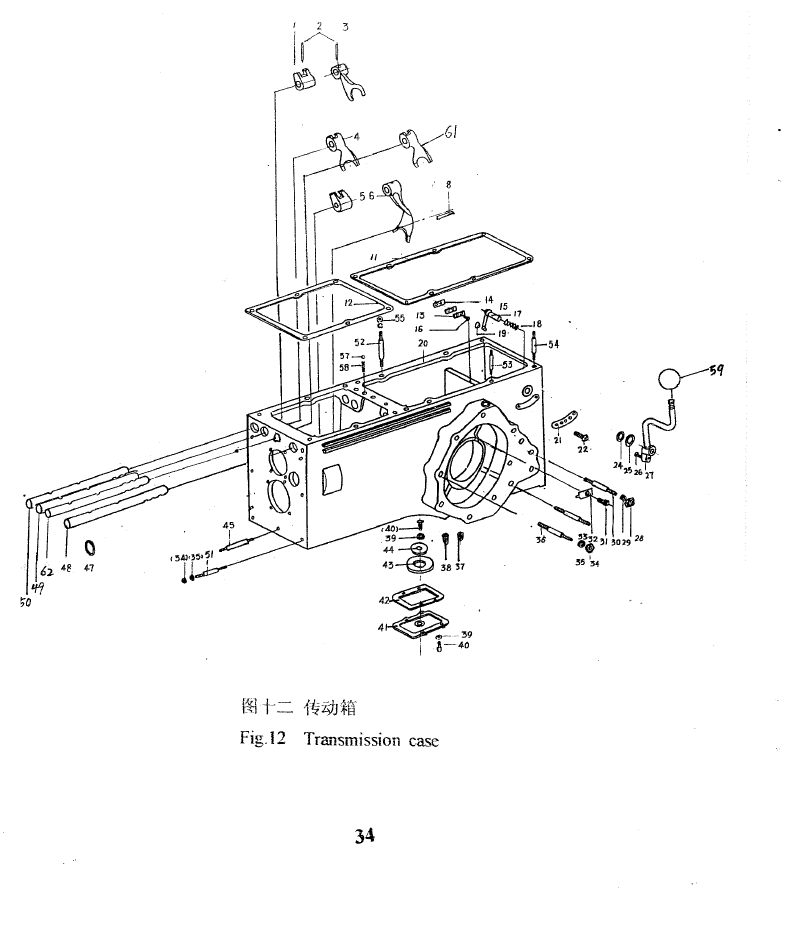

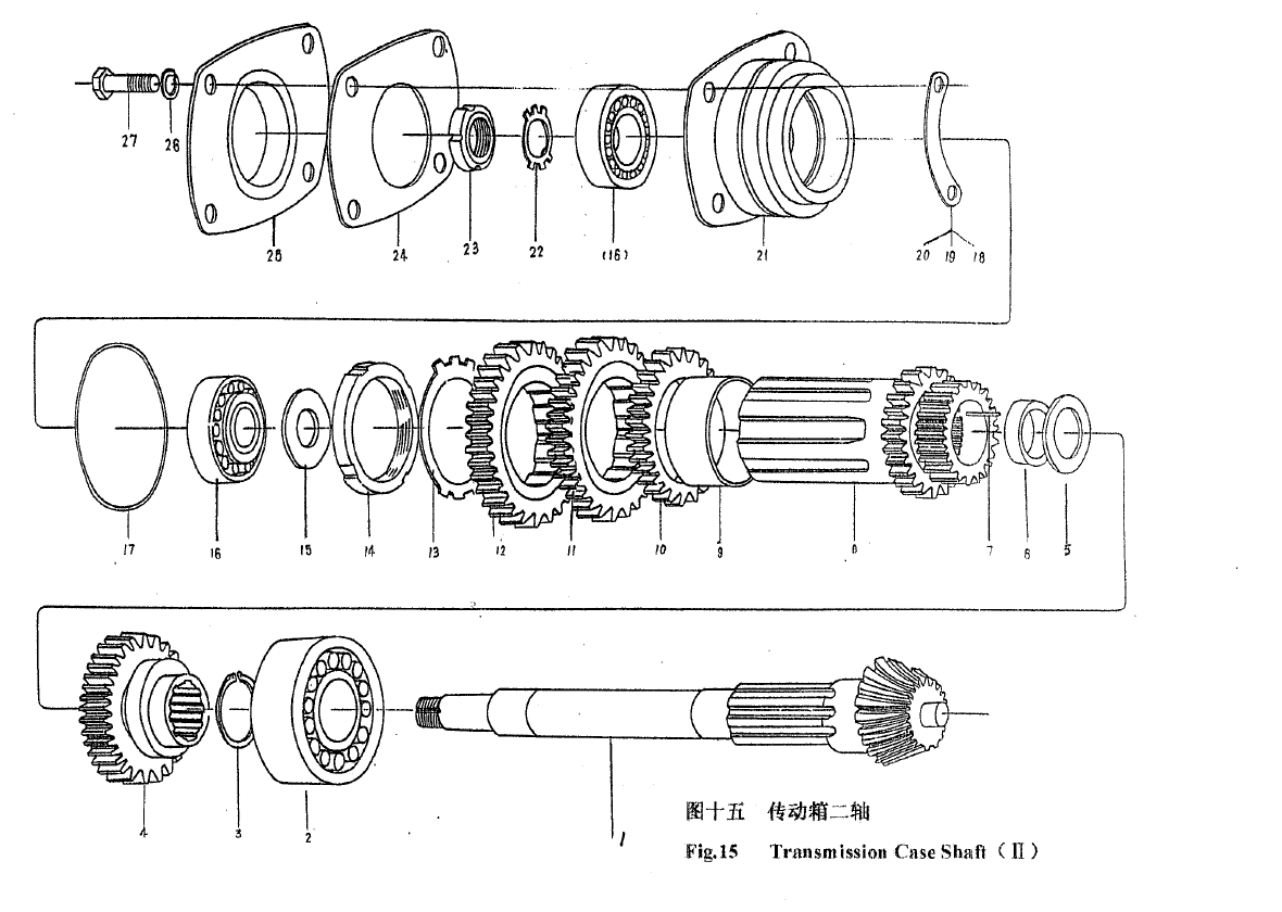

/ What is this bearing? #3
If it was the pinion bearing you'd know it in a heartbeat.
The cross shaft bearing are tapered roller bearings. That leaves only the live PTO shaft which turns at engine speed - all the time the clutch is engaged. I'd get up in there with a borescope to see what's going on first.

Pulling the top covers off for inspection isn't terribly bad.
/ What is this bearing? #9

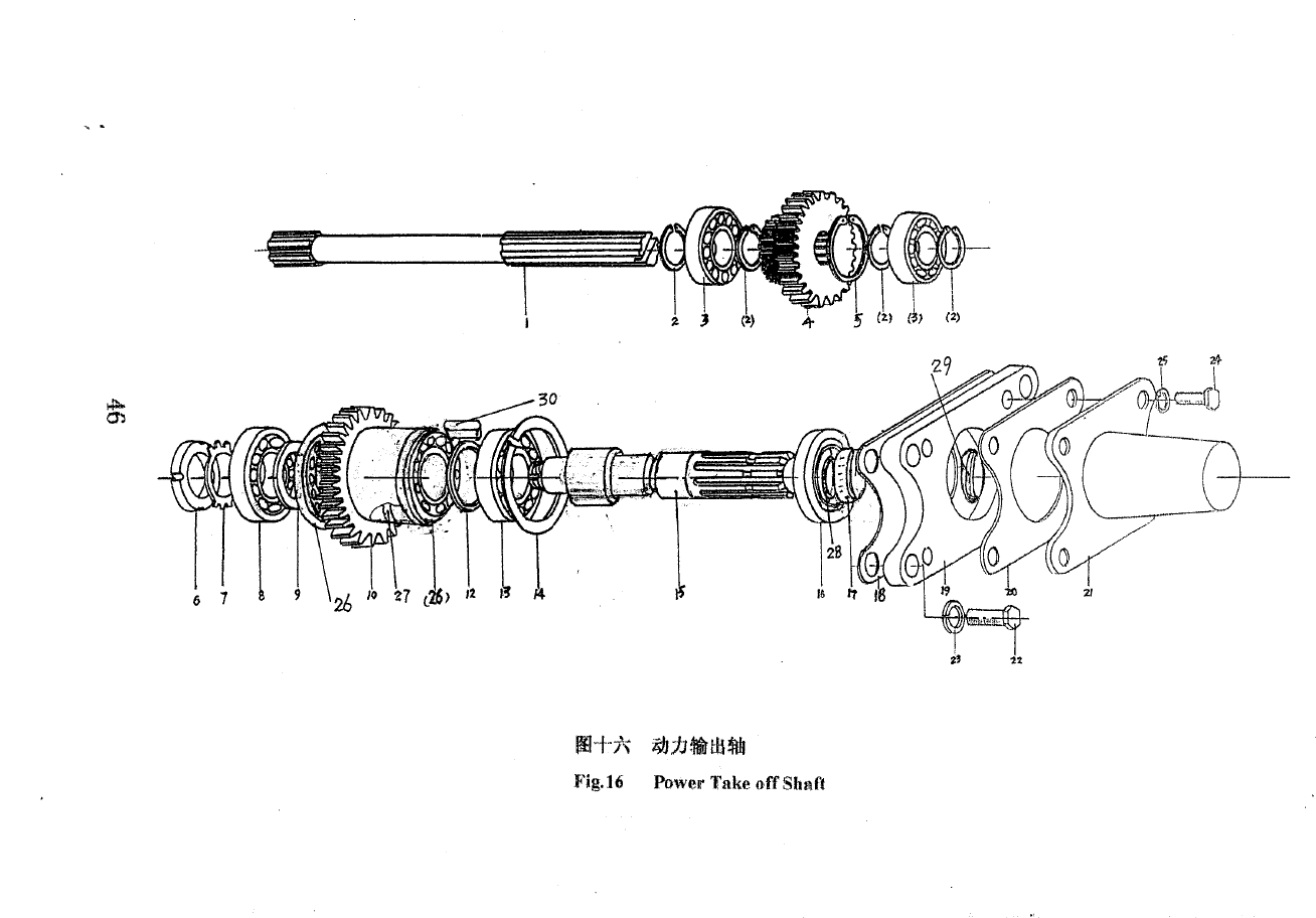

What's curious is that the inner race is intact, so I'll speculate that the live (upper, #1) PTO shaft has parted. This is the tang drive PTO that you should not be able to turn with your hand. In fact I think if you reach up in there you'll find a piece of shaft laying around. That said, you still have full use of your 540/720 r/m PTO. At this point no further damage should be expected, pending inspection. You COULD do two thorough kerosene flushes, top up with new oil, and be on your way.

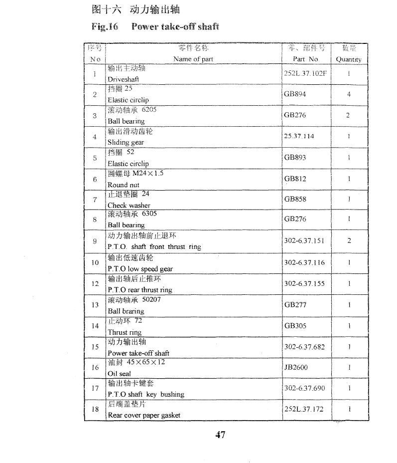

There should be some numbers on that broken bearing. I would look for those, then compare with the parts diagram that Bob Rooks have been sharing. This should give an idea of where this bearing is located on the machine.

/ What is this bearing? #16
What manual says to use SAE 30 oil? That's inappropriate! Use 85W-90 gear oil in the transmission/bevel gear case (common sump), and 90W-140 gear oil in the final drives. There is no brass in either compartment.

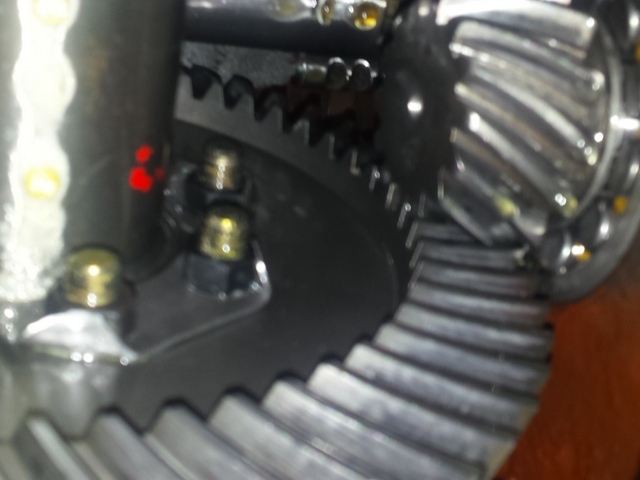

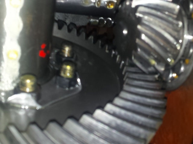

#18
Here is an update. I sent a camera up everywhere I could. see attached. I reached my arm everywhere I could halfway to my elbow. I could not find anything loose. I cleaned it all out with diesel fuel but didn't find anything more debris. No shavings. no more bearings etc. The PTO shaft runs freely when not engaged. It does not turn (not running) at both speeds. Nothing appears out of the ordinary from the view I can see. At this point I am going to add my new 80w90 oil button it up as soon as get a replacement shift stick for the forward transmission and call it done unless someone sees something I am missing. Did the factory drop an extra bearing in this for fun? Thanks for the support. I think that big magnet did an excellent job.

/ What is this bearing? #20
WOW!
Totally not what I expected to see after looking at the remains of that bearing!
I can't see how even a dropped bearing from the factory could be that damaged and not have something else destroyed in the process.
At this point one would have to wonder if it wasn't done on purpose just to freak someone (me) out?
In any case, it looks like you have no damage and I see no reason not to clean out the crap and refill with fresh oil, then forgetaboutit.
Lucky you. Except for the scare part....
