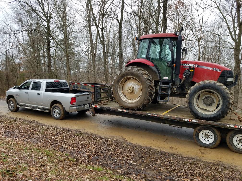

Had to take my tractor in for a front axle leak repair.View attachment 592145
I'm curious... Did you have something else behind the tractor on the trailer? If not, what was the reason for having the tractor so far forward? Looks like it may have been a little better balanced to have it back a few feet.
Rob
/ Your towing rigs and trailers #3,216
Rob
I agree, I always put my tractor so the back tires on centered between the axles.
Rob
Yet the truck looks level.

Cat’s gooseneck is a tandem dually, while Tim’s trailer has singles. Big difference in GVW. Tim has to forward load the tractor to put more weight on the truck to avoid overloading the trailer’s axles.
I’d also bet Tim has airbags on his truck to help with the extra weight.

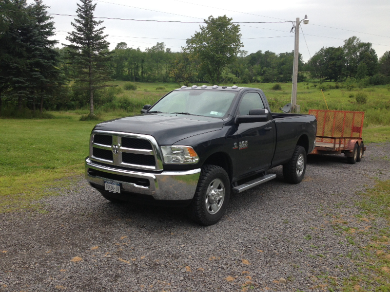

I'm not being critical, just asking. Because that's not how I've always understood trailer loading best practices to be. As far as looking level, it does, but that means it is squatting quite a bit from unloaded. Here's a pic of my 2500 unloaded. Notice the rear wheel clearance compared to his. I think his is a 1-ton, which means even stiffer springs so I wouldn't expect it to squat any more unless it was severely overloaded (which I'm not saying it is), but that doesn't mean loading the tractor further back isn't a preferred position.
Just looking for Tim's reasoning because I like to learn...
