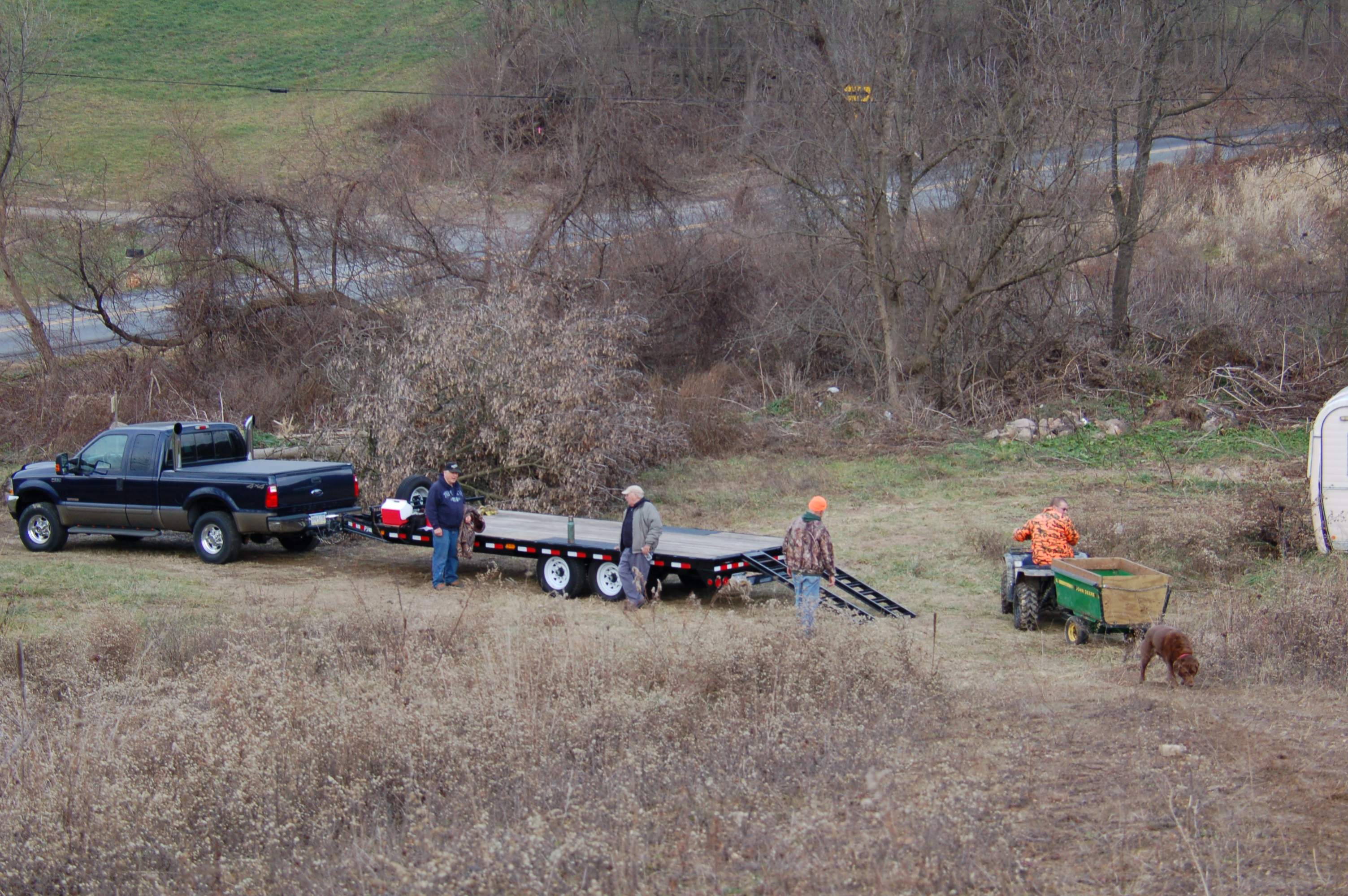

I have 2 of them, but superdutys, not f150's. And not new... *grin* My 'new' truck is 16 years old!
Here it is on Sunday, hauled home another horse for the wife.

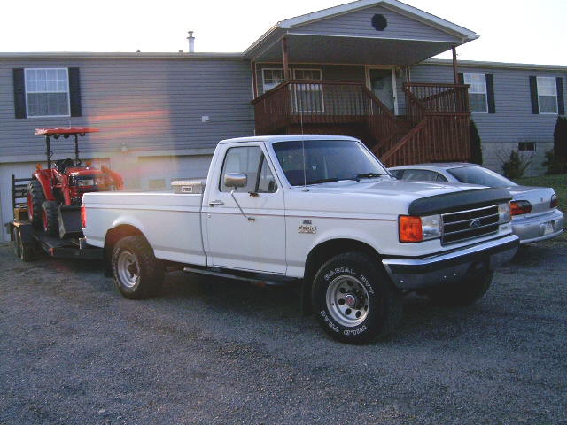

I'm still driving my 1991 F-250.
