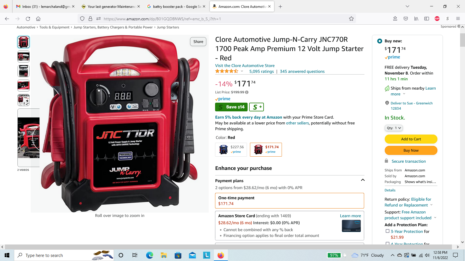

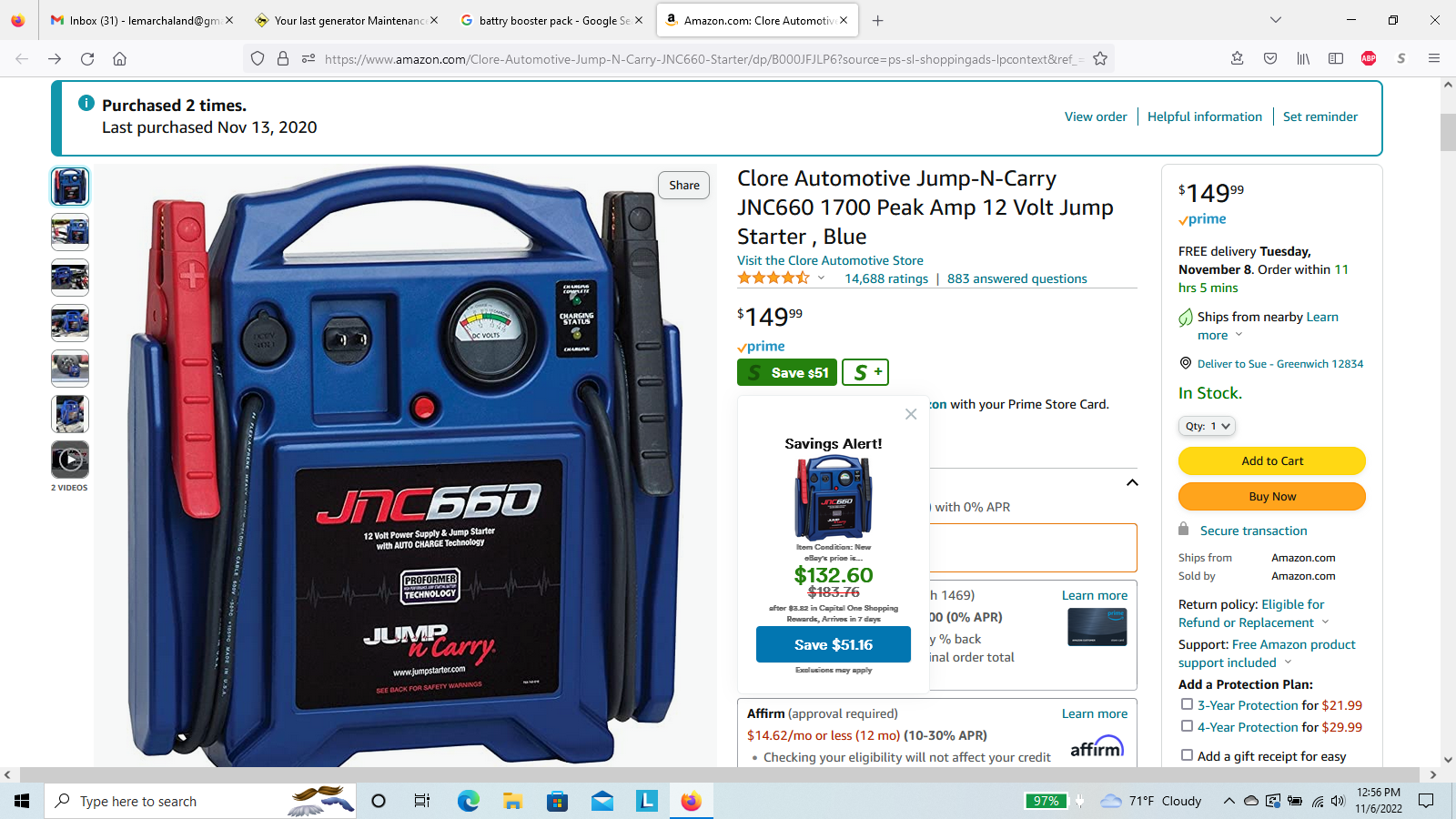

A boost pak at the ready is very handy,
we have a couple of these,
My next one is likely to be similar to this, more battery and usb which would be handy at times,

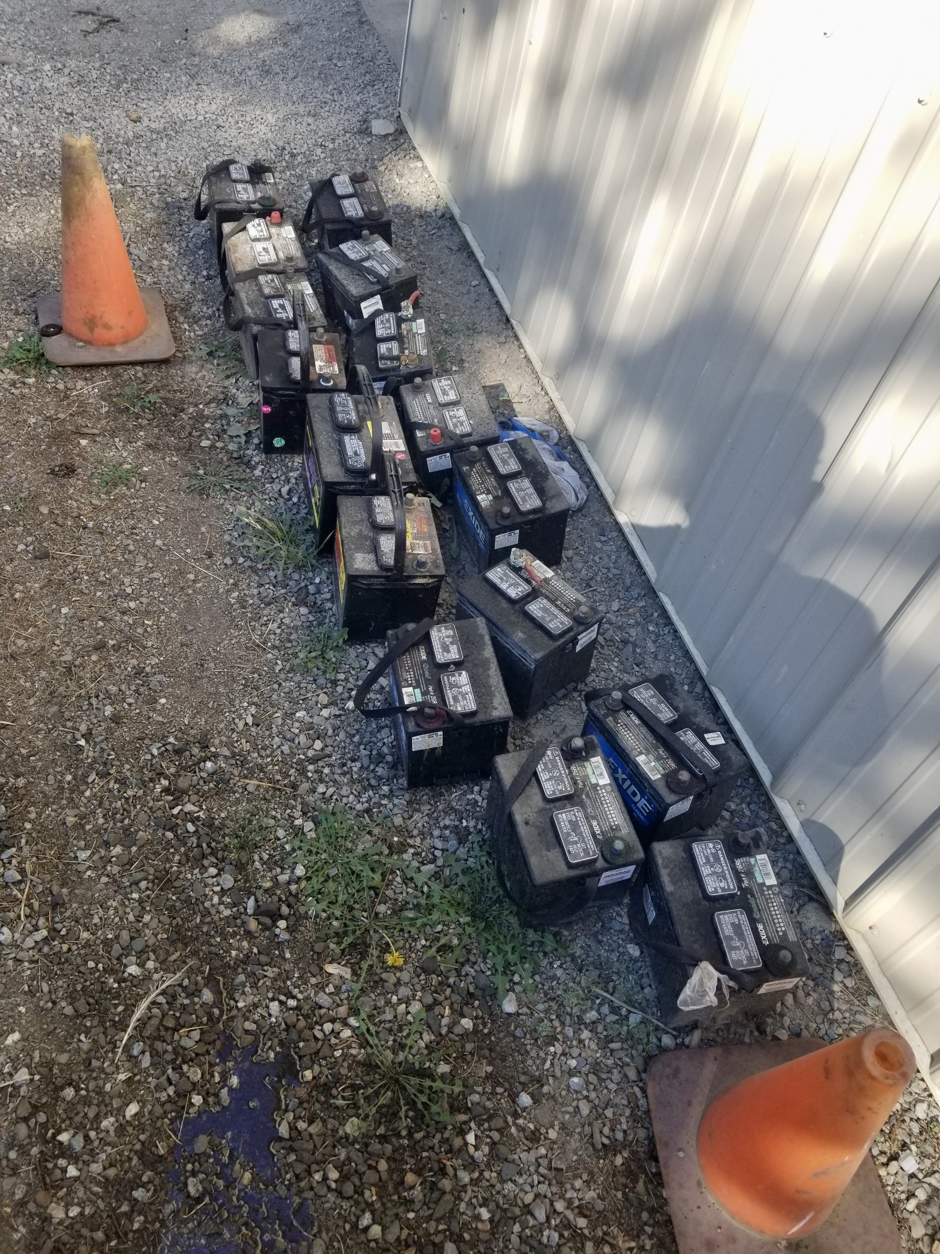

I change batteries in standbys every 5 years, unless homeowner denies the request. Mind you, i tell them if it doesnt start during next power outage, dont call me (im serious….i do).
i get 10 batteries at a time thru Exide, so i always have them available. I try to keep them fresh, so i dont want more than 10 per delivery.
but sometimes i get tired of handling the cores.

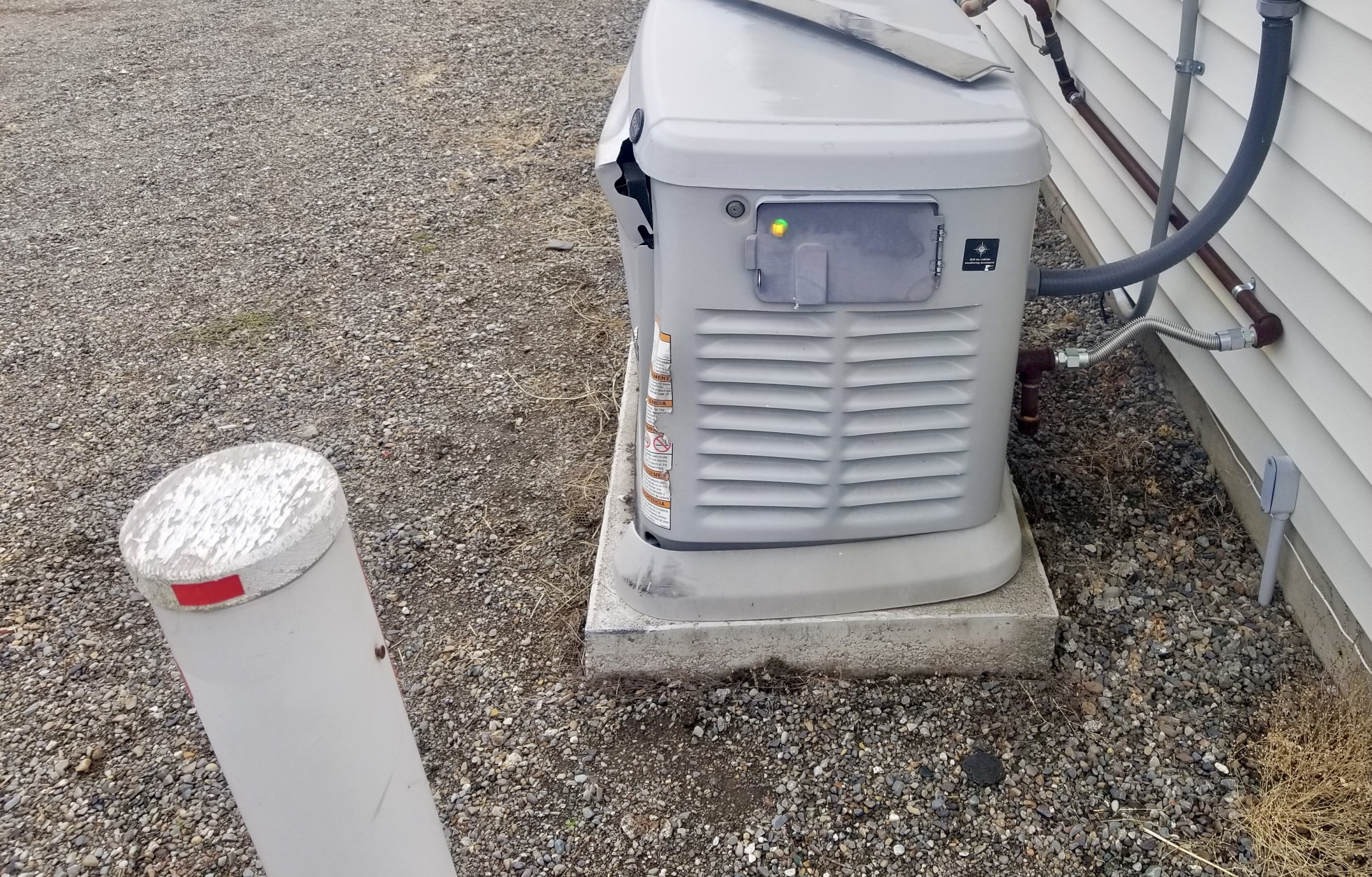

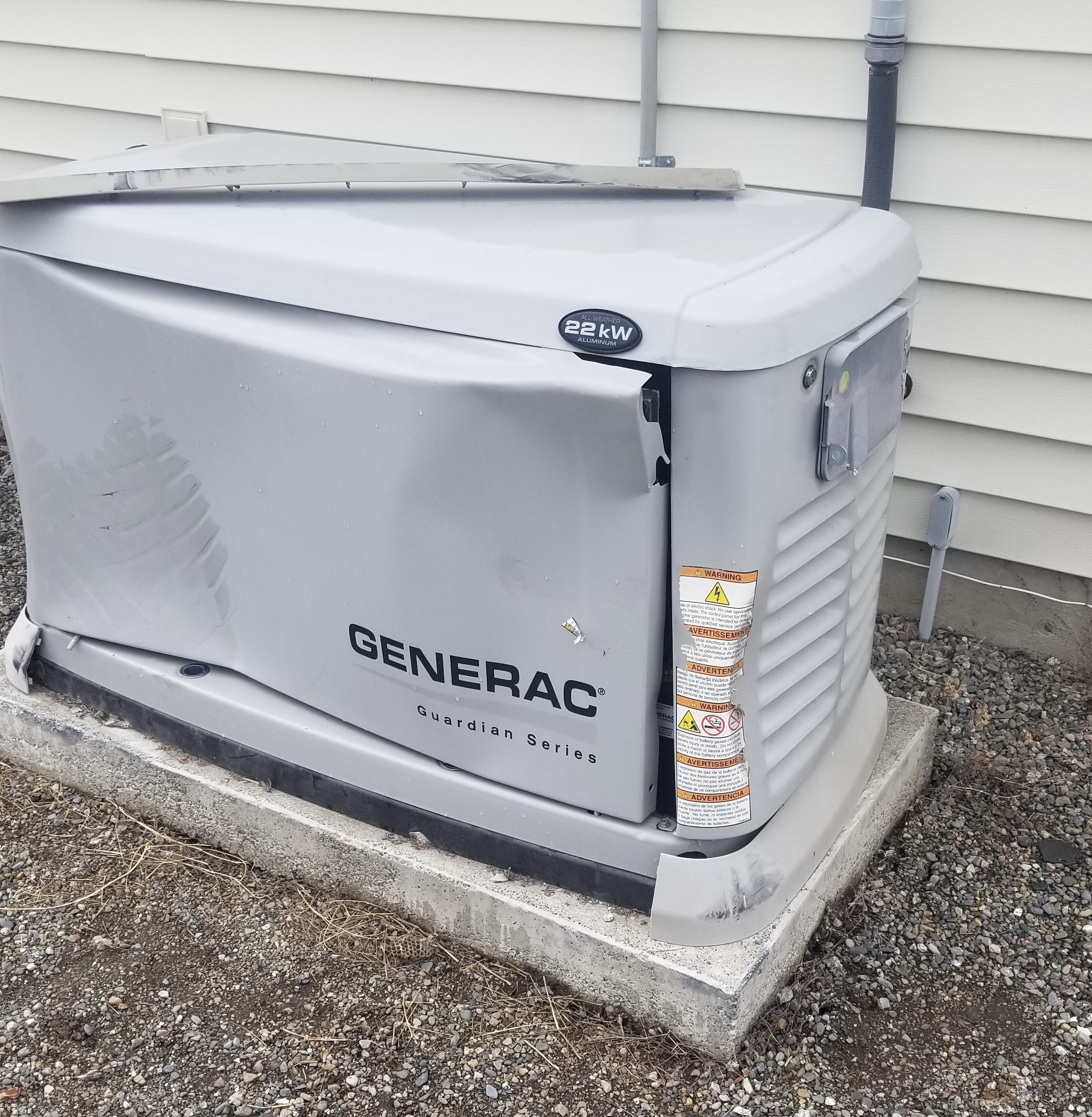

even though your gen had trouble starting, you still had a better day than this guy. Edit: this customer had his generator hit by car that made it around steep barrier.
Gen still runs. Needs new enclosure.
