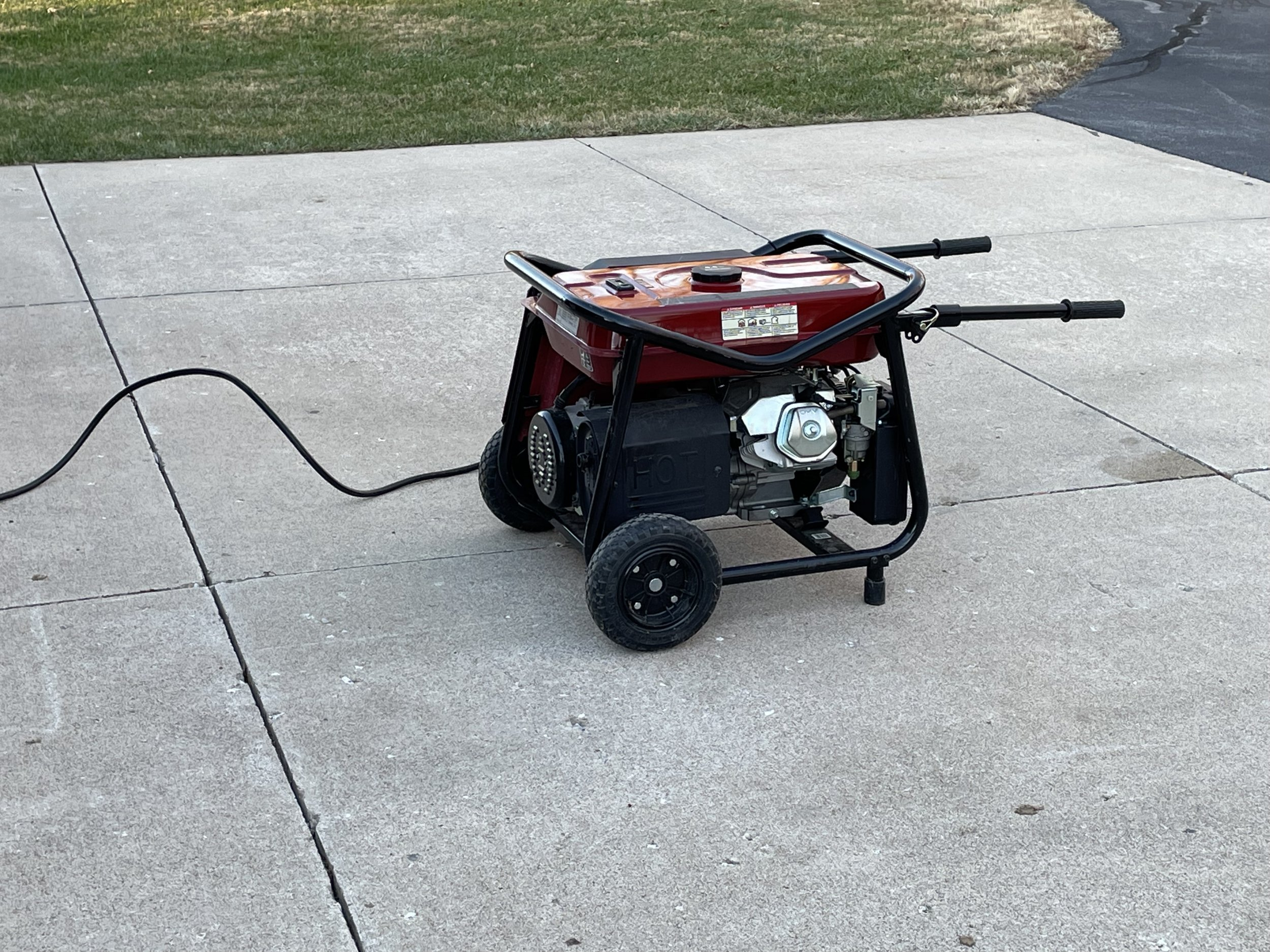

I ran mine about a half hour today.

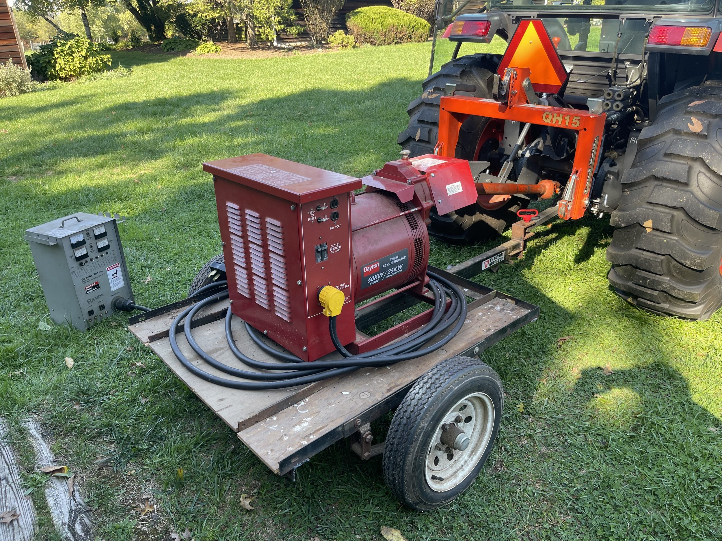

This was actually back in October, I pulled out the PTO generator and ran it on the load bank for a while to keep up the residual magnetism. It’s the backup to a Generac 22KW propane standby, and doesn’t get much use.
Is there a general rule of thumb to how frequently one should run a pto powered generator to maintain the residual magnetism? I guess for any generator?
I switched over to a pto generator several years ago, and since there is no engine to exercise, I haven't run it in maybe two years.
   / Your last generator Maintenance Run #5,947
Not really, there are too many variables, the main one being the mass of the pole pieces. 4 pole designs seem to do better than two pole, but they tend to be beefier all around.
Many of them actually have external terminals to excite the field, making it easy, if you need to do it. Often you can plug a drill in and spin the chuck to bring one to life.
I like to spin it up with the tractor, keeps the gearbox limber as well.
   / Your last generator Maintenance Run #5,948
I'll read up on the drill thing. Looking at the manual, it says to "back flash the 120v circuit with 12v". I can come up with 12 volts, but where would I apply the 12 volts?
I really need to run the generator anyway, as it only has a few hours on it and I like to change out new gearbox oil after 5-10 hours.
Interesting question..... w/o dedicated terminals, I wouldn't want to speculate on somebody else's machine..... we'll see what the brain-trust comes up with....
