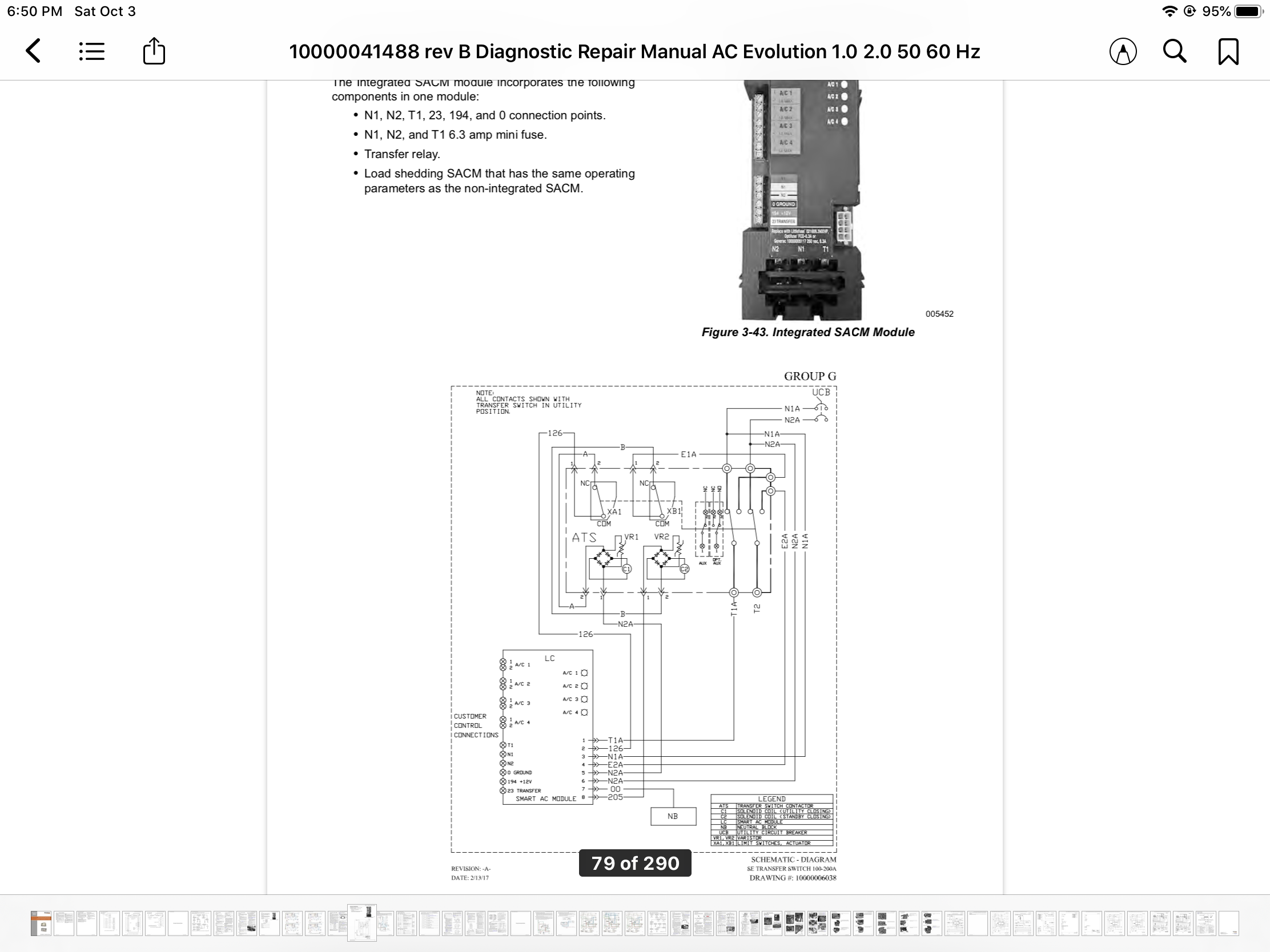

agree. thats what im asking above. if hes not getting 12V+ then the trouble is in the expensive controller. was hoping its in the cheaper board. problem with generac is they dont have any reference material available to troubleshoot circuitry within a board or a controller. there have been people repairing a defective controller, but thats way beyond my pay grade. one thing about servicing these units in person, i have nearly every part on my truck, so i can try different parts to help track down any issues. hard to do on a online chat.
I do have a question about the Generac transfer switch. Studying it, I see that there is a diode bridge in both of the transfer coils. What is the advantage or reason for using DC coils rather than AC. IMG_4943.jpg
You can see that my switch has an extra part and doesn’t use all the connections.
   / Your last generator Maintenance Run #4,346
There not dc coils. There 240 VAC coils.
   / Your last generator Maintenance Run #4,347

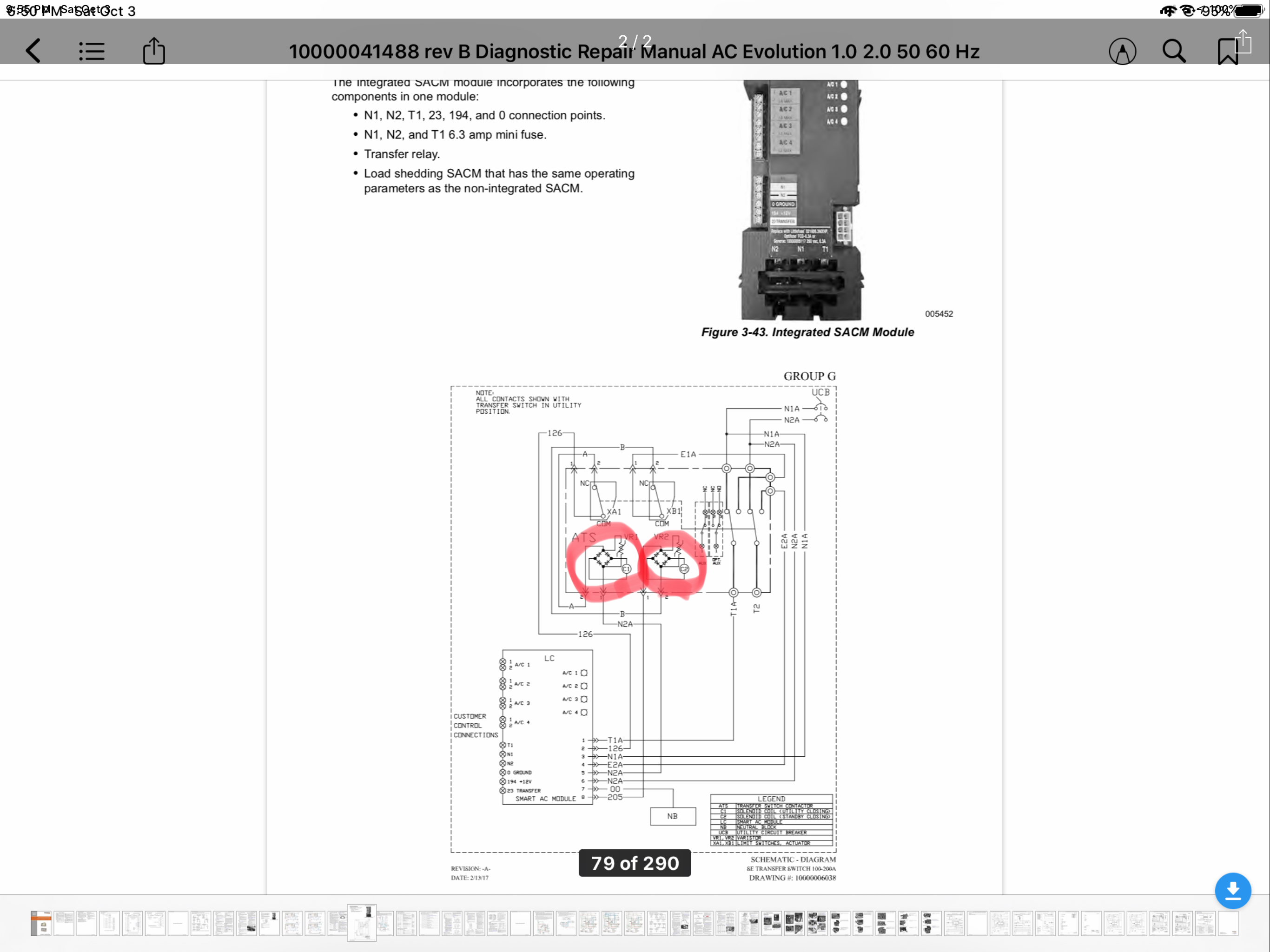

They are definitely fed 240VAC, but I’m pretty sure that I saw a schematic showing a full wave bridge feeding them, possibly imbedded in the coils themselves.
Again, I could be wrong, but pretty sure that’s what I came across.
I really wish that Generac provided better documentation, especially schematics.
   / Your last generator Maintenance Run #4,348
D24D8232-1C4E-42FF-B8BB-A29D75568682.png only one i know of
   / Your last generator Maintenance Run #4,349
That was the one that I saw, it shows two full wave bridges, one for each coil.
