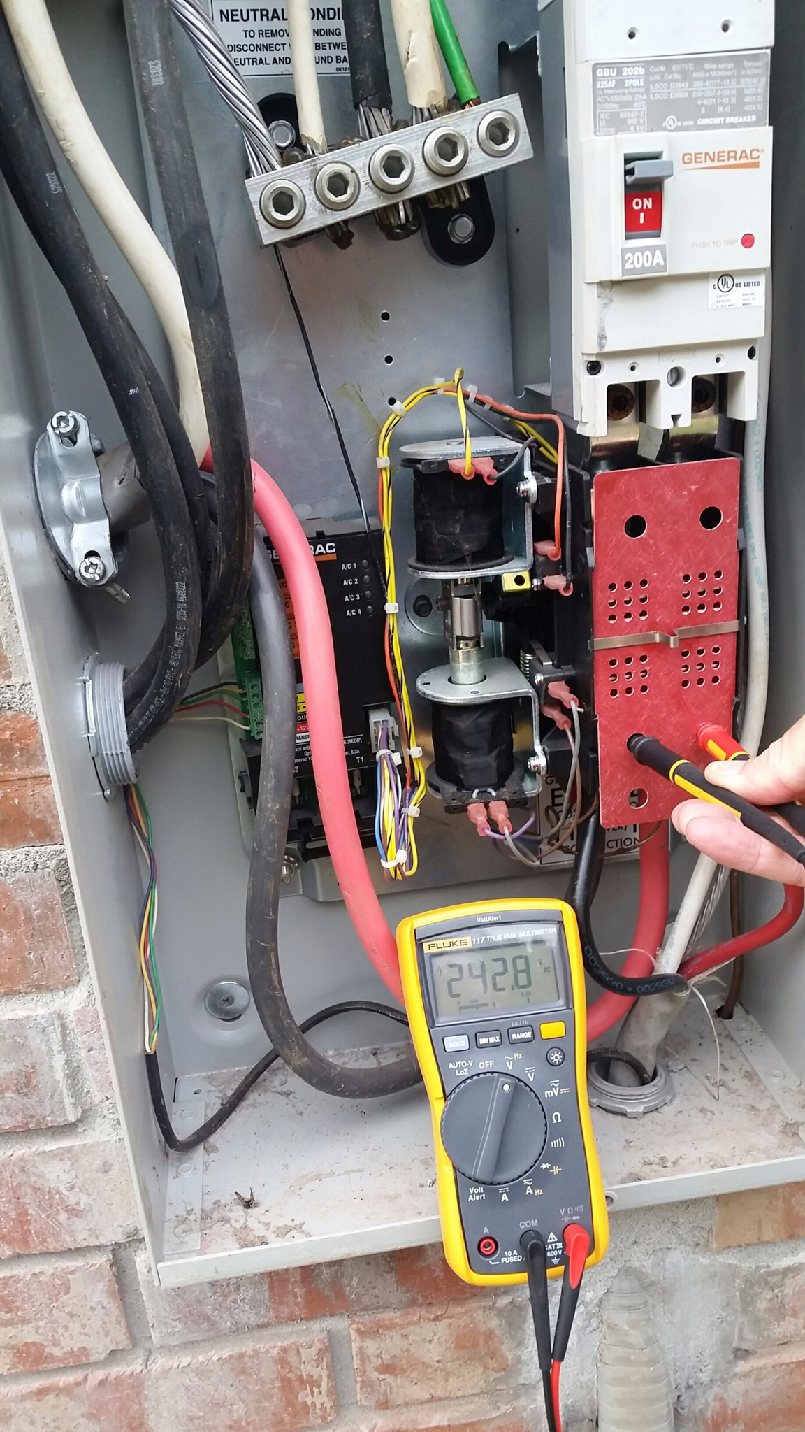

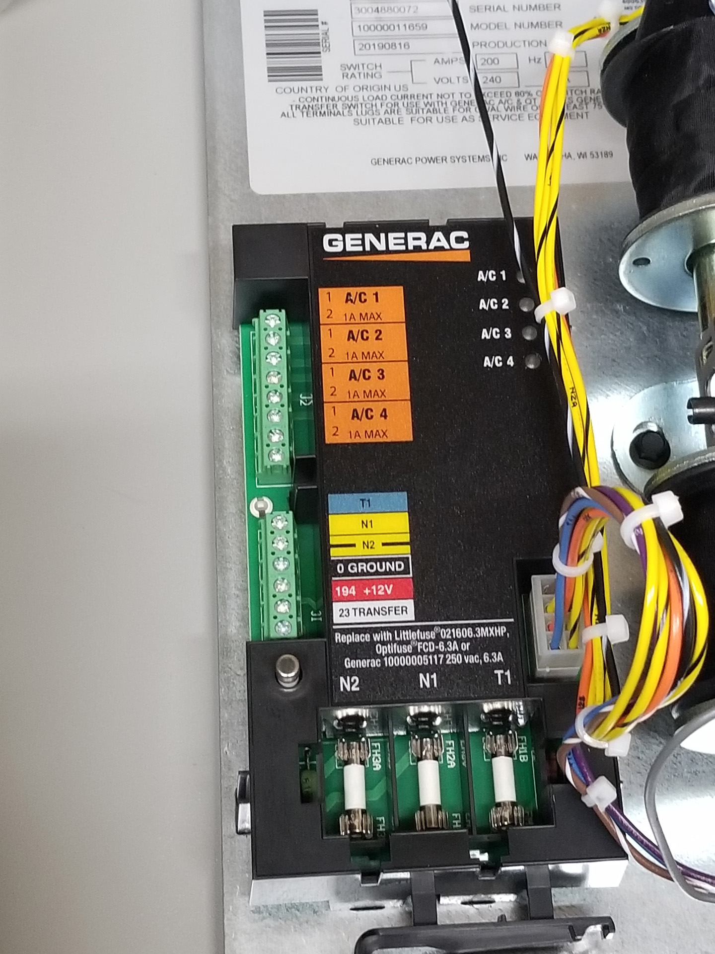

The next step is yo get a trusty electric test meter and check if you have 240 at the transfer switch when the generator is running. You place your test leads on the two wires clostest to the front, lower end of the Transfer mechanism. There labeled E1 and E2 on the diagram
I checked, we have rain coming tonight and in the morning. 242 VAC
No trouble lights before during or after running the genny.
Thanks again!!

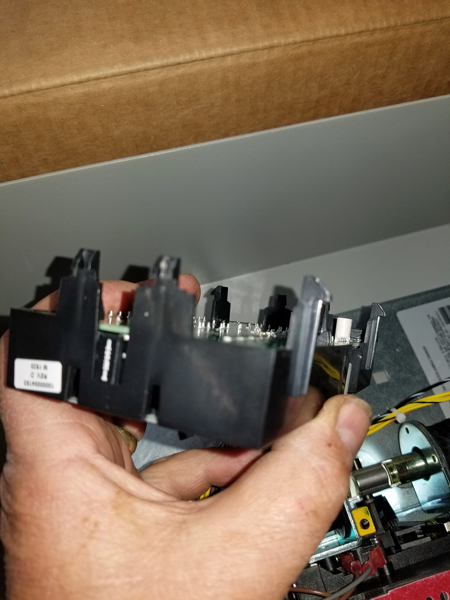

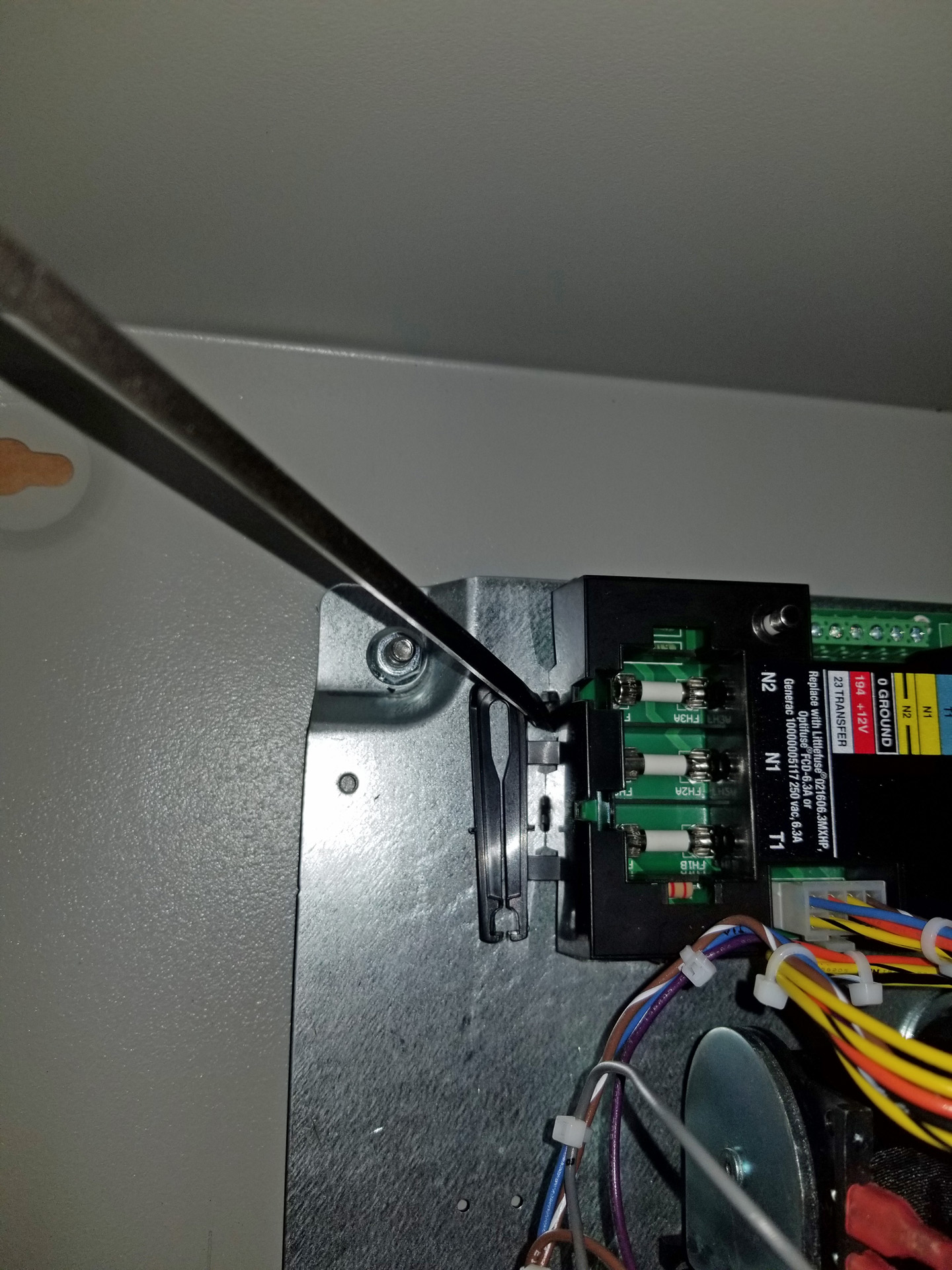

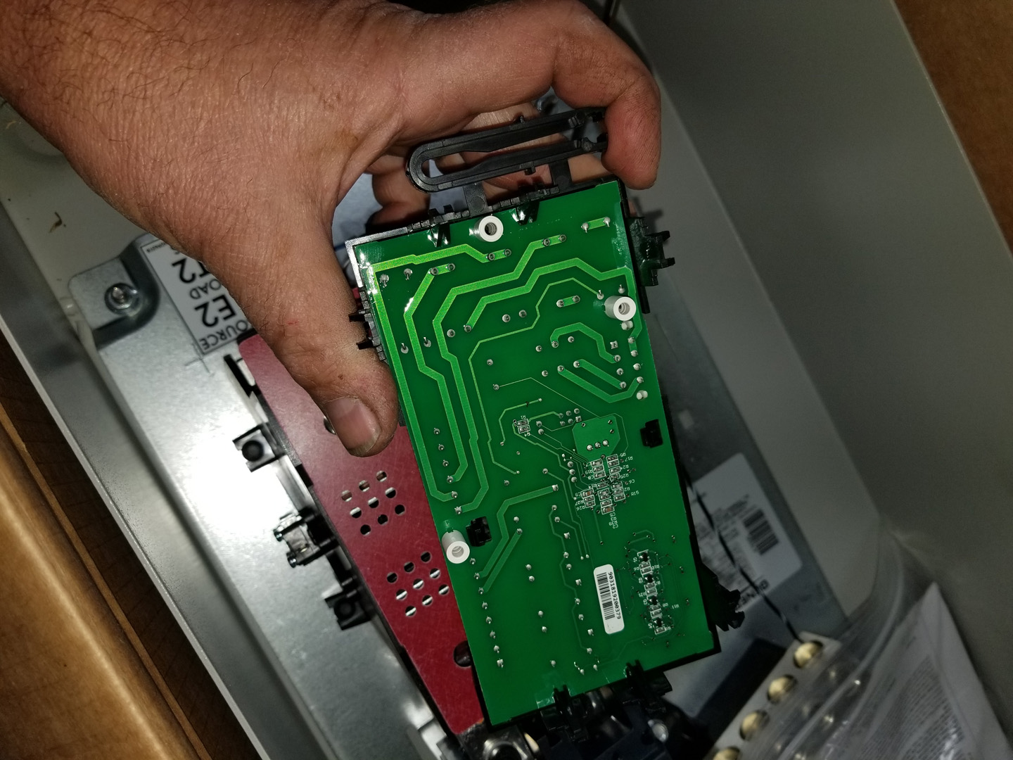

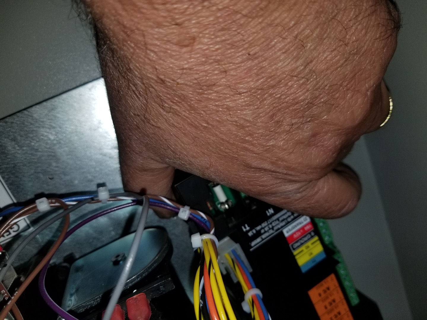

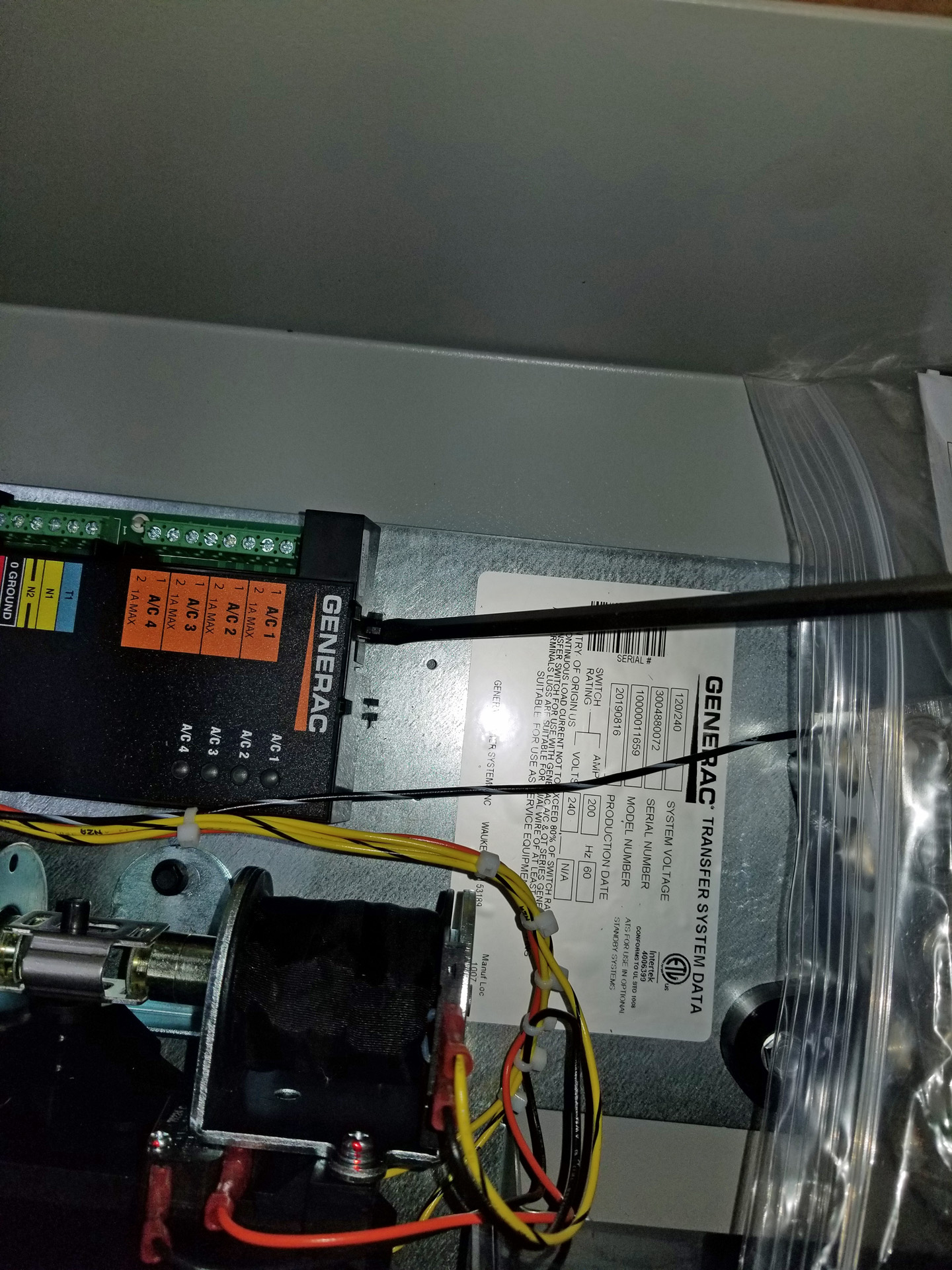

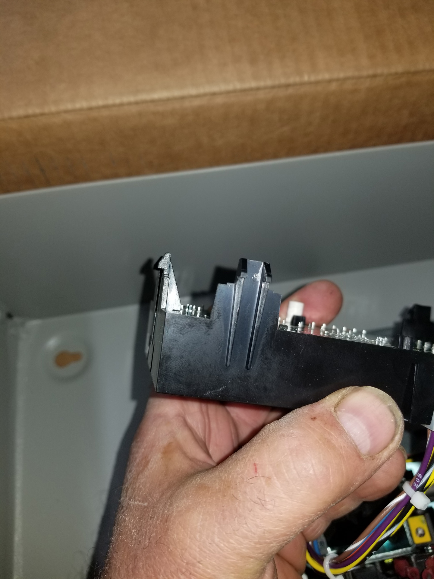

those lights should be on. First thing to check are the fuses, especially the t1 fuae. make shue you have 120 v to ground. If its good, then i have seen a few of the original series of this upgraded switch where the circuit board under the black control board that says generac and ac1-4 has been shorted out. in the original series, the did not have standoffs on the board and a rough installer could ground the circuit board out. newer versions have plastic stand offs. you may need to check that circuit board. to do that you need to shut off generator and totally shut off power to the house. this is to protect yourself from incoming utility power. then you can unhook the entire black colored controller from the clip mounts and pull it out. itsd kind of a pain in butt to get out. first unhook plastic molex connector sw1.jpg. the connector is the 8 plug bunch of wires on the lower right . it simply push side retainer clip and unplug. (i didnt do it in pictures because this switch is not hooked into power, its from a box) then use a screwdriver to pop the clips on top and bottom sw2.jpg sw2a.jpg. the real pain is popping the top and bottom clips while slightly lifting and then pressing the side clips with thumb sw3.jpg. these next 2 pictures show the clips themselves. dont force it out. sw4.jpg sw5.jpg . the fact that the 4 lights are not lit lends me to think that this board is fried. it controls the transfer switch itself. heres a picture of what it should look like sw6.jpg. sw7.jpg

those functions are now handeled thru this black controller that i photographed. first thing to do is make sure that the unit is not fried. if its not damaged, then we need to start checking the individual wires. i have seen several of these boards fried from improper installation due partially to factory crappy design of the older boards. you had to be very, very careful landing the 6 control wires or you could press the board into the steel enclosure. the new standoffs prevent that from happening. ill have to wait till i see the pictures of his board. that board part number is 0L3123 and is about a $70 part. depending of the actual install date of the generator, it may be under warranty. generac has different warranty periods, some are 3 year, some are 5 year some are 7 year and some are 10 years. depends on promotion or optional warranty.
lets put it this way, i have 3 of those boards in stock. like i say, i see it enough to warrant 3 in stock.

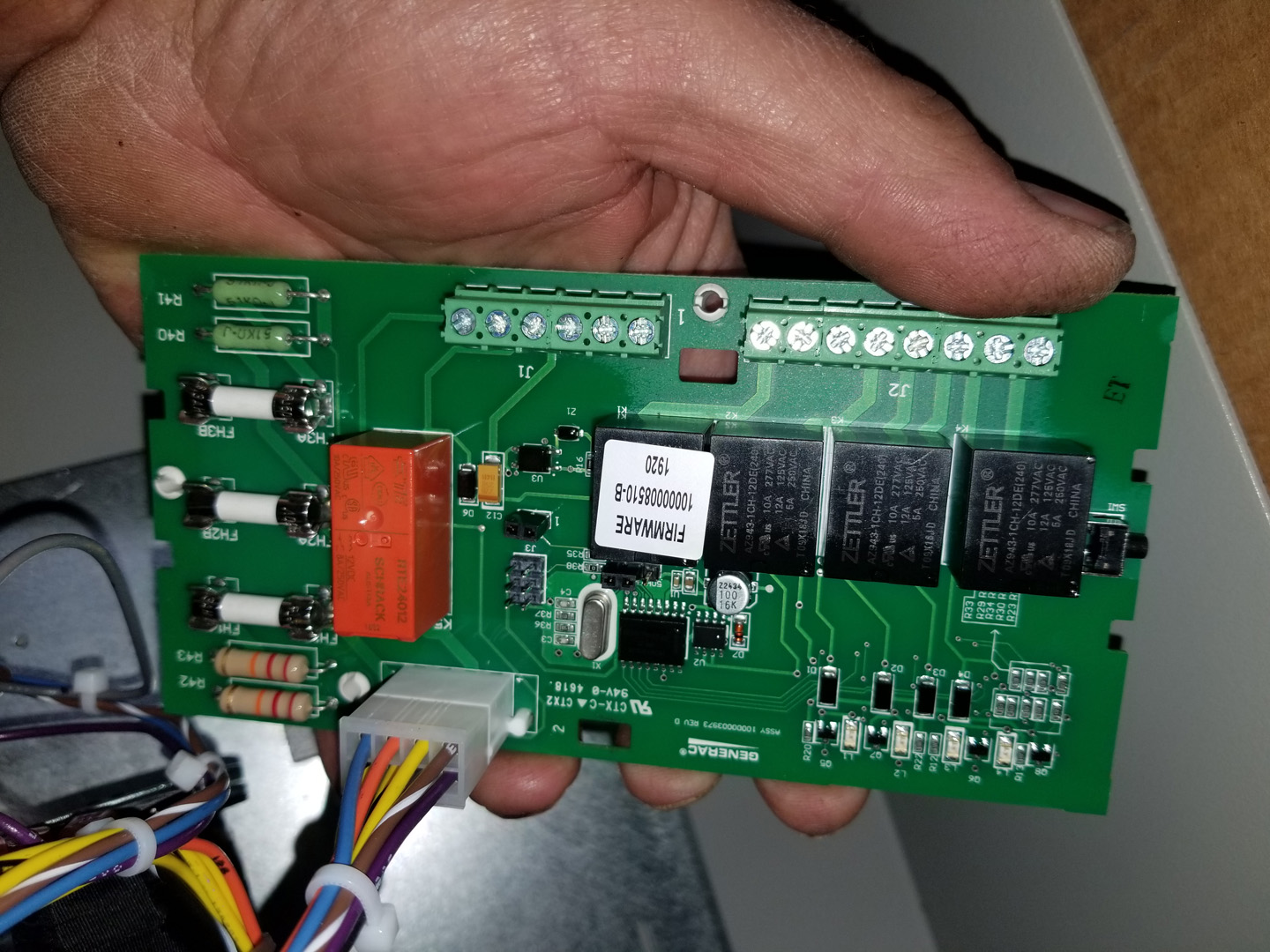

Looking at the schematic, there’s not much on that board that impacts the transfer. The pink relay is the transfer relay, the diodes that rectify the current for the transfer coils are the only solid state devices in the circuit. The other four relays and logic chip is for the load shed functions.
Of course it’s certainly possible for a trace for the relay is burnt off the board, but hopefully unlikely.

the fact that the 4 leds are not lit, when they should be, tells me something is wrong with the board. it wonts affect generator start up when power fails because that is handled in generator controller itself within the generator. but if this board is fried, it wont send signal to the transfer mechanism itself.
