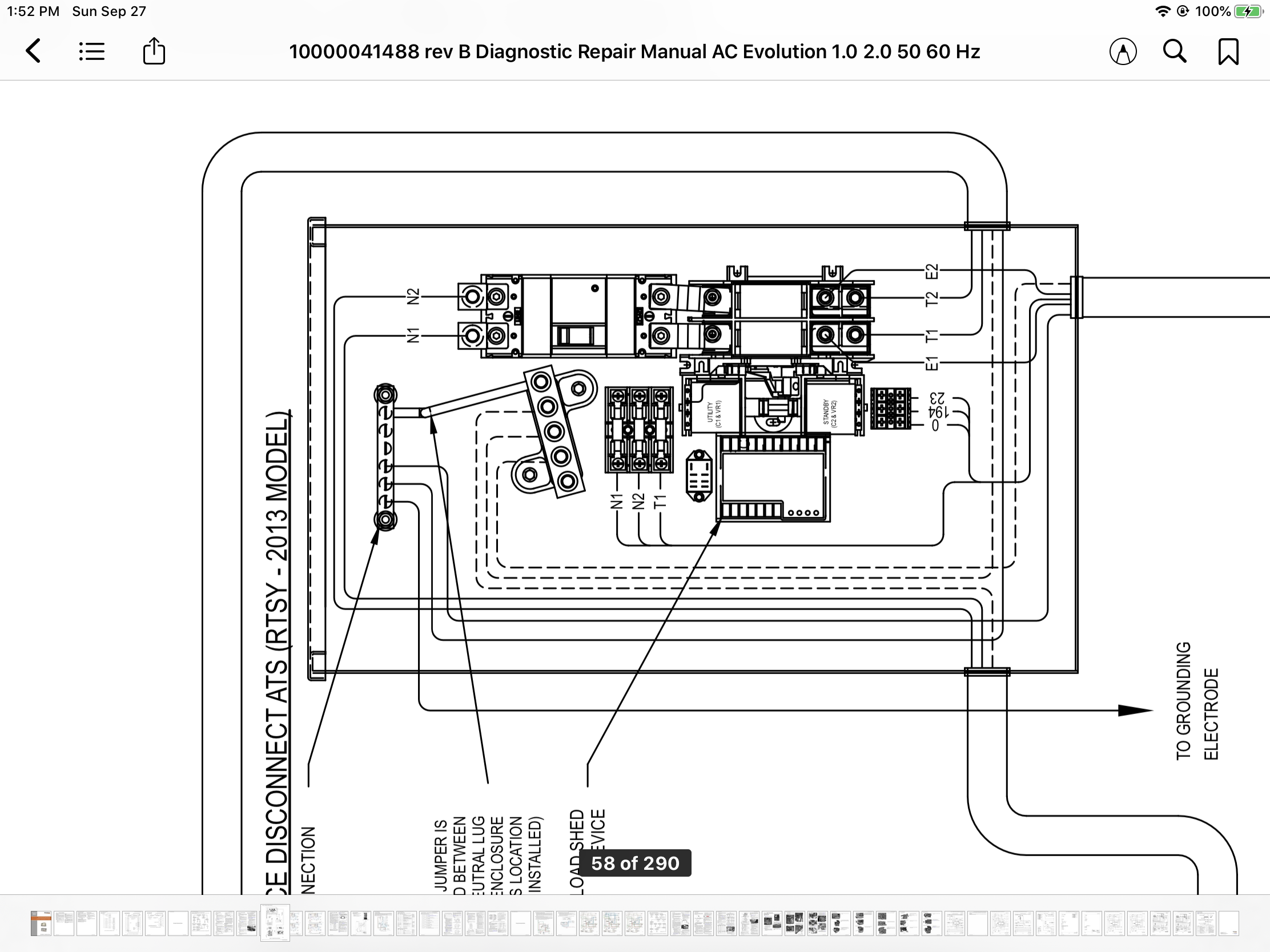

The next step is yo get a trusty electric test meter and check if you have 240 at the transfer switch when the generator is running. You place your test leads on the two wires clostest to the front, lower end of the Transfer mechanism. There labeled E1 and E2 on the diagram. You dont need to turn off the house power, just start generator. Make sure the 100 amp breaker on the generator itself is turned on. 98C27977-E12E-4701-8A4B-10A9496757E7.png
   / Your last generator Maintenance Run #4,318
The next step is yo get a trusty electric test meter and check if you have 240 at the transfer switch when the generator is running. You place your test leads on the two wires clostest to the front, lower end of the Transfer mechanism. There labeled E1 and E2 on the diagram. You dont need to turn off the house power, just start generator. Make sure the 100 amp breaker on the generator itself is turned on. View attachment 671091 also, can you post a photo of the inside of your transfer switch, under the cover, so i can check wiring
I took a photo earlier, just in case. I’ll check for voltage in the morning. Do the AC1-AC4 lights only come on in a diagnostic mode? They’re unlit. IMG_1196.JPG
Dave, we’re good. I’m a lifelong low voltage tech.
