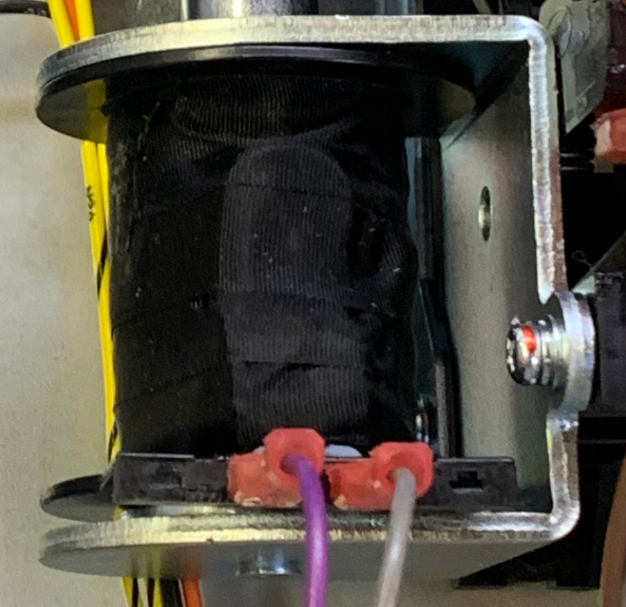

Just to make it more puzzling it appears that rectifier and varistor is integral to the coil, notice the 斗ump in the wrap. View attachment 671983
Just cost-effective packaging ?
You get to delete a separate pcb, and stabilizing bulky (compared to flakes-of-pepper SMD) components long-term in a vibration environment takes a bit more effort than it first seems it should.
Rgds, D.

Much like my 200 amp ASCO switch. Emergency power drives solenoid to switch over main contacts. Switch is unable to operate in the absense of Utility or Emergency Power. Like, no back up battery supply or nothing. I haven't a clue if the coils are AC or DC.
Sill doesn't explain the bridge rect.

Agreed that you only need a 12VDC input to operate the transfer relay which closes the circuit through the limit switch from the 240VAC source to the coil. My question is why did Generac decide to rectify that and operate the coils with DC.

What's doing the switching in the controller? It's easier (on contacts) to switch AC then DC.
FWIW, I only installed one Generac propane run system, as a favour for a custoer at his cottage and that transfer switch apparently destroyed itself during a brownout. Maybe, that has something to do with it. I gather it operated back and forth until it failed. That was ten years ago and the equipment was used, older than that. Maybe a fix for that?
