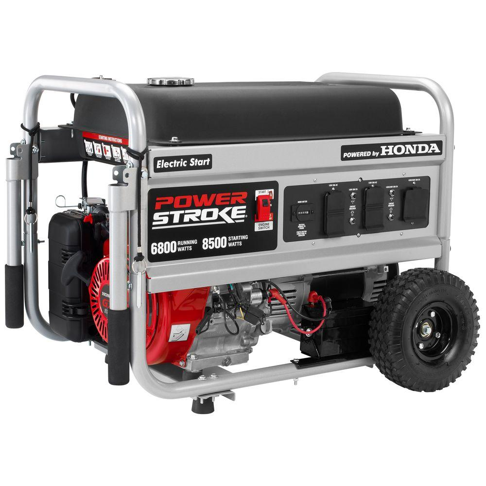

Did you do your own propane conversion? My portable genny is the ubiquitous PowerStroke 6800 with Honda GX engine, that I see all over, I guess they're pretty popular. But they're gas only from the factory, and the propane conversion kit I found for them back when I bought new involved cutting the frame. Some folks reported issues with that, as it really weakens the thing, with regard to travel if you load it onto a truck or trailer, or tote it around on the back of a tractor.
If anyone knows of a better propane conversion kit, I'd be interested. We have propane in our garage already, feeding a space heater, so it wouldn't be hard to tee in another line on a quick disconnect fitting for feeding the generator when back-feeding the house.

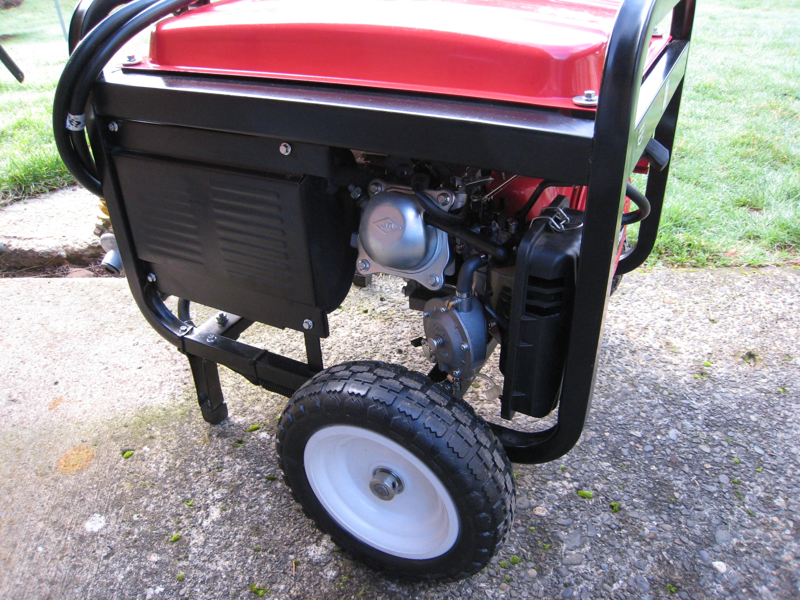

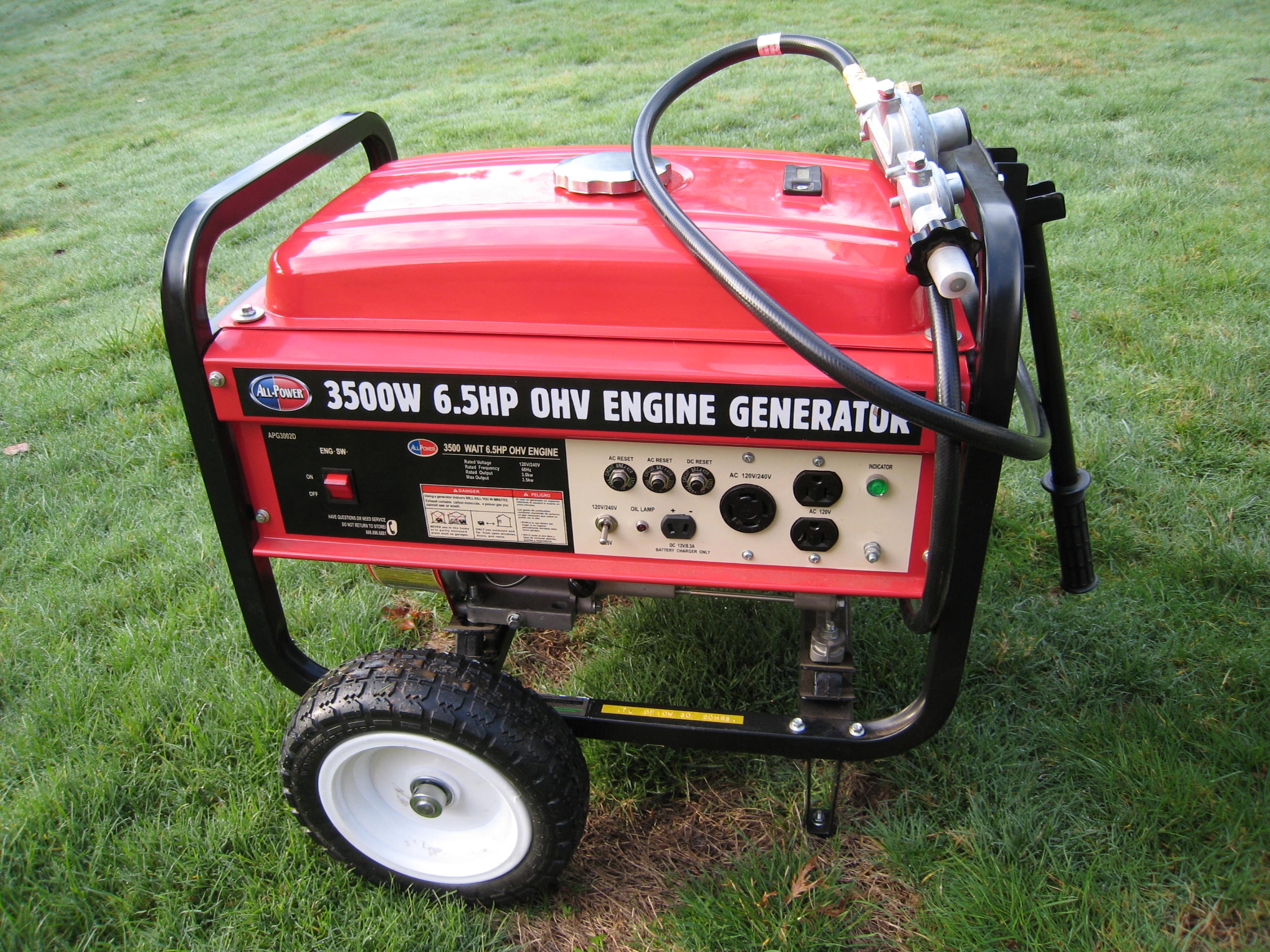

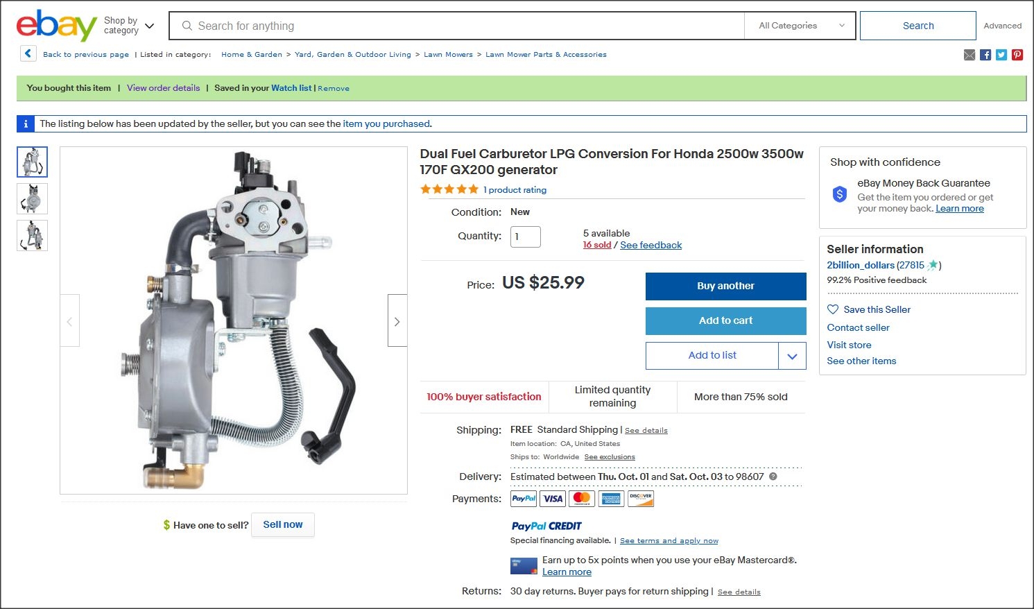

I put one of these into a cheap open frame 3500 W few years ago, but your generator is twice as big...
I've decided to keep this for now as a second backup, in case my dual fuel inverter generator should fail for some reason.
It's worth checking what's available on eBay etc.
Thanks for posting that.
Cost on those kits is low (esp. in the US).... I've considering trying one on my little gen.... it's more just the time, than $ that has stopped me. As a portable option, I'm liking on propane for small gens; my choice would be 30# tanks - decent runtime, and still easy to move around.
