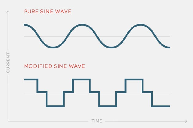

yeah, you want a pure sine wave inverter, not a modified sine wave.
A lot of UPS put out a modified sine wave, that's junk!
Modified is what my 1990 inverter is and it runs all my power tools and light boom but it will not run a Mikita or Dewalt cordless tool battery charger.

They are generally not modified sine wave. I haven't seen a modified inverter generator sine wave, most have THD below 3%
Exactly. "Pure sine wave" is pure marketing bullsh*t. There is no such thing, other than in theory. Check the THD spec, that's the proper metric.

I know that many inverter generators and power supplies advertise pure sine wave power. I have not stayed on top of the latest and greatest power systems but I know of no way to get pure sine wave except from a rotating field any "solid state" device is going to be a modified sine wave it may have enough steps and buffering to be almost indistinguishable from a true sine wave but it is still a modified sine wave.
/ Your last generator Maintenance Run #6,851
true, I've not come across an actual standard, just marketing....
  • "Clean Power" or a "Pure Sine Wave" is considered to be power with a THD or less than 6%
And like you said, the real goal is <3% THD
My previous generator THD spec was 25% the new one is <3%

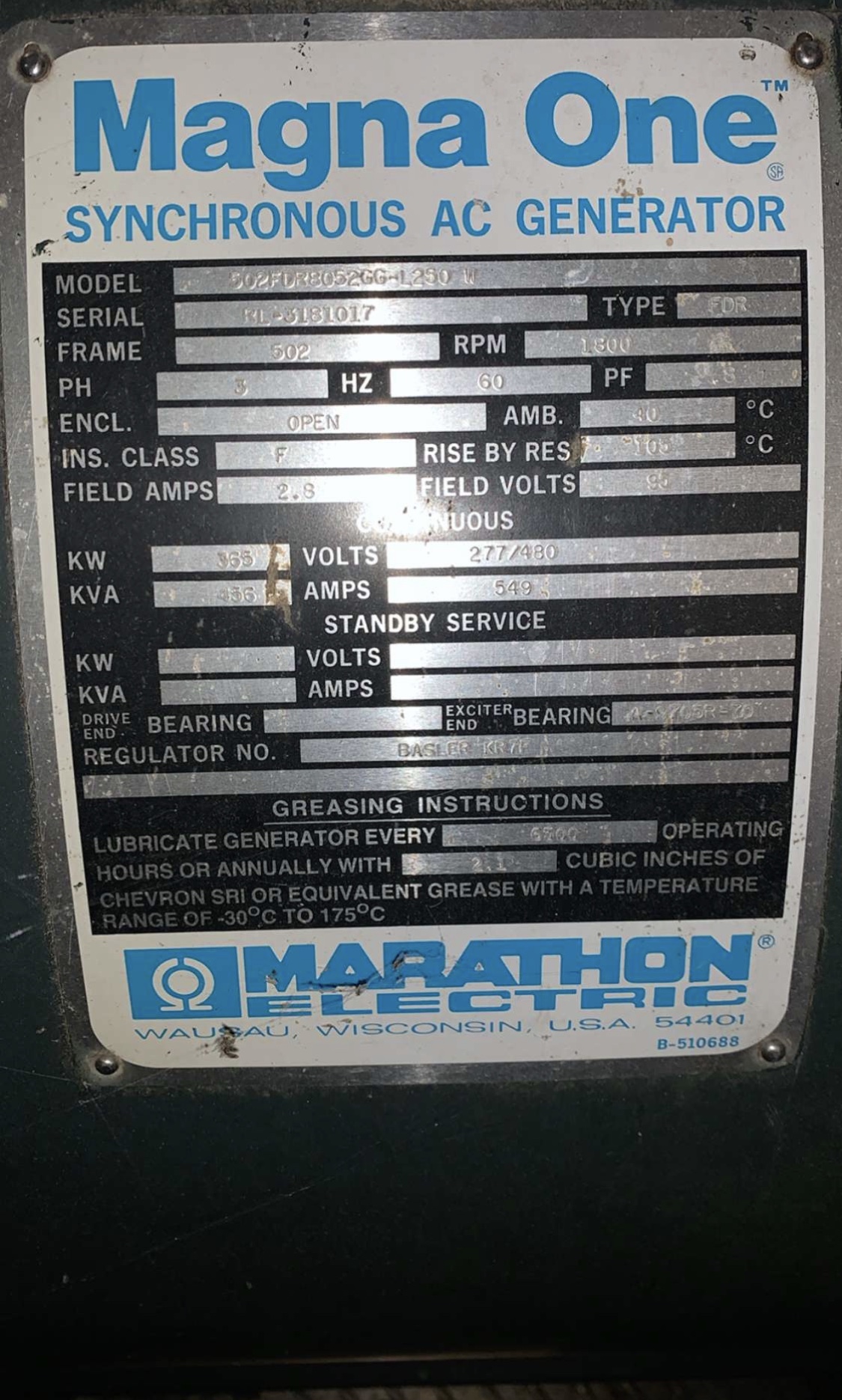

Someone recently posted that re-purposed Municipal surplus generator they installed to support a commercial machine shop - there ^, you don't have much choice, but most of us, most of the time, have just relatively light loads to support @ home - when in Survival Mode.....
